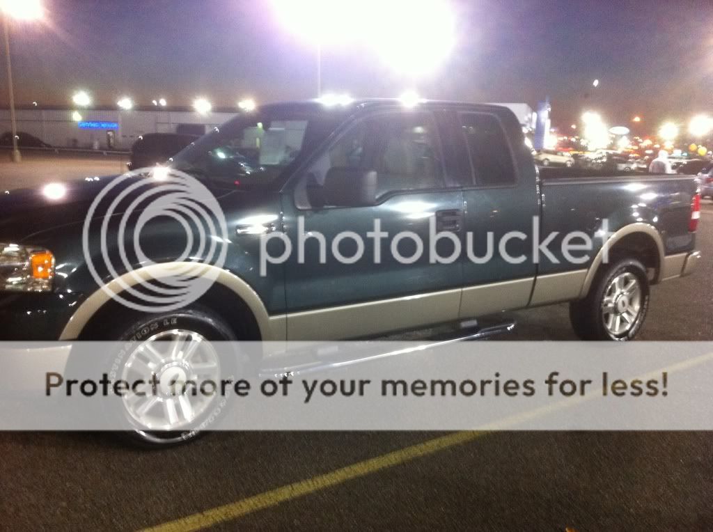

Well my girlfriend Cati got her first vehicle today. Got her out of that ole s10.
I didn't buy it but I was there.
2004 f150 lariat ext cab 4 door. 5.4 triton 3 valve. Auto. 2wd. 3.55 gears. It's clean.
Runs great. Drives great.
My Bronco 2
Yeah I'm slightly jealous. I drove it a good bit today. Think I made my b2 a little jealous...

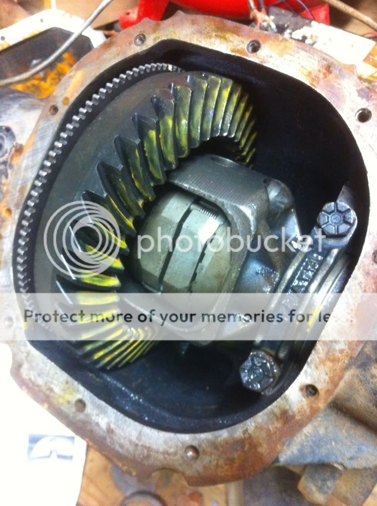

8.8 geared. all specs are perfect.
aussie locker in.
cross pin won't go in b/c of the thicker ring gear. gonna do a small amount of grinding in the morning.
My Bronco 2
after grinding and getting the cross pin in; it's time to CLEAN CLEAN CLEAN.. and then go from there. i'm making process now tho!
It won't take much grinding on the topside of one tooth on the inner portion closest to the locker....only took a hair off on mine to get the pin in.
