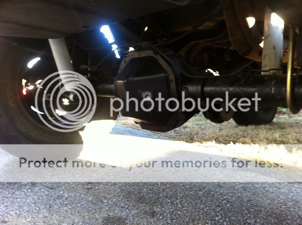

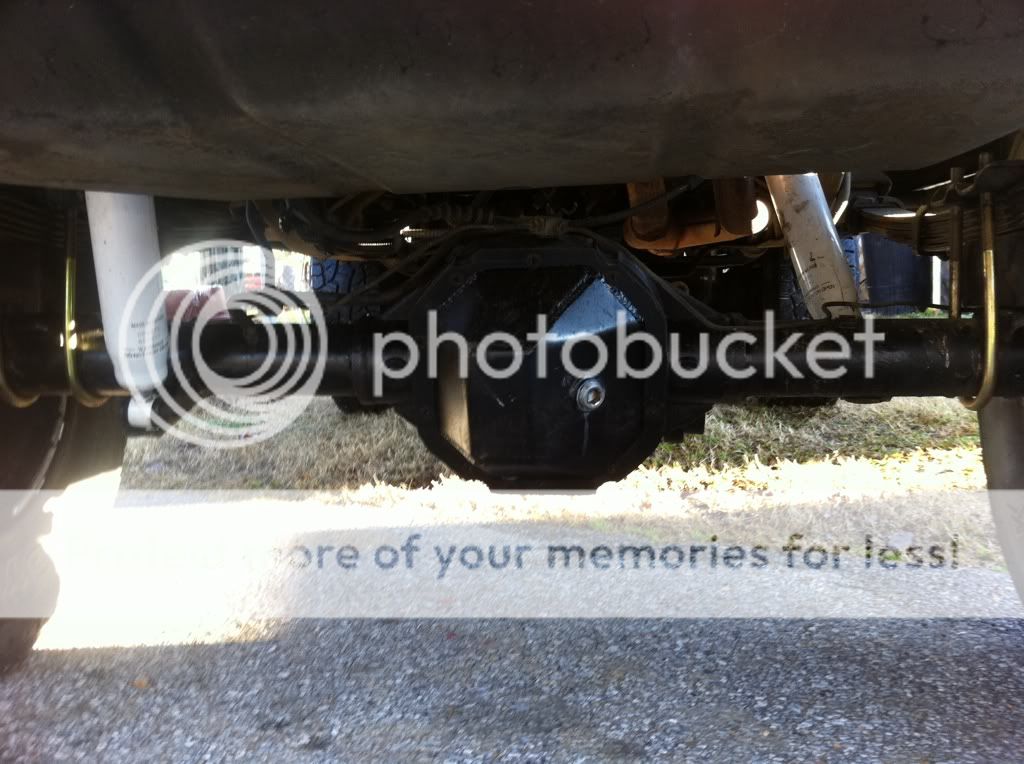

hard to tell in the pics...but did you weld up the tubes too?
Anybody notice the gap on the bottom passenger side u-bolt and the axle tube? The ubolt isnt holding anything at all. That creating axle wrap and probably your problem. Need to tighten the ubolts down more.
Agreed. You need to be real careful with the auto parts store u-bolts and aluminum blocks. I went through 3 sets of ubolts and 2 sets of blocks because they are crap.

That's all RC stuff. My new ubolts are on the way. This is mentioned earlier in the thread. Lol.
