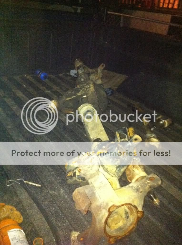

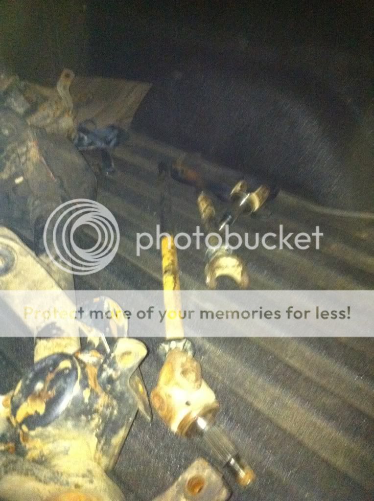

My Bronco 2
dirty... but its a HP d30
with TJ shafts. so 297x joints.
idk what gears are in it tho! lol

nice start on a parts pile.....:icon_thumby:
