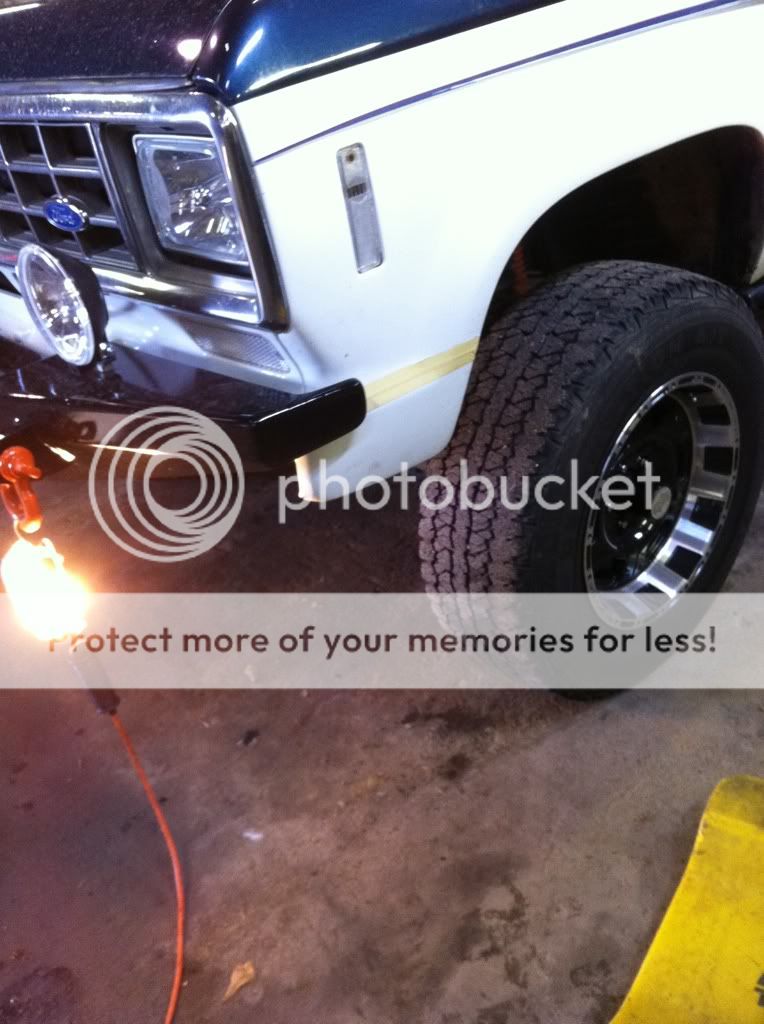

as far as the fenders cut-- they are a straight cut on the body line (it actually angles up slightly towards the rear).
see the tape? i cut at the bottom of that tape with just a cut off wheel, cut the inner just a little higher. BUT I LEFT THE TABS THAT THE FRONT PIECE BOLTS ON WITH. and then drilled a 1/4 inch hole in the lip of the wheel well in the metal and inner fender and put a 1/4 inch rivet it in.
this picture is kinda showing how i cut it, but i followed the body line a little above the orange line in that pic
