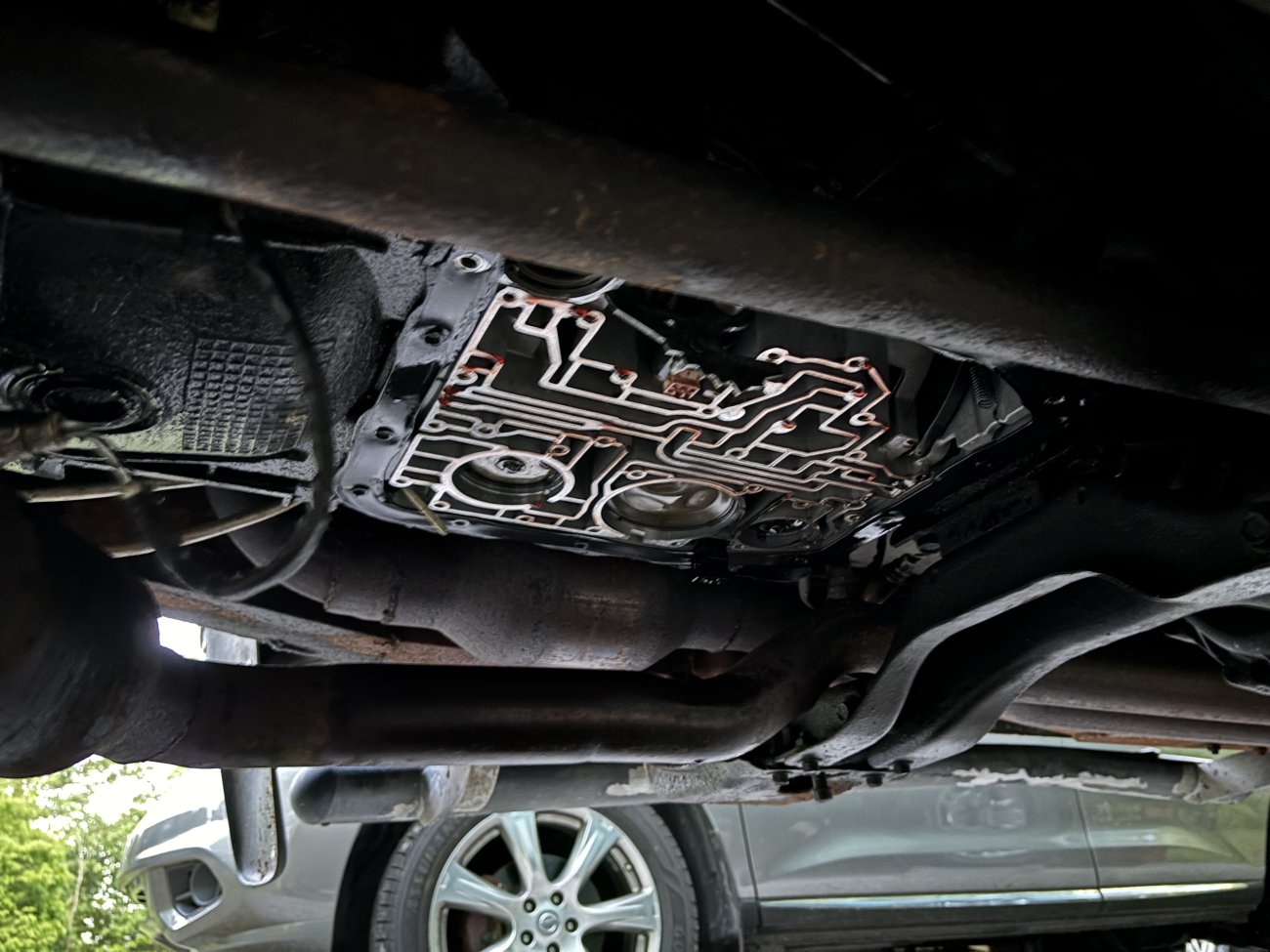

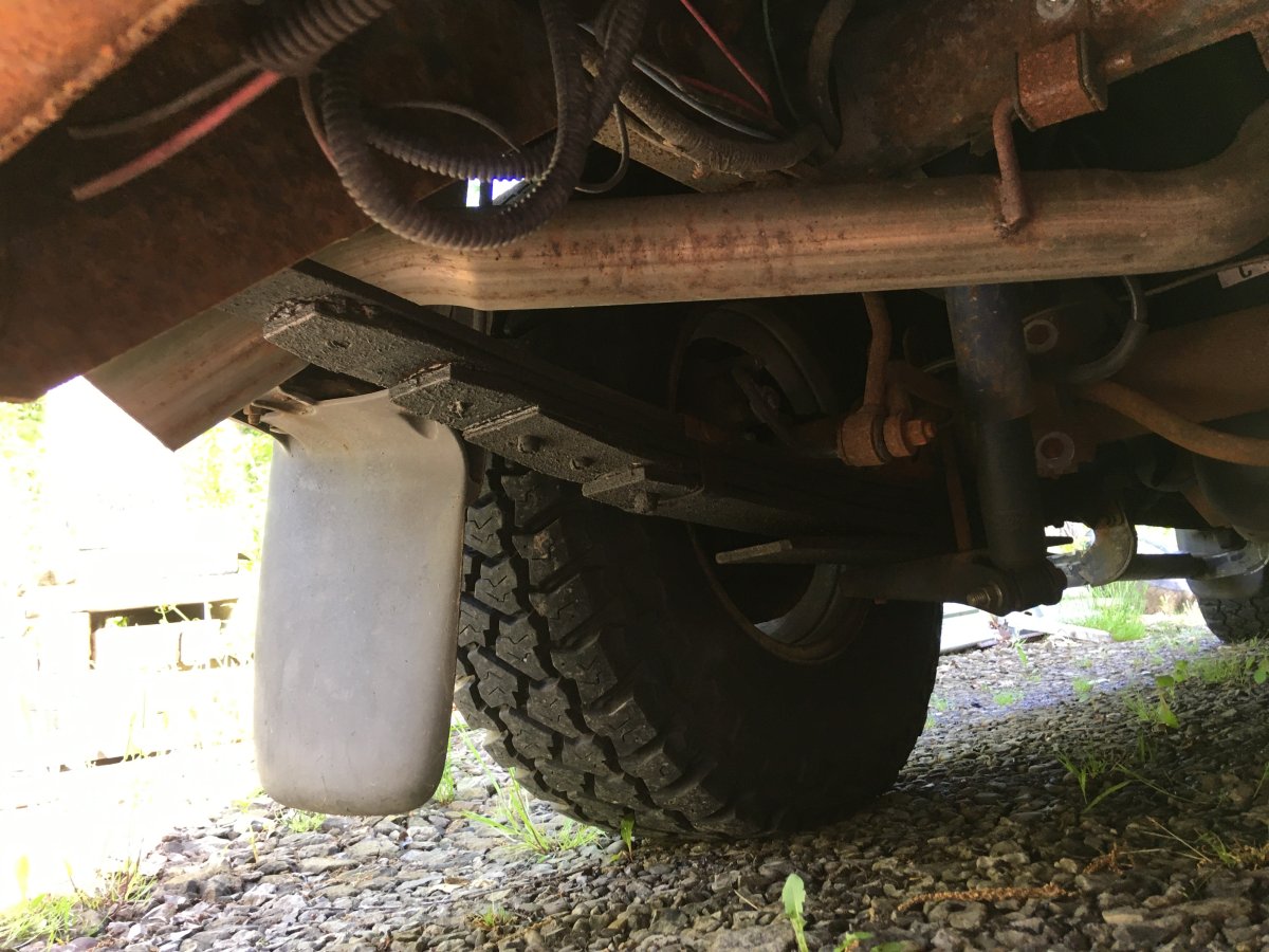

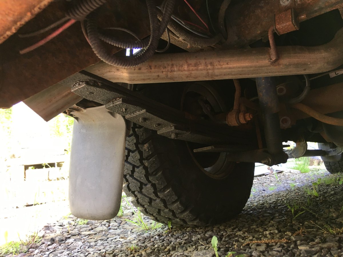

And then when I went looking for an exhaust leak (I found it, couple loose bolts and a couple pinholes), I found a real problem…

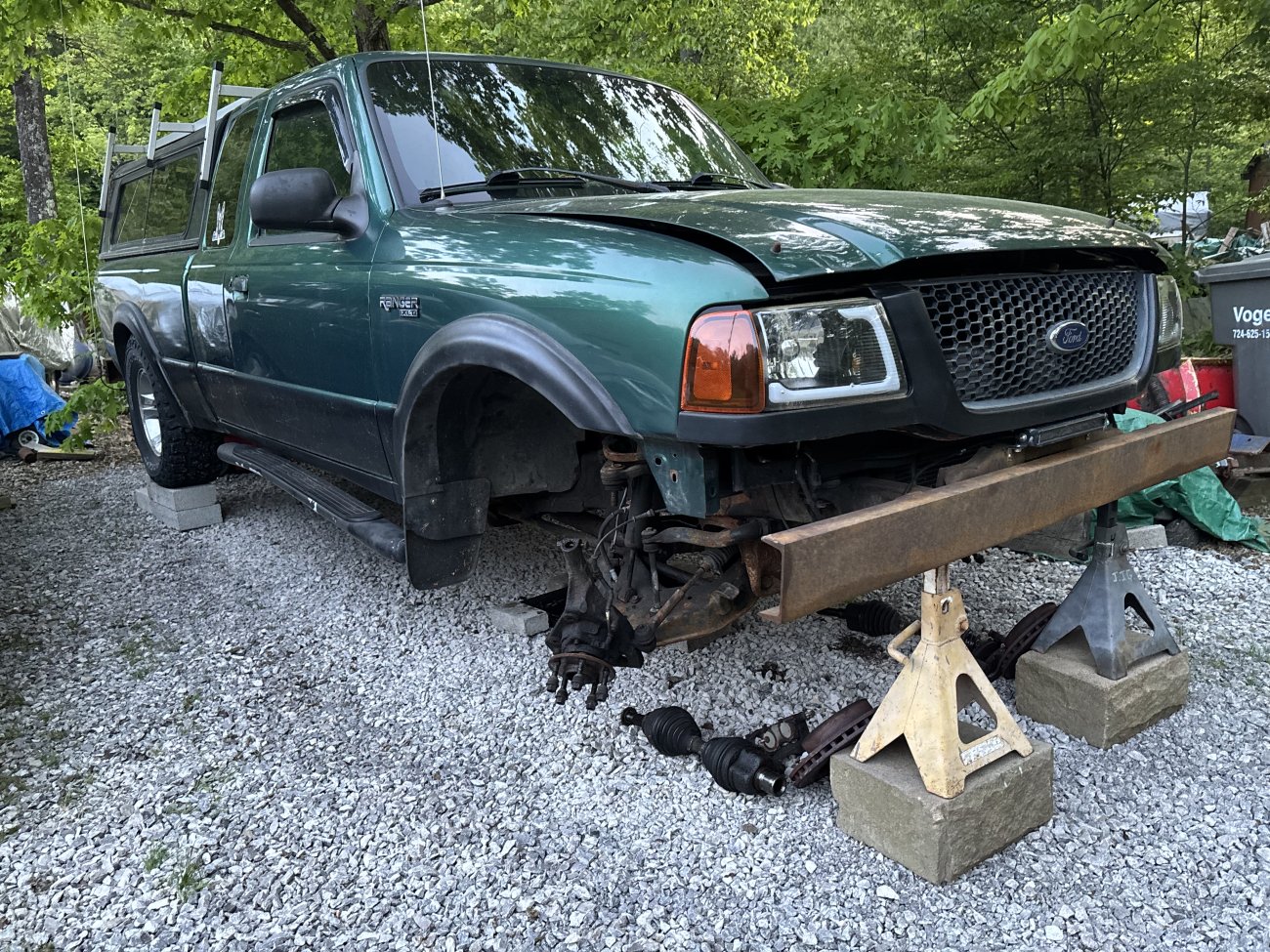

Progress has begun... Standby for updates…

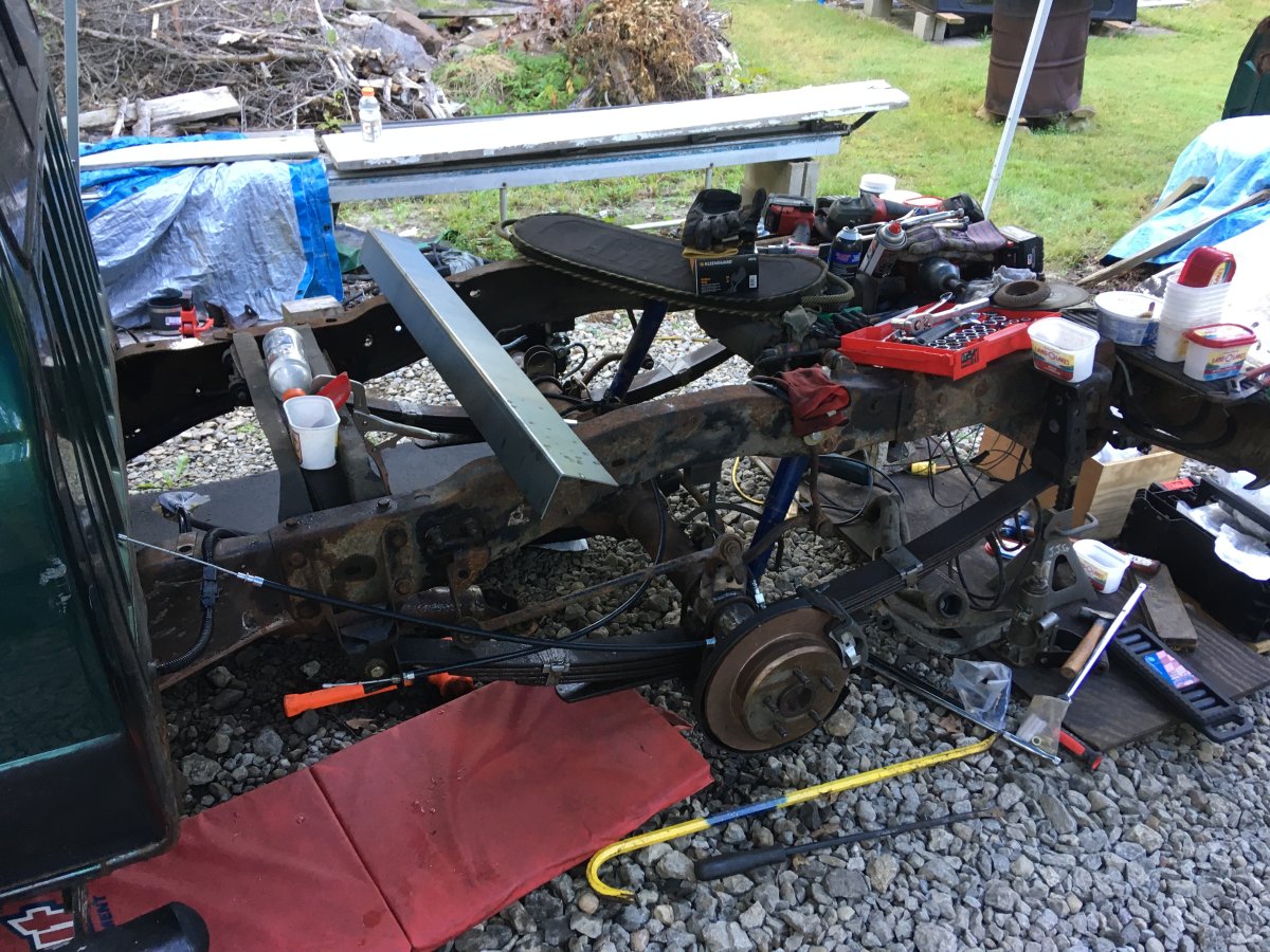

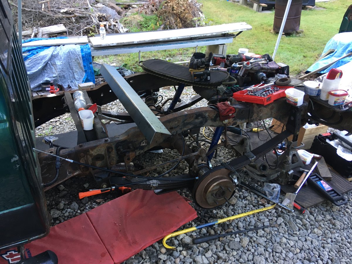

With the frame repaired and the bed out of the way, I decided it was a great time to make some more adjustments to the rear suspension. Additionally I figured it would be a good time to cut the spring perches on the rear axle and the traction bar mounts so that I could adjust things to get the correct pinion angle and the correct locations for the traction bar mounts since I wanted to use the Explorer 8.8" as a spring under axle and with the Explorer goodies. So once again with some help from @sgtsandman , we got after it.

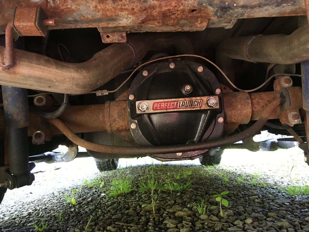

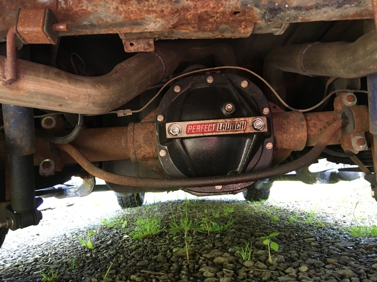

I should also mention that the 8.8" got new outer bearings and seals, new brakes all around, new clutches in the factory limited slip plus I did the mod to slip in a couple extra clutch disks for improved operation. Full synthetic oil went in as well, 75-140 if I mind right. The cover is a Perfect Launch aluminum cover with a truss for the main caps.

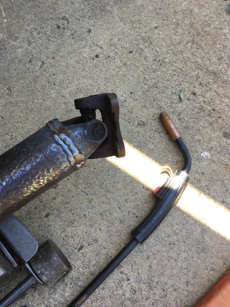

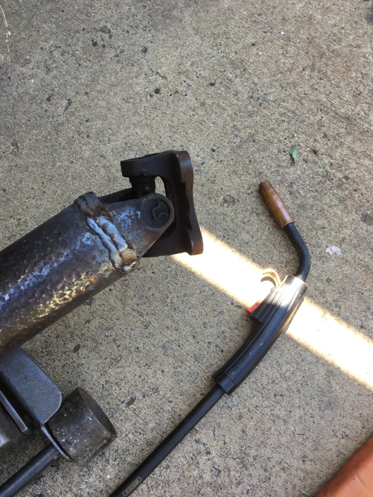

I also discovered that my changes resulted in my driveshaft being too long. After a lot of debate, I chose to cut it and weld it myself. Then I took it to a local spring/driveline shop for balancing. It wasn't perfect, but it worked and didn't take much to balance. On the positive, I didn't get charged much for the balance but on the downside the tech blew a hole tacking on the weight so now there's a weld slag BB rolling around in my driveshaft, lol.
