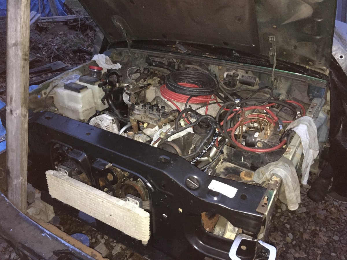

I continued getting the motor together in the truck and the front end back on. A new radiator/core support went in since mine was rotted to junk. I chose to bolt the new one in instead of welding and used a pile of 1/4" stainless bolts since that will make any later servicing or replacement of the motor easier. I also chose to replace the factory Ranger battery tray with the plastic Explorer tray, which aside from needing some bolt holes drilled, fit rather nicely. The 65 series battery was a little tight on the ABS module and the one ground bolt on the core support. I bent the ABS module bracket slightly to allow room and at some point here will also change the ground bolt for something more compact since I changed how the ground bolt in dad's one Ranger is and I think it would be a good option for mine.

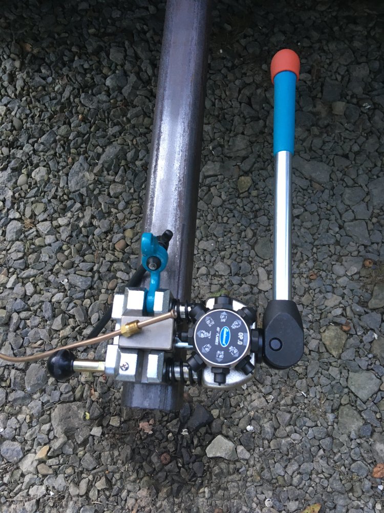

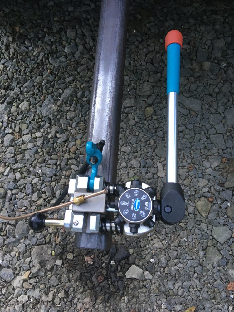

Also during this whole process I decided to invest in some new stuff. I bought a bunch of -6 AN PTFE braided line and fittings to replace fuel lines and other stuff. I bought some larger AN stuff to rebuild some of the heater lines since the ones with my motor were rather rusty. While I was at it, I also got a lever style brake flaring tool to make new hard lines with Ni-Copper line. The lever style flare tools are far superior to the standard cheap double flare tools. I spent the extra for the 37* AN die set for the tool as well.

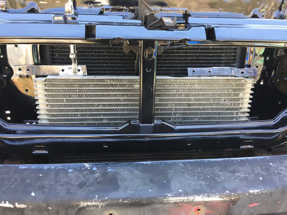

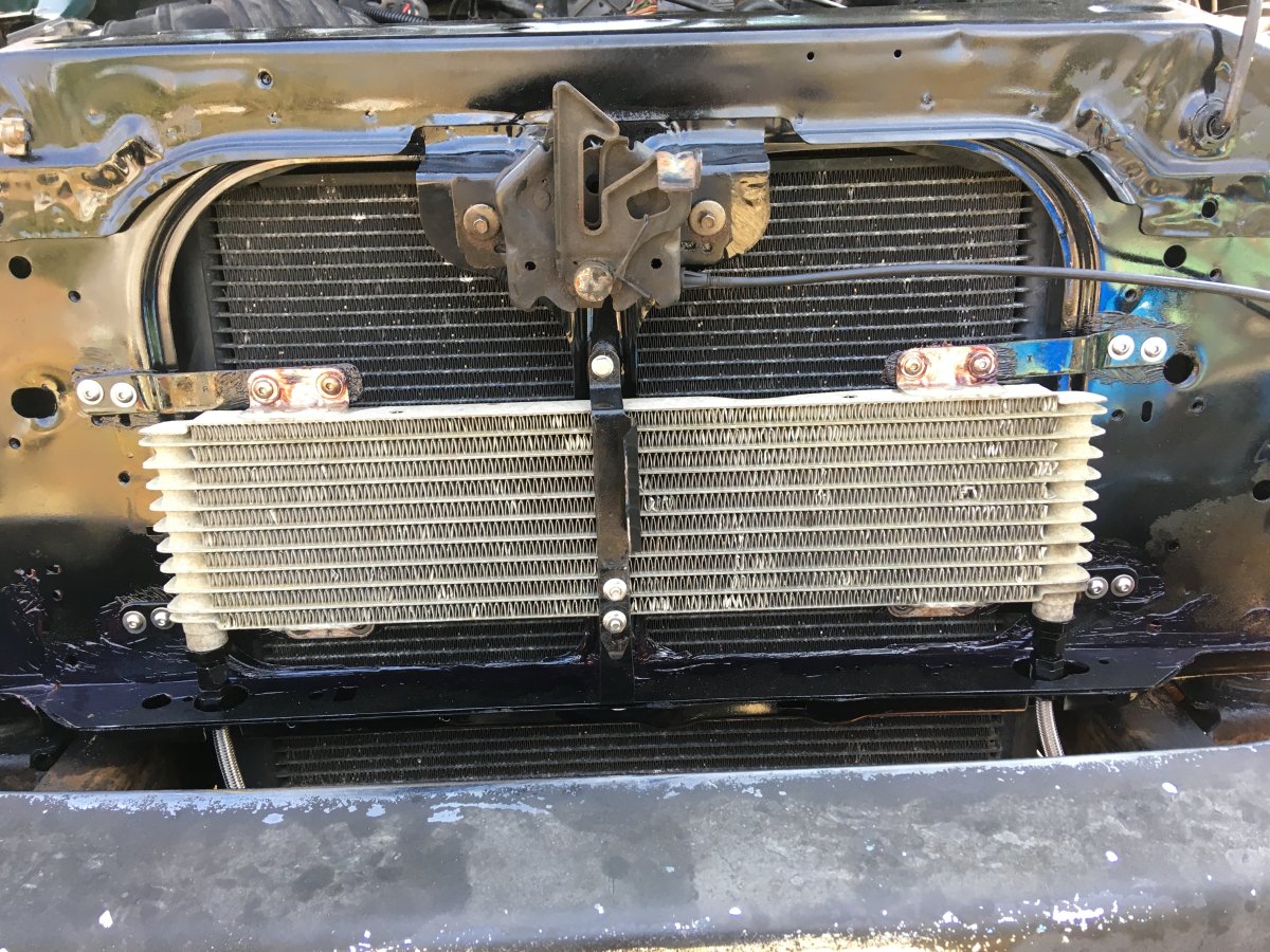

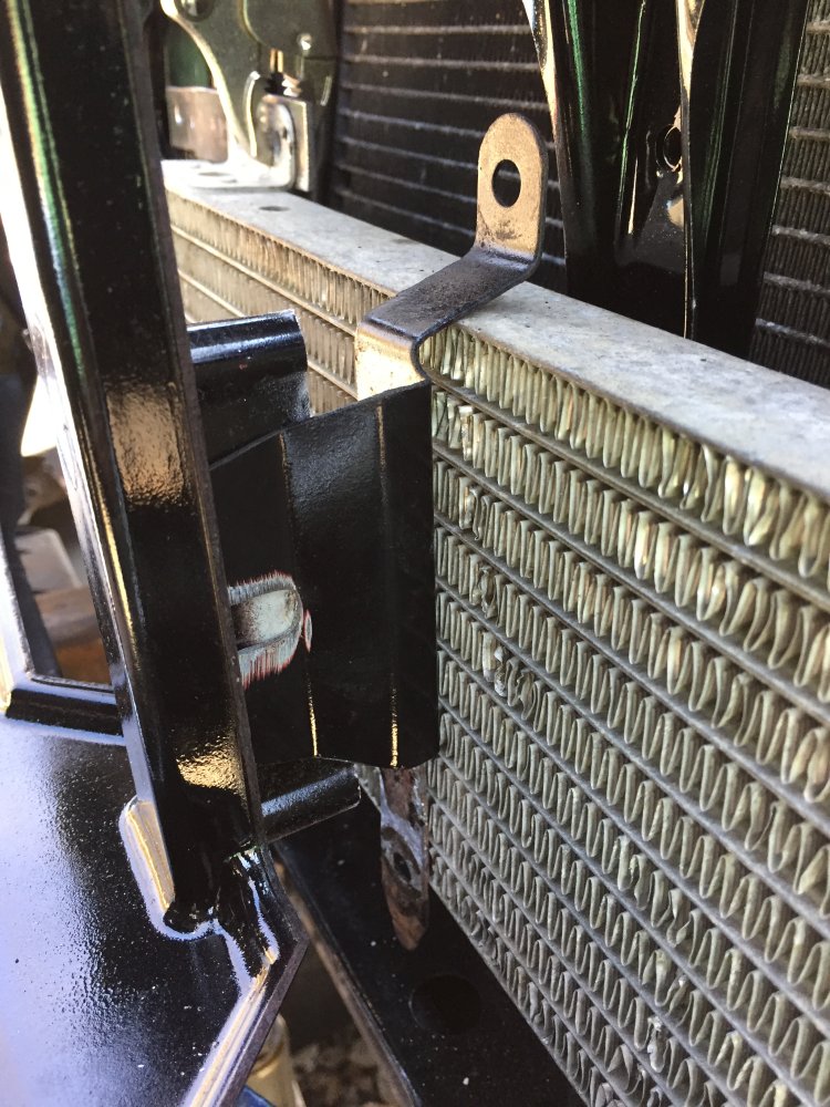

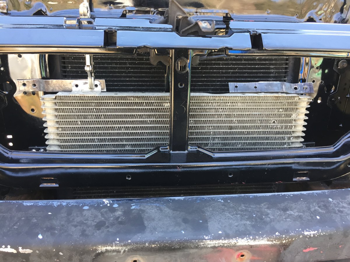

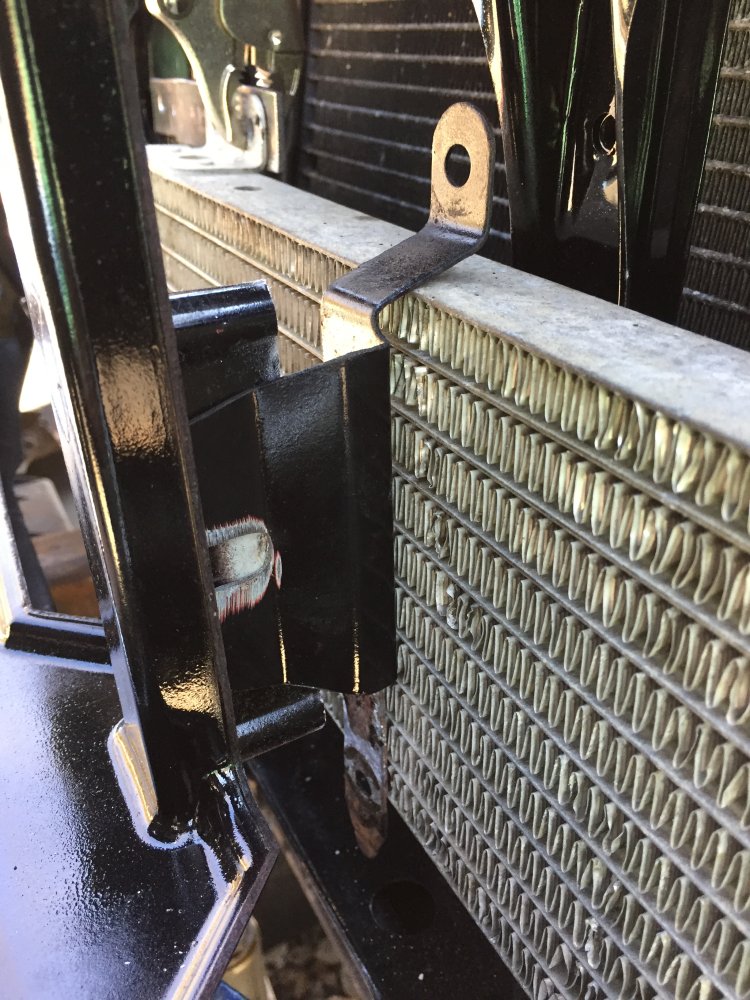

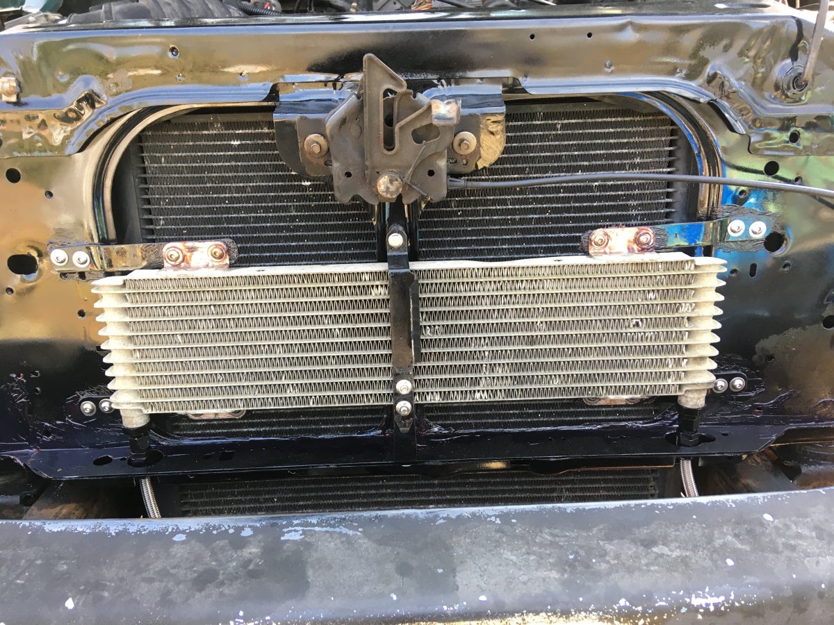

@sgtsandman came over to help me get some things handled with the project. I didn't get much in the way of pictures, but he manufactured up some brackets for me for mounting a different transmission cooler. Had to make a few adjustments to things, but I managed to mount a transmission cooler out of a 2007 F-150, which is over twice the size of the stock Ranger cooler. We also got a bunch of other stuff handled.
I also, against my better judgement, jacked up the back of the truck and put that on jackstands as well. There was a lot of work to be done on the rear suspension and changing out the rear axle to the Explorer 8.8" rear.
what braided lines did you use on the trans cooler?
it would also be nice for pictures of the piping to the new trans cooler.
-6AN PTFE stainless braided. I connected to 3/8ā€ aluminum line that I ran for hard line connections. The F-150 cooler that I used happened to have threaded connections and I just had to work out what connector I needed to make it mate. Really like how it worked out.
so, you replaced the stock hard lines with a 3/8" aluminum line? I am just trying to work out every little detail. I'm going to go with a similar sized trans cooler since my local junk yards don't seem to have the year range of f150 or e150 with the larger trans cooler.

Yes. So if I remember tomorrow I can try to get some pictures and details and all. Been busy and away from home the past couple days and I walked into a headache when I got home this morning.
There’s different ways to do it for sure, I’ve replaced or repaired trans cooler lines for years, used to do it with steel line and rubber transmission hose. Then I switched to aluminum because rust is a real problem around here and I’ve contemplated using stainless. Aluminum is cheaper and easier to work with though. Plus a lot of AN stuff is aluminum so less worry on dissimilar metals.
Dad’s one Ranger has two stock transmission coolers. I was going to go that route and I had a cooler to use but somehow it got water in it and froze which split it. I was in a junkyard contemplating grabbing one when a thought crossed my mind about a buddy that loved thinking outside the box and I looked at a couple vehicles near the Ranger section. Little bit of back and forth with a tape measure and I was pretty sure I could find a way to make a stock 07 F-150 cooler work. Then a little work and here we are.

Yeah, I’ve used a flaring tool to bulge tubing before for putting rubber line on. I should probably do a video on it all now that I have something resembling a workshop.
