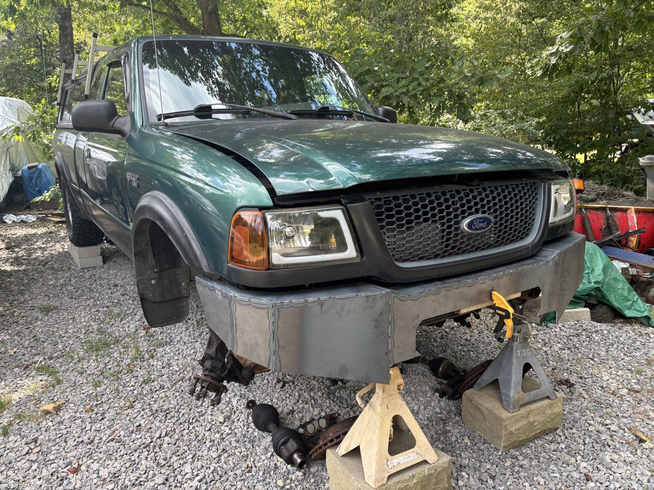

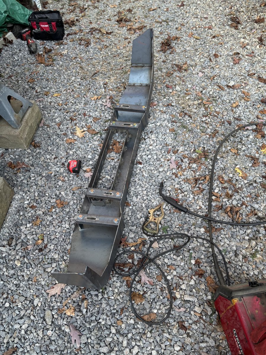

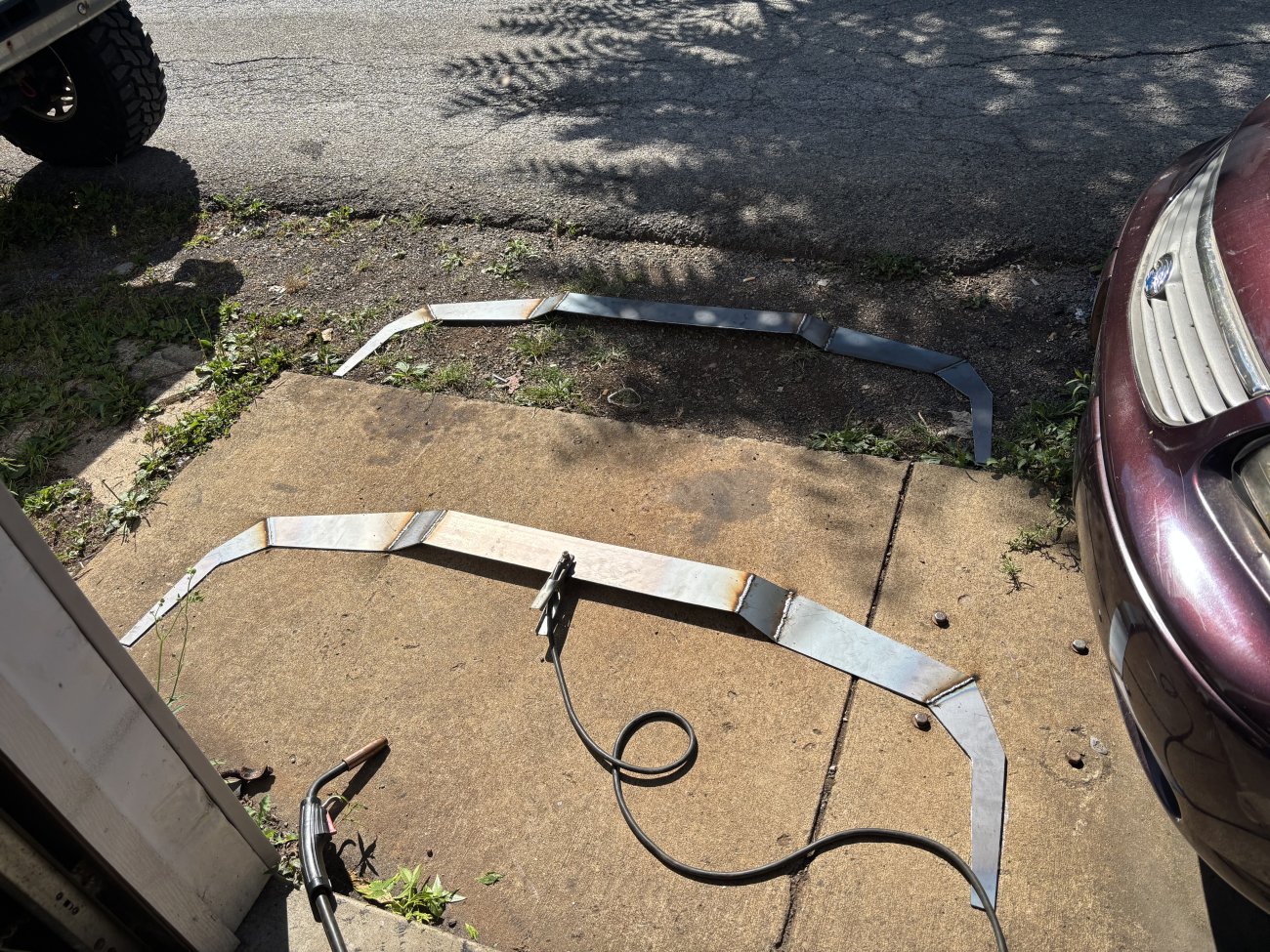

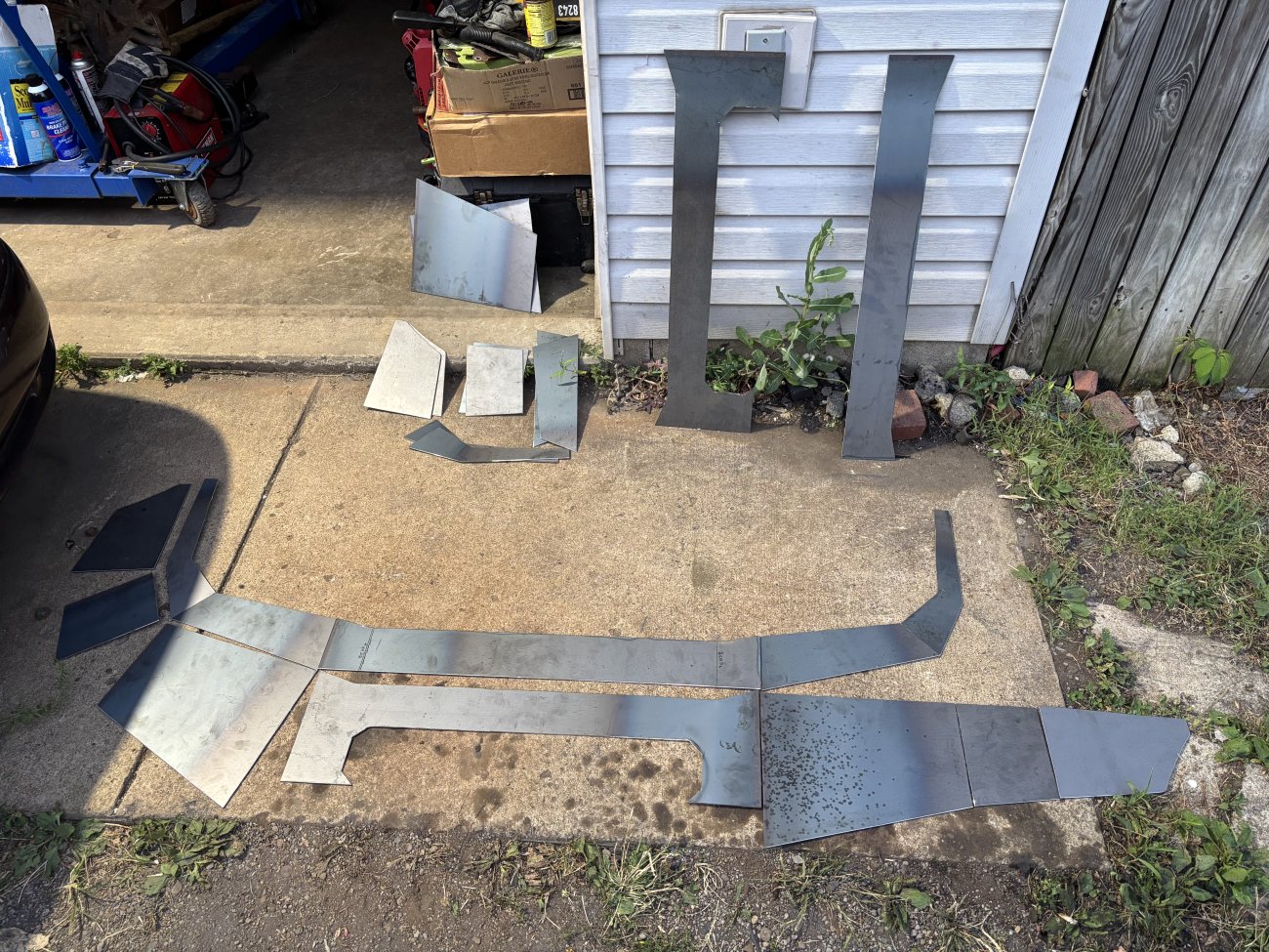

Bumper progress on the green Ranger. All 1/8” steel. Lots more to come on this design, I need to tack it together and test fit so I can figure out the rest of the pieces needed.
My 2000 Green Ranger 5.0 lowered AWD
More bumper progress. It’s getting heavier. Gotta figure out what I want for bracing, make the pockets for the fog lights, bend up the tube and finish weld yet, then I can paint and install. Pretty happy with how it’s shaping up. I’m going to build a front hitch that fits through the window in it between the factory tow hooks at some future point. I was originally going to try to build it into the bumper, but I was doing some head scratching on how exactly I wanted to do it and realized I could save myself time on getting the truck back on the road and brain cells by just building a separate hitch which ideally would also work with a factory bumper.
