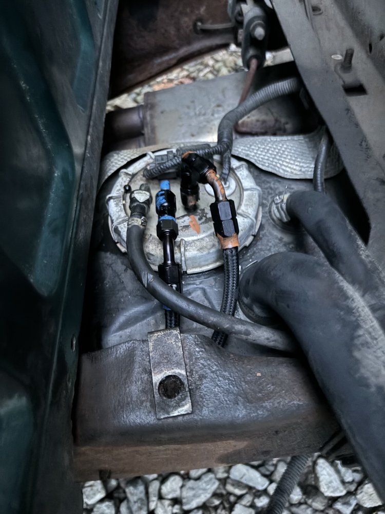

Chased a bunch of other random small problems but mostly just drove it because I was tired of not driving it and tolerated a bunch of problems. After my patched fuel line blew out for the umpteenth time, I decided enough was enough though. Propped the bed up and replaced the lines with the -6 AN PTFE stuff. Because of how far it sat up off the tank, I made a piece of 1x1" angle that bolts to the crossmember by the pump to keep from snagging the bed on the fuel lines. I don't seem to have a pic with the angle on there, but it just sits across the top of the crossmember on the right and goes up past the fuel fittings but not far enough to interfere with how the bed sits.

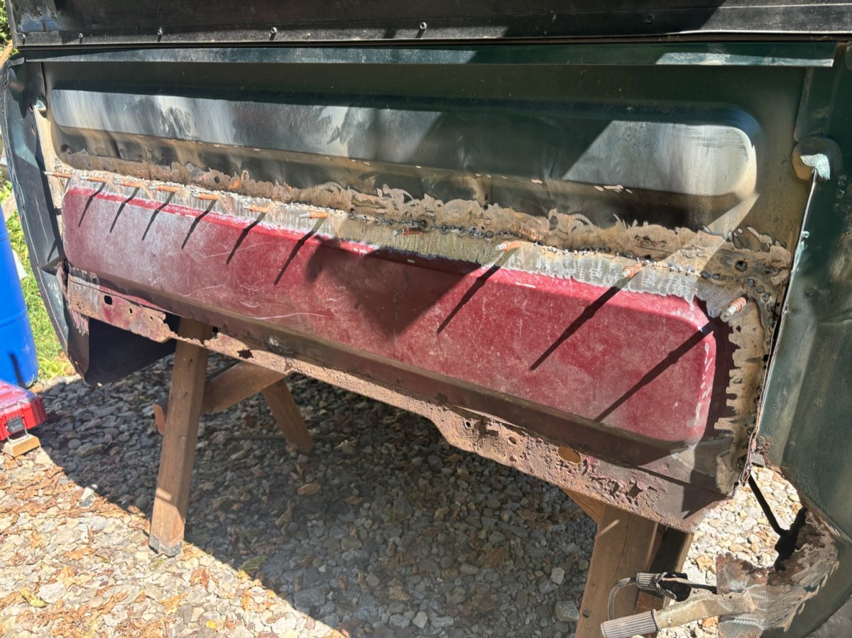

Also ended up pulling the bed off and patching the front of it with part of another bed that I salvaged years ago. It was a quick and rough patch job, I intend on looking for a not-rusted-out bed at some point.

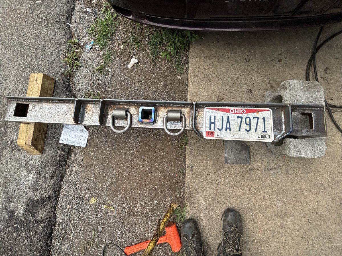

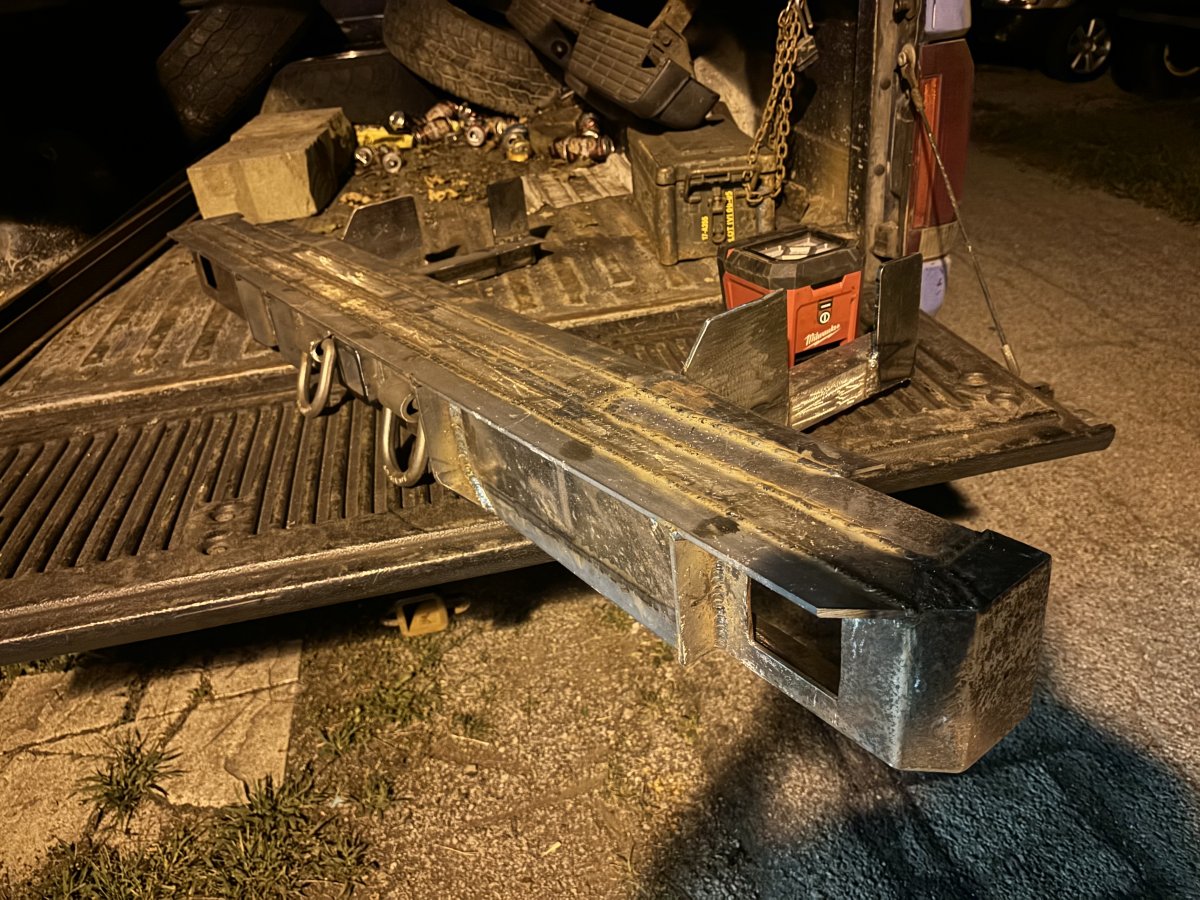

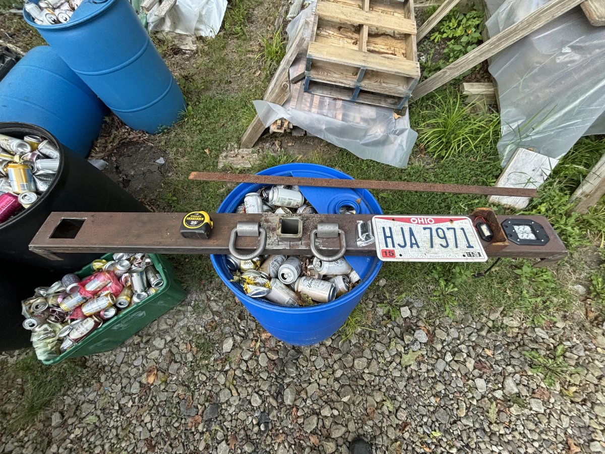

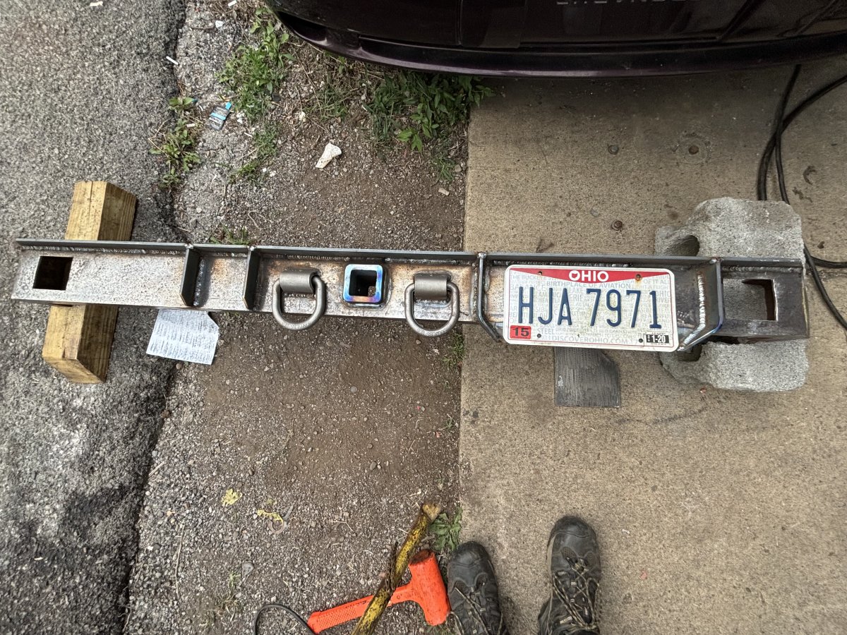

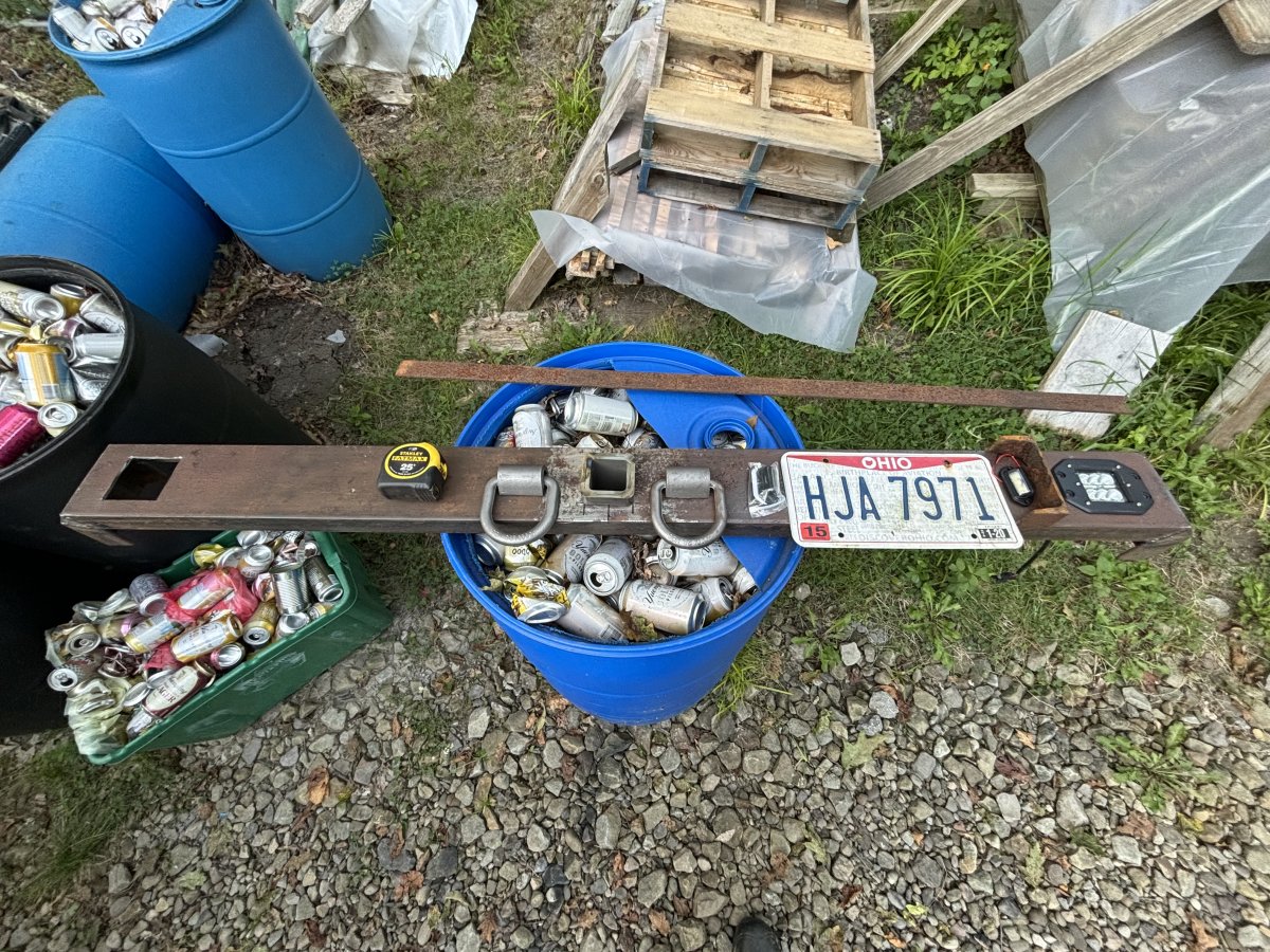

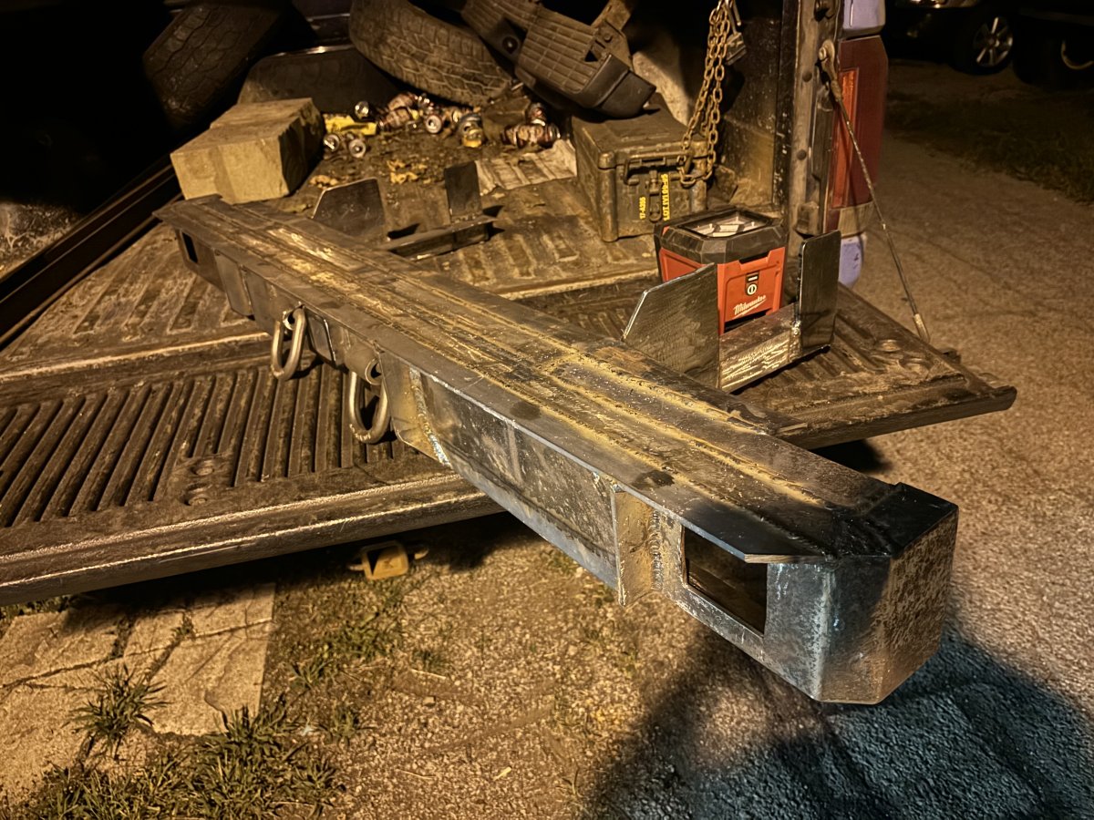

Since both my hitch and rear bumper were rotted out plus my hitch was way, way too low for my liking after lowering my Ranger, I decided to build a custom hitch bumper. Took a little bit of playing around to figure out exactly what I wanted, but the basis was a piece of 5" C-Channel that I nipped a pair of 23* pie cuts on each end so I could bend it around. Then I started adding all the bits that I wanted. It didn't come out quite perfect, but I started to rush on the build and that's where it happened. Still, I'm pretty happy with the result and I can always build another. It's mostly 1/4" steel. I didn't weigh it, but I'm going to say that it's roughly the same weight as the factory bumper and a Class III hitch. It's actually probably better than a regular Class III since I ran the braces farther back the frame rails and put some side plates on. Oh, yeah, BTW, that’s a junk license plate, I use it for figuring out plate position.
