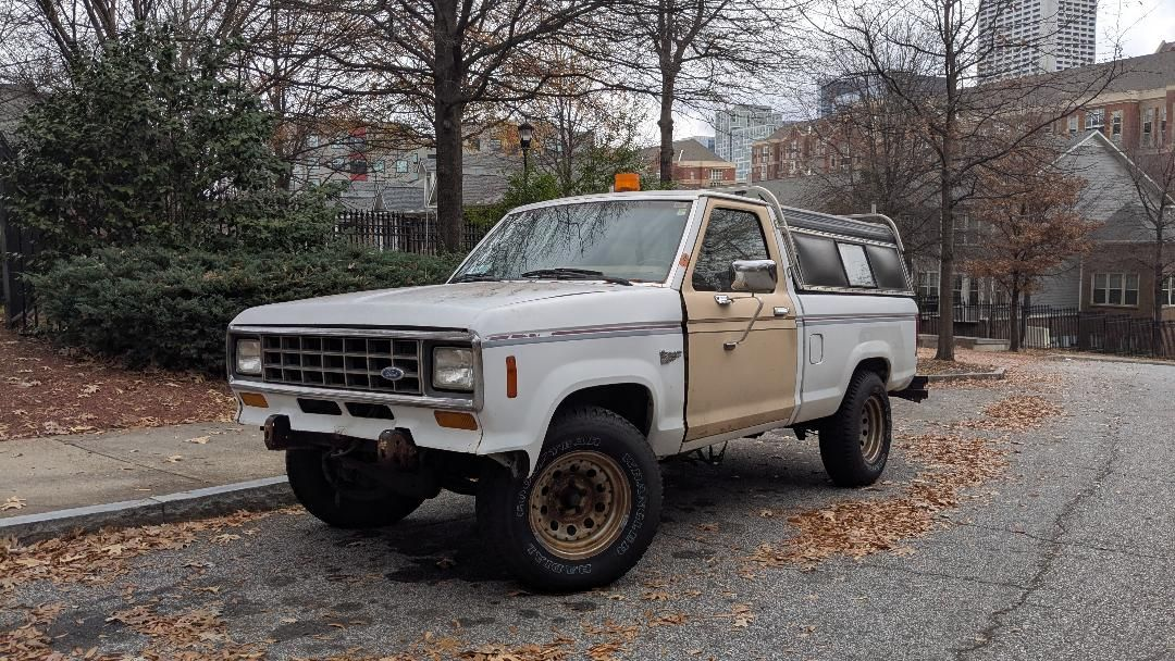

Pictures?
Don't want to hijack this thread so after this I'll go back to lurking here in silence like I've been doing for months. I'll put one in that my friend took a couple months ago. They painted over the original factory safety orange (still that color under the hood), and put on the old tape striping over it. Wish it still was safety orange to be honest, seems to be a very rare color, only a couple examples still out there. Got t-boned under the previous owner's care, so new door put in. The door only opens from the inside, which makes getting in a little tough sometimes.
Aftermarket block heater, cruise control servo (d/c), spotlight (d/c because slightly illegal), wig-wag flashers (still in), and the roof light, all done by the railyard. In fairness, it was one of the ones that got merged into NS a few decades ago.
The one thing that I am not a fan about is that this truck used to have the attachments to ride the rails, and a previous owner kept them. It's got a modified shunt bumper on the rear so that it could back up railcars in the yard, and the bumper on the front got taken off to make way for the rail attachment bumper, which got removed later.
She's got some issues and scares me every so often (daily), but love her to pieces.
