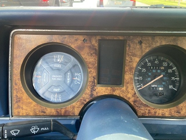

  • After 20 mins of highway driving, it died at restart with ¼ tank showing. Added 2 gallons and it started fine. Still shows ¼ tank.

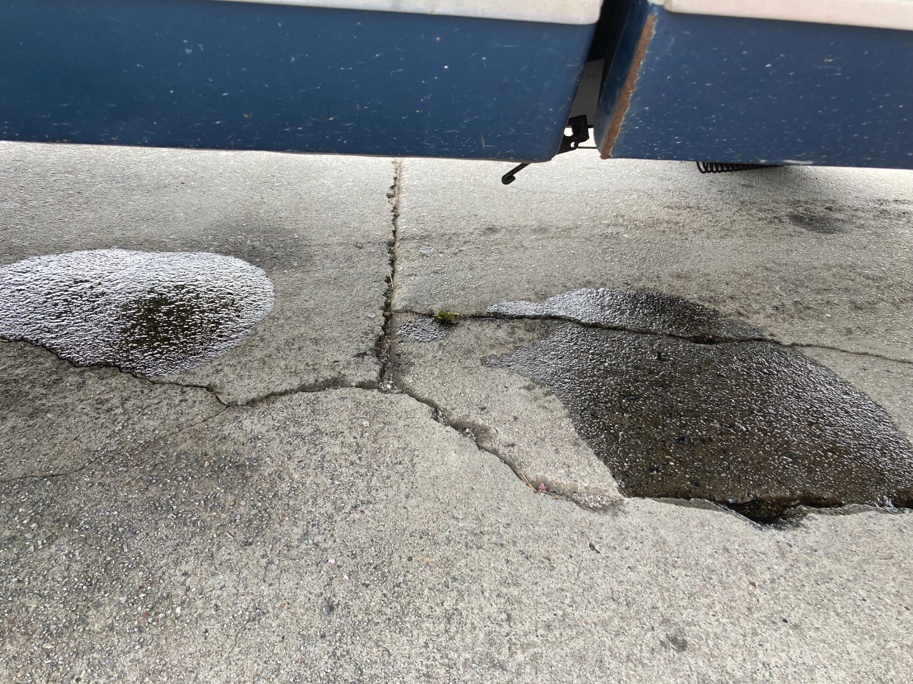

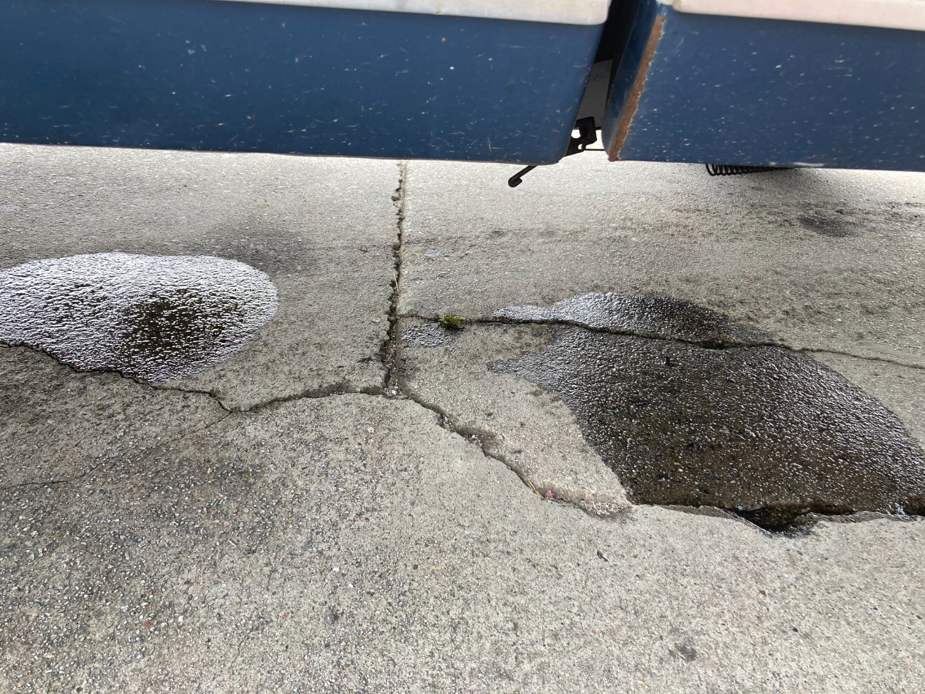

Pictures of the gas leak attached. At the pump, after it filled up and pump stopped, it just plopped out in two spots by the tank. Maybe 8-12 oz and then stopped. No visible leaks since.

3.fuel tank filler hose is probably old and cracked where it bends and attaches to the tank. Replace hose or just never fill past 3/4 tank.
4. Ain't got no gas in it. Well, level sender may be showing its age. What does it read when you fill it? Does it seem to track normally between full and 1/4 tank? That's something you'll jist have to play with and eithrr learn how it acts and get used to it. Or, lift the bed, take the sender out and fix or replace it if it's consistently not reading properly.

Absolutely the first thing I would tackle is the fuel pump and the gas leak. You don’t want to turn into a Roman candle going down the road! Replacing the entire fill assembly is not too expensive. It could solve a lot of “old truck “ problems.
Looking for a 2.9L Mechanic in Atlanta Area
Basically, it’s a fat rubber hose that goes from the gas door assembly down to the top of the tank. There is a second harder plastic line that actually allows the fuel to go from the gas door almost all the way to the bottom of the tank. It runs down to the bottom of the tank, so you don’t get static electricity with the gas dripping off the end when filling it. You have to remove the bed to replace it, but removing the bed is actually very easy on those trucks. I’ve done it several times all by myself with my worn out body.
I don’t know anything about the Mustang fuel pump, but the Ranger pump has a feed and a return. If the return is leaking, it should have gas dripping all the time, and that is a horrendous safety problem.

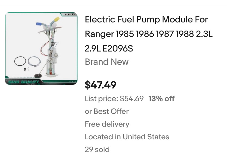

You also have to have the bed off to replace that gas pump. The gas pump includes the sending unit for the fuel gauge. I don’t know what your finances are, but for $45 for both of those parts it can save you an awful lot of headaches as you go down the road.

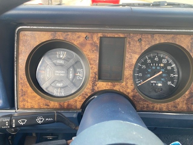

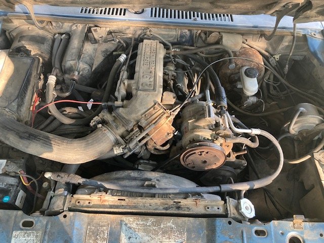

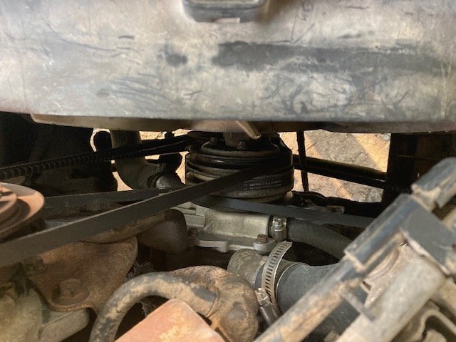

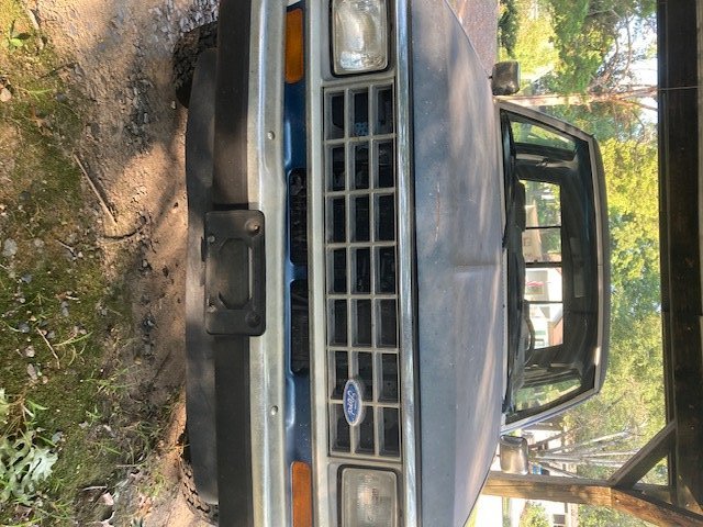

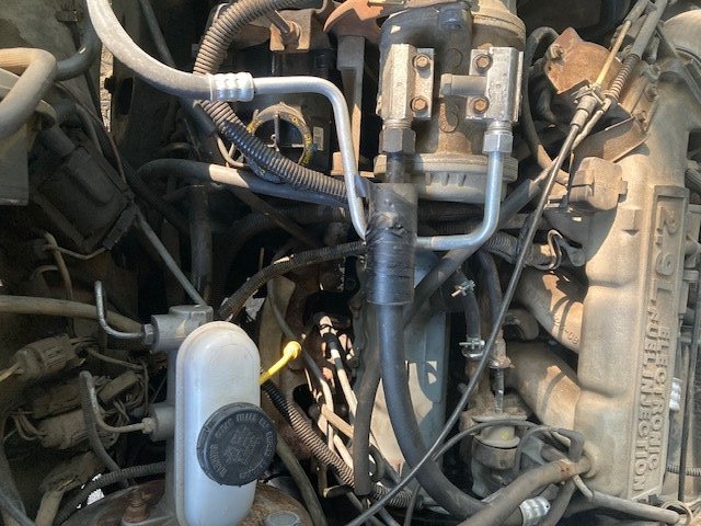

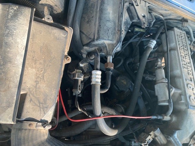

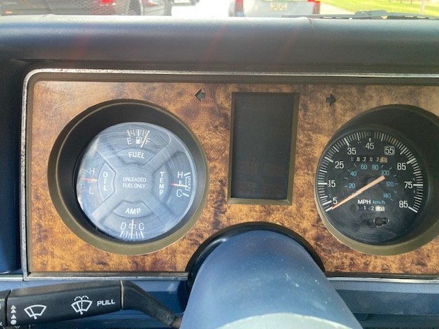

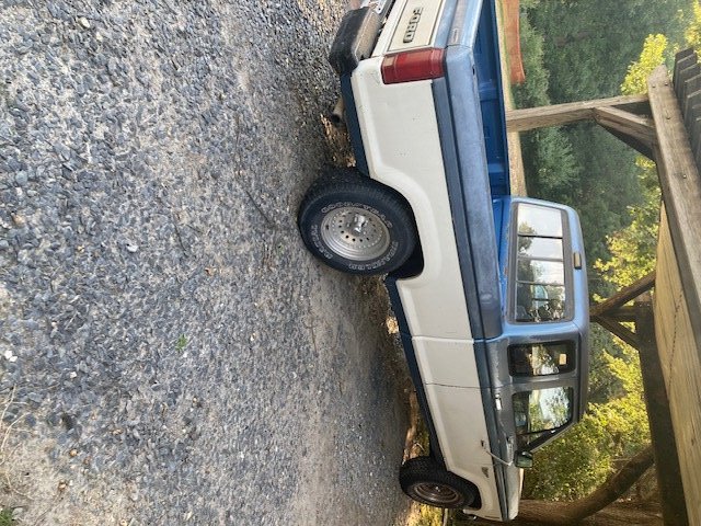

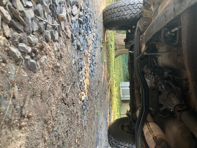

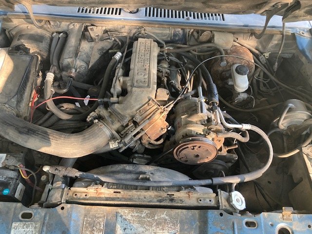

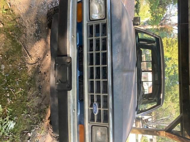

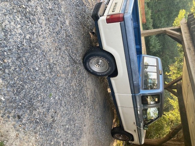

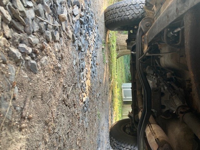

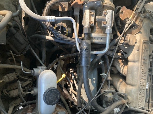

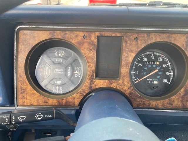

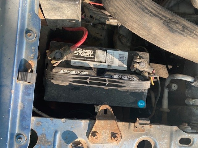

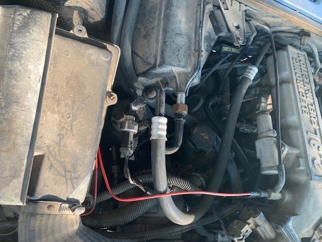

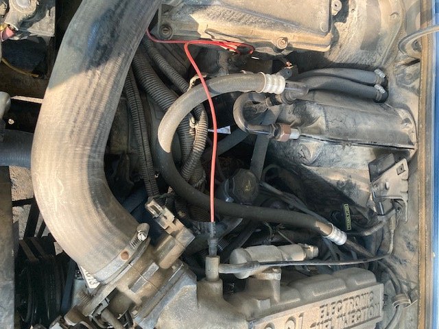

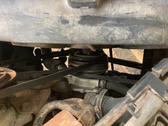

Here are some pictures. Pictures of the instrument panel were taken about 20 min apart on my drive home, after the truck was warmed up

@Peter_'86_2.9L_Auto and I connected off-line. He’s bringing his 86 by on Monday evening, and we’ll see where the adventure goes.

Peter came over Monday night as planned. It just dawned on me that he and I did not discuss who was going to do the postings on his little truck journey. I’ll throw a little tidbit out there to break the ice.
What a sweet 86 extended cab square body! It has the light blue velour/carpet looking seats and door panels that are almost like new, one little bad spot on the driver seat that I’m pretty sure it can be fixed easily. Carpet is in great shape. It even has that window shade kind of thing that you pull out from the back window to cover the cargo area, & dashboard looks like it’s never been touched.
It’s pretty straight and rust free, a couple little rust spots the size of a quarter. It has a couple little dents, paint is faded, mostly that brushed effect when you go through too many of the old car washes with the nylon brushes.
New springs and parts on the front end, and shock all around. The AC works, and there are a lot of new parts under the hood.
Peter wants to use it as a daily driver, and he commute daily from a little bit north of the all the way to downtown Atlanta (horrible rush-hour traffic) every day, so reliability is the first task. When we met and went over the truck, the priority is getting that fill neck fixed, and the gas gauge/pump fixed. When we were going over the fluids under the hood, the power steering pump, which looks new, was near empty. We put fluid in there, but the next day he informed me that it’s dripping, so that’s now the top top priority. New pub from AutoZone is $70 plus the core charge, but I’m not sure that’s the problem yet.
He seems like a great guy and it looks like we’re going to have some fun doing this stuff together, but I have one concern…..
….. he seemed very skeptical when I started talking about rustoleum.
Rick has it correct. Gotta fix the fuel issues first. There was a 92 Mustang fuel pump installed, while the OEM's were bypassed, so replacing that is on the list too.
