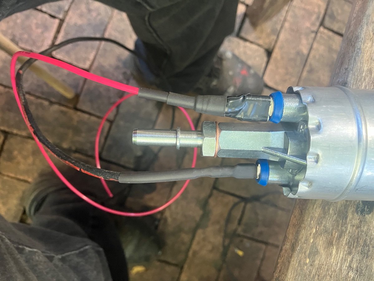

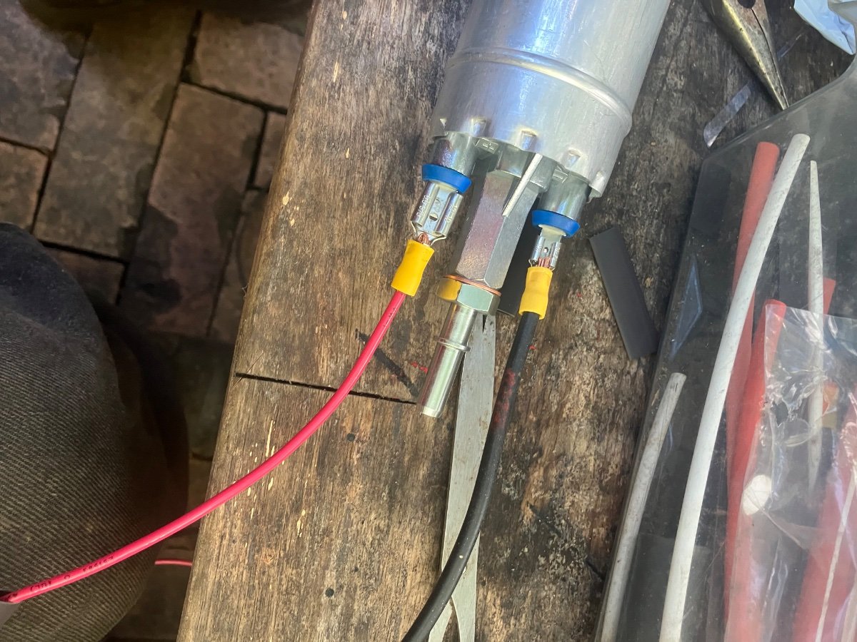

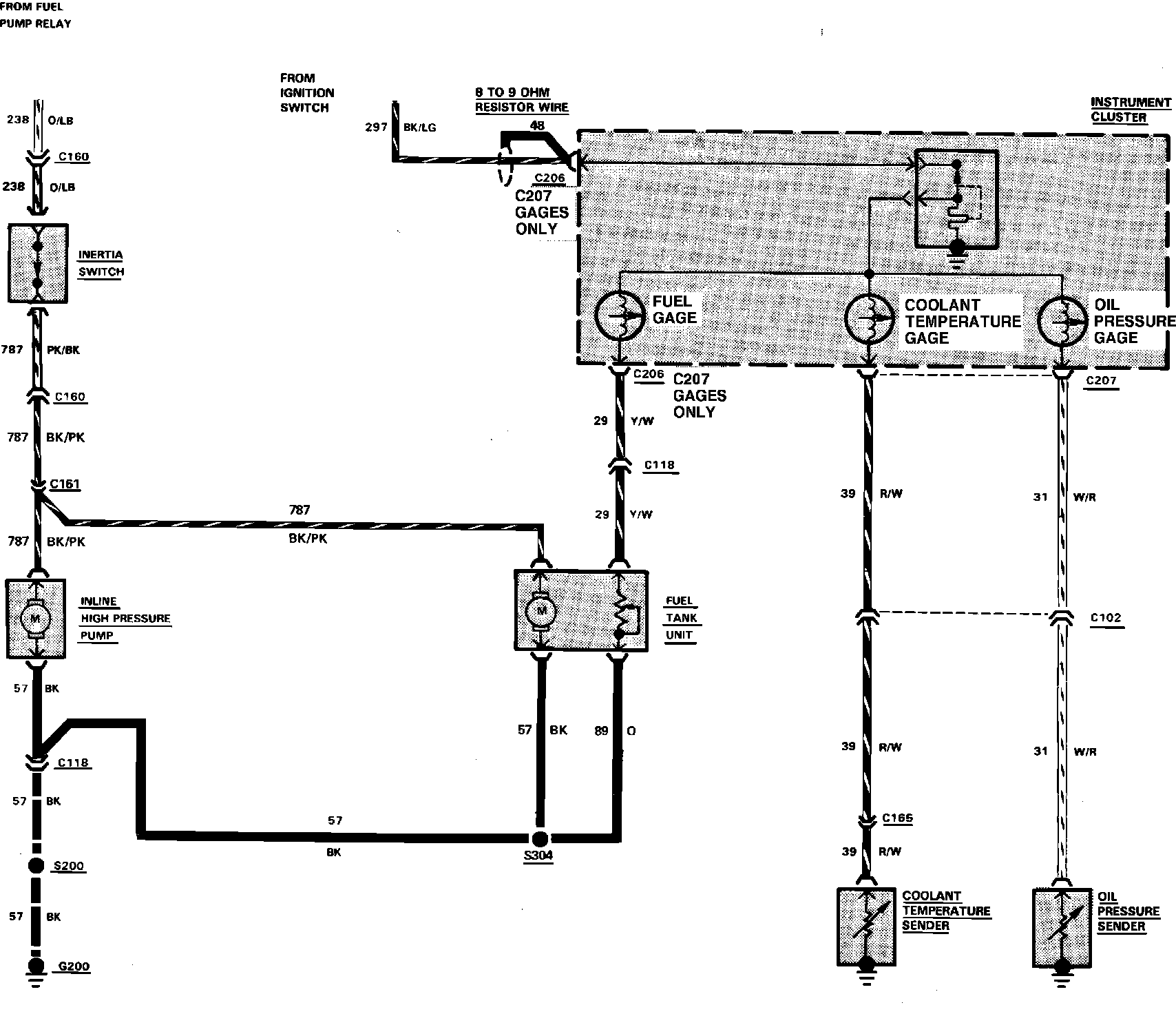

The original pump wiring was just split from the the one wire coming out of the inertia switch.
No need to replicate the factory setup at this point.

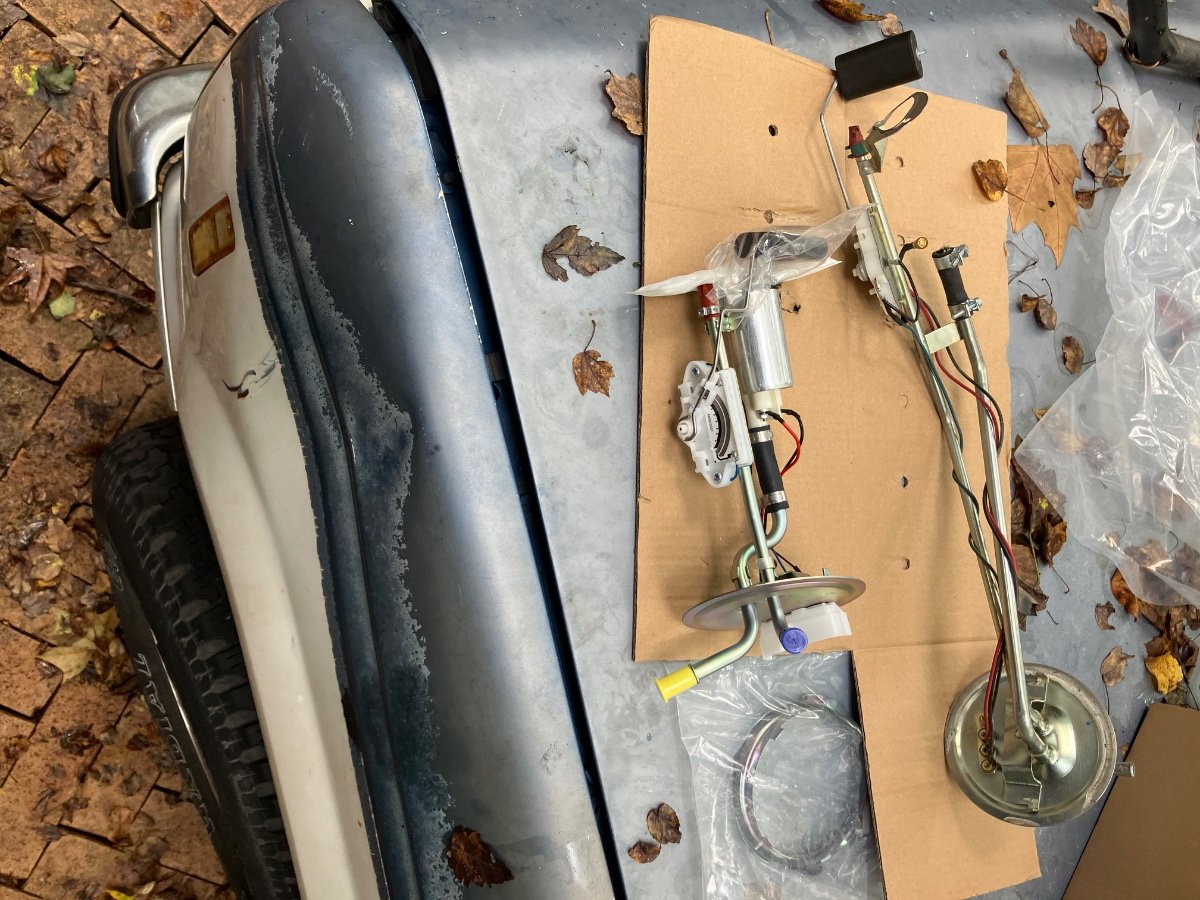

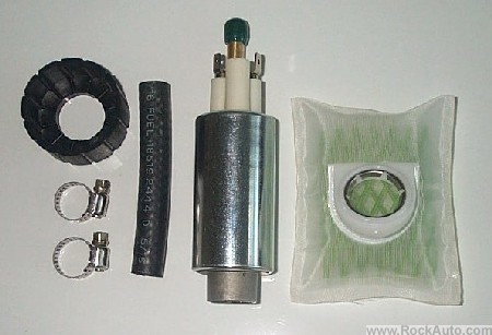

Order a sending unit for 86. That pump looks just like the one for a 90. It should have a strainer on the bottom:

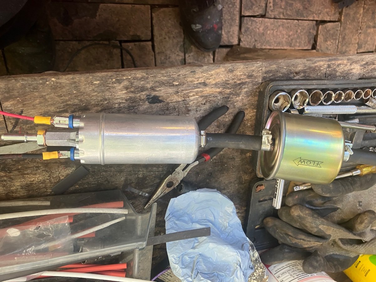

The only 1082BD pump I found is listed as for a Hyundai Sonata.Nevermind. Here is the exact pump:
Electric Fuel Pump Fits select: 1985-1997 FORD THUNDERBIRD, 1995-1997 FORD WINDSTAR - Walmart.com
Buy Electric Fuel Pump Fits select: 1985-1997 FORD THUNDERBIRD, 1995-1997 FORD WINDSTAR at Walmart.comwww.walmart.com
Haynes diagram for 86 shows power from fusible link "R" or "L" depending on date of manufacture to yellow wire at fuel pump relay. Then Orange/Light Blue out to inertia switch as in diagram above.
Muchas gracias to @SenorNoob for the diagram and detailed answer. I’m a decent shade tree, but I don’t have the knowledge a lot of you guys have on these trucks. I greatly appreciate that response.

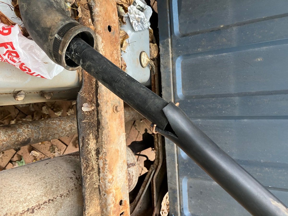

However, for @Peter_'86_2.9L_Auto, we’re going to put it back to original. As mentioned earlier, the fuel lines between the tank and the fuel rail need to be removed and reinstalled properly. But the main reason for going back original is because everything on that truck is pretty cherry, and it’s all original. I’m not going to make a fool out of myself by saying to you guys I’m not inclined to ever modify the original, but this is Peter’s truck and it really is sweet. I think everything we need is on order now.
But I’m writing this with a smile for a different reason. When I looked for the fuel pump assembly, we found units from $50-$250, had to look through 20 sources, and then had to double check that it really was for the right truck configuration a dozen times. Ditto with the external pump. We ended up getting both for $80 on eBay, five or six day delivery. It would’ve been over $200 to buy them locally.

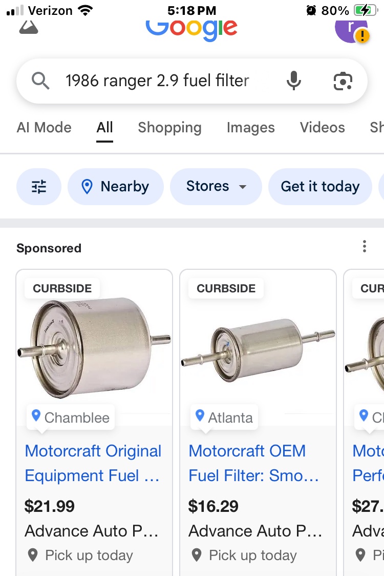

It only makes sense to change that fuel filter as well, even though it looks like it’s new. It inspired me to change the fuel filter on my 87, and also on my 97. I’ve got a half dozen that fit 87 and 88 town cars, but again the desire is to go original. Here’s a little bit of what makes me nuts when I look for parts like this. I searched “1986 Ranger 2.9 fuel filter.”
When I opened up each one of these, it was literally the identical part number even though the pictures look different, with a five dollar difference in price from the same company. The $16.99 was the cheapest price for local pick up.

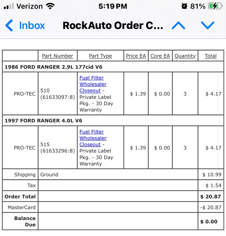

I went to rockauto. The correct filter was a “Pro tech 510“. The correct filter for my 97 is a “pro tech 515,” which has a higher flow rate. Both of them were $1.39 each, I ordered three of each, got the two day shipping, and all six together were $0.13 less than the filter on the left above.
