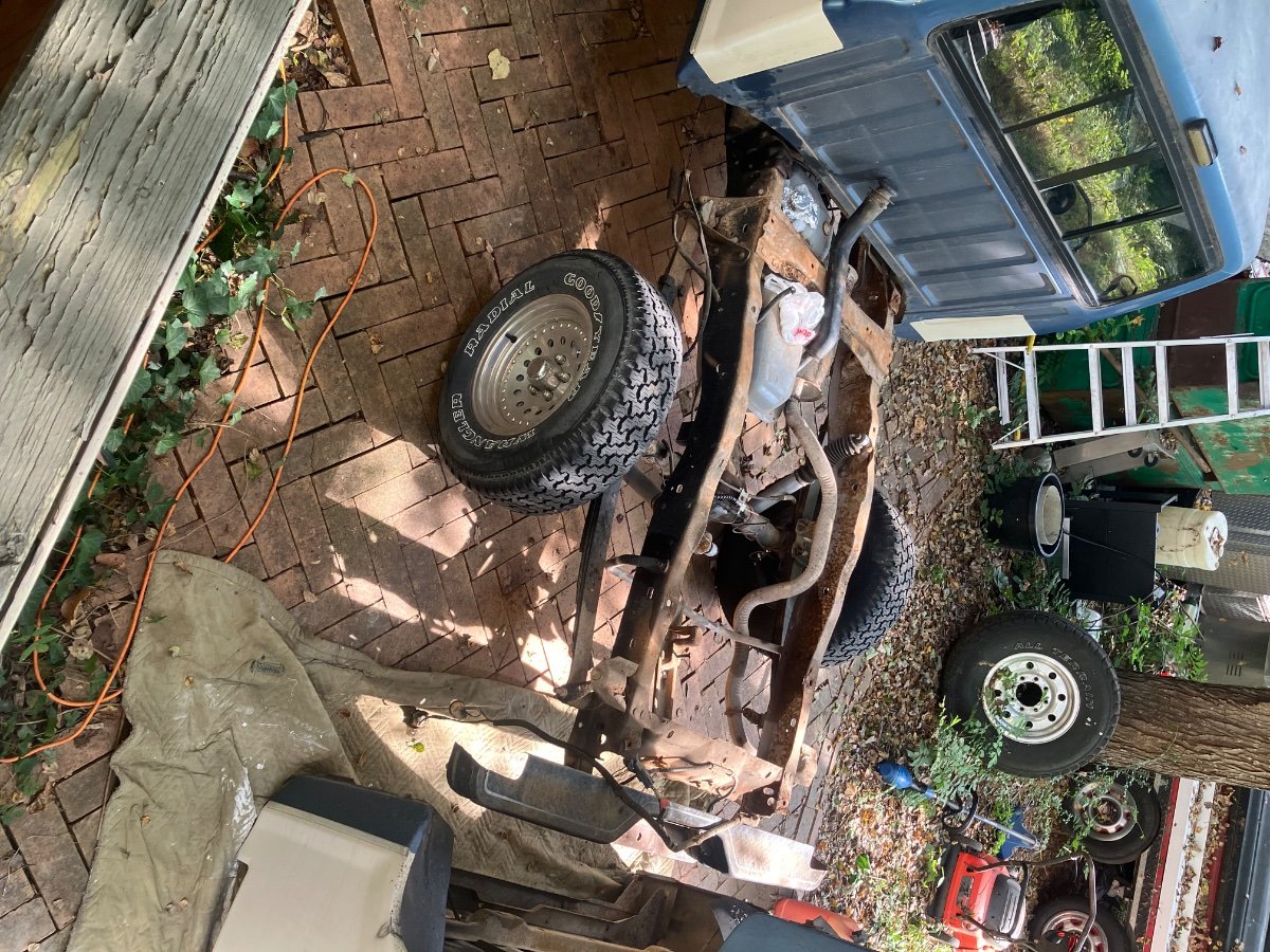

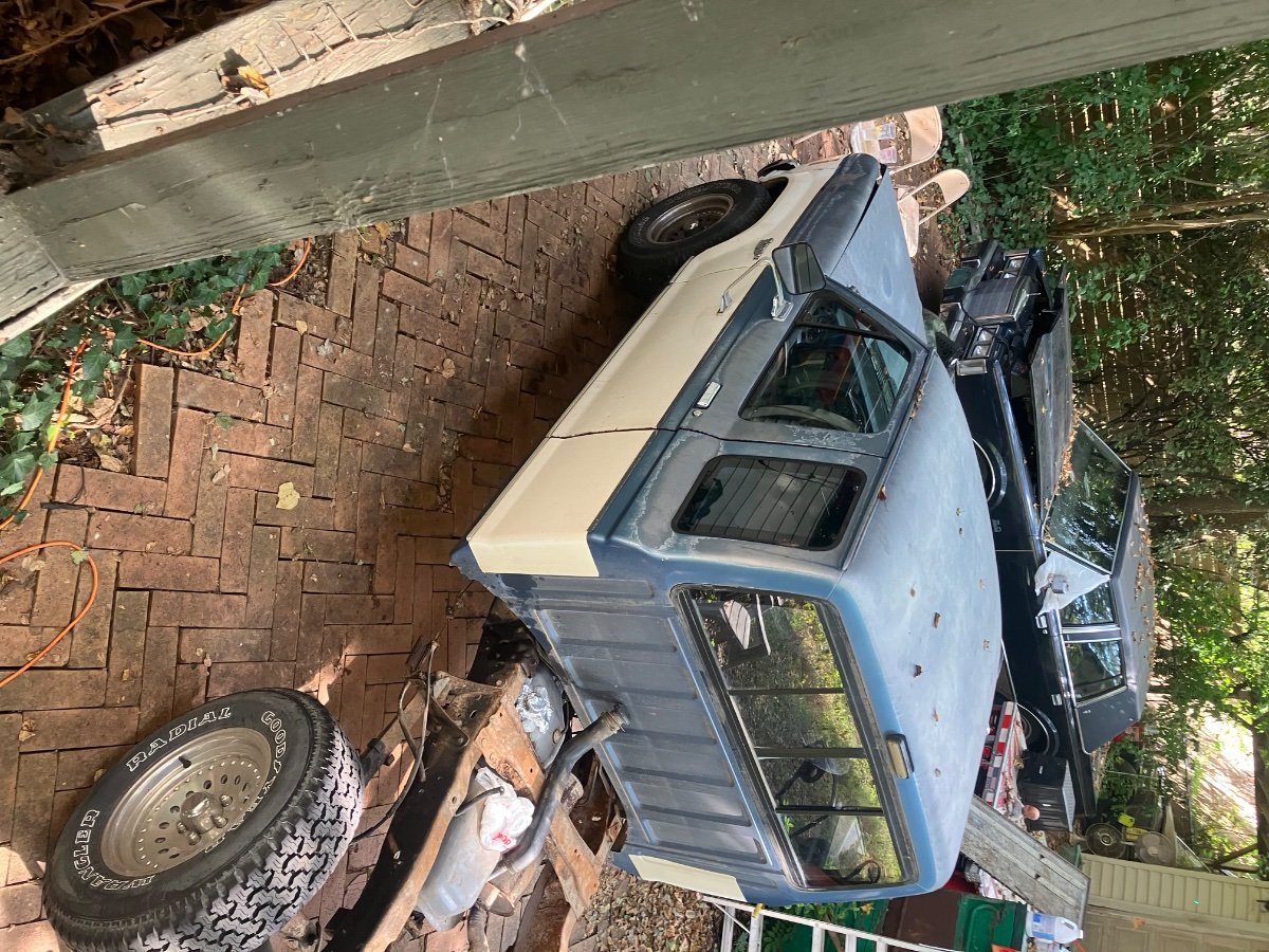

Peter drove it to my house without issue, and I parked it out back. Didn’t take long to get the bed off and take a look at what was going on.

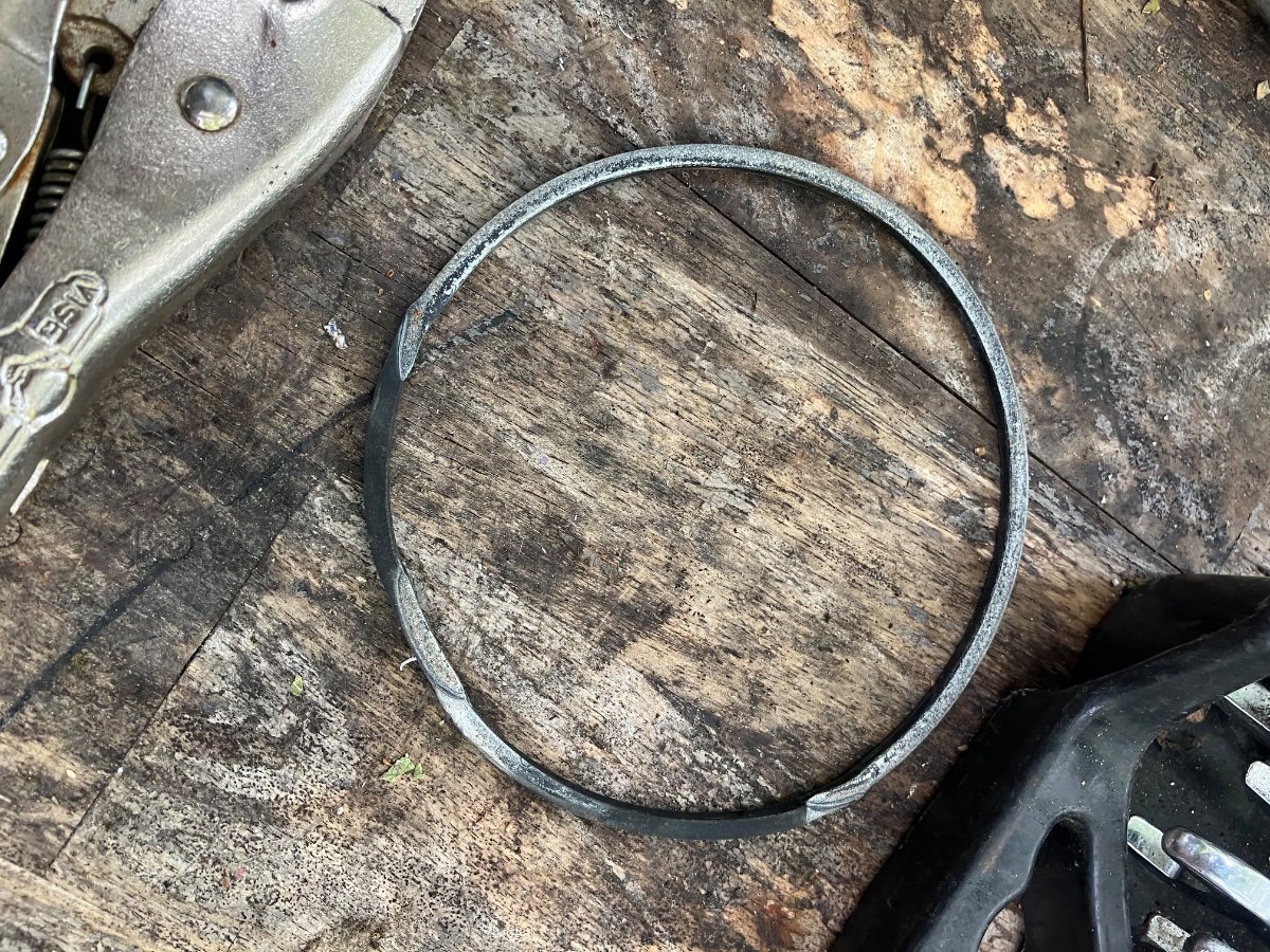

The fill neck was like brand new, so that wasn’t the overflow problem when you filled it up. When I moved to the pump, that big square O-ring flat looking gasket that holds the pump assembly in place wasn’t installed properly, and there was a couple little places that weren’t making a seal.
You can see the two darker spots where it was leaking.

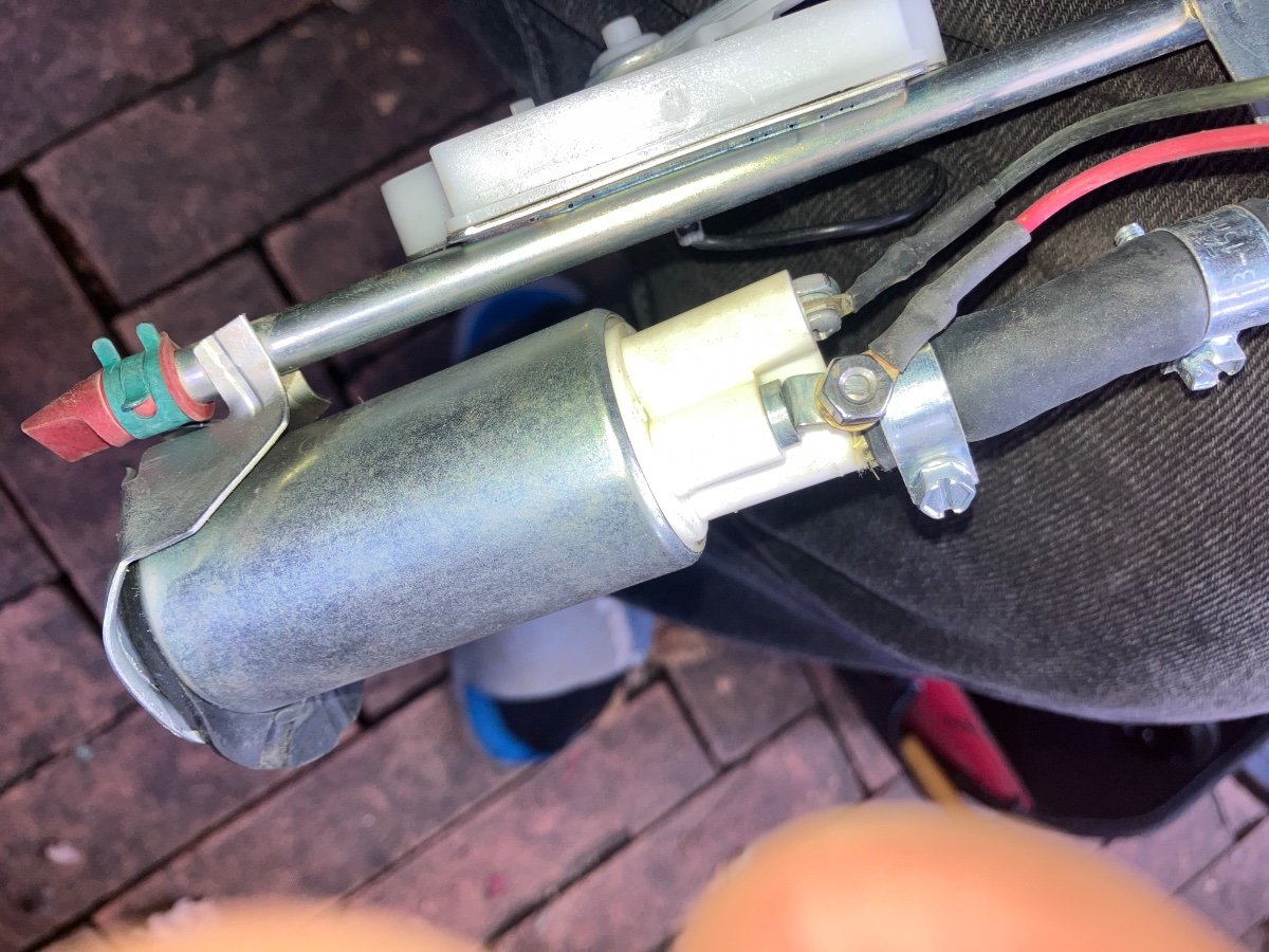

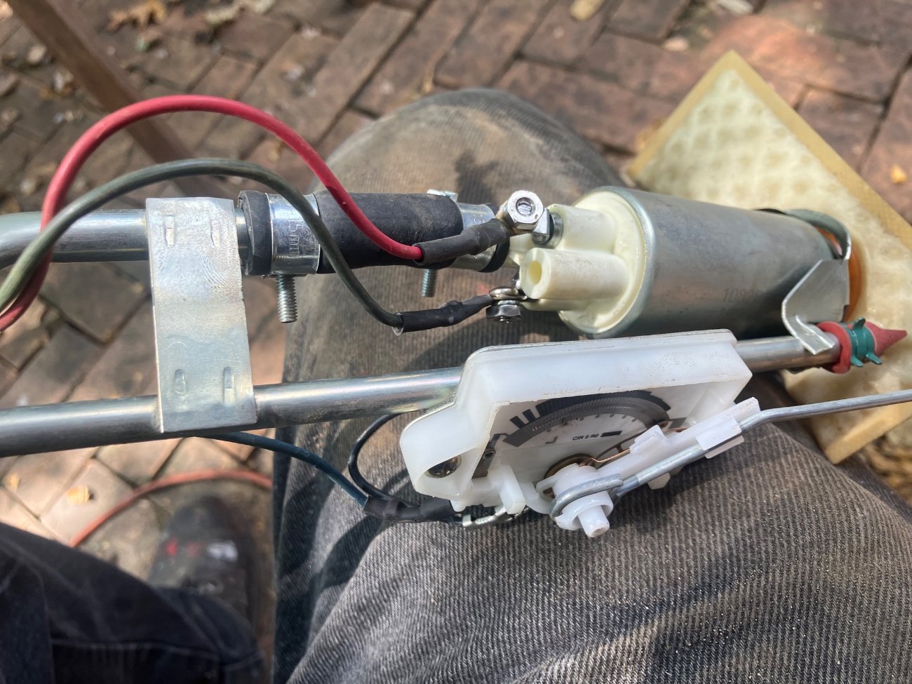

When we pulled the pump assembly out, it also looked like it was brand new. When Peter bought the truck, he was told that the pump was “upgraded” to a “Mustang” pump, eliminating the high-pressure pump between the tank and the engine. Well, sort of……
Upon inspecting it, I realized that the bottom of the whole assembly piece had been ground down, split, and this “mustang” pump was inserted in place of the correct Ranger low pressure pump. Looking at the TRS info and also some other sources, I believe this is a holly 19–360 high-pressure pump.
Here’s where we need help. I’m leaning towards just buying the correct pump assembly for inside the fuel tank. Peter apparently also has some level gauge issues, and I think just buying the correct assembly may solve several problems.
However, when the magician put the mustang/holly pump in the fuel tank, he apparently assumed the high pressure pump (on the frame rail under the driver) would no longer be necessary, and removed it. You can also see a relatively new fuel line was run from the tank right up to the fuel rail in the engine. A flow through fuel filter was added underneath the protective bracket that runs off the frame apparently where the high pressure pump was located.

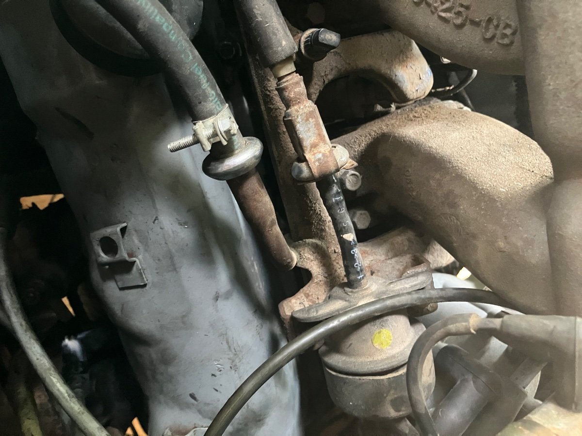

Finally, could anybody provide me some detail on how this fancy relief valve on the fuel rail operates? I know the high-pressure fuel goes into the rail, and this gizmo is what maintains the pressure and releases extra fuel to the overflow back to the tank. I think installing the high-pressure pump correctly may solve all the problems, but I’d like to know how this gizmo operates, just in case, for when we’re under the hood again if installing the pumps doesn’t solve the problem.

The original pump wiring was just split from the the one wire coming out of the inertia switch.

Order a sending unit for 86. That pump looks just like the one for a 90. It should have a strainer on the bottom:

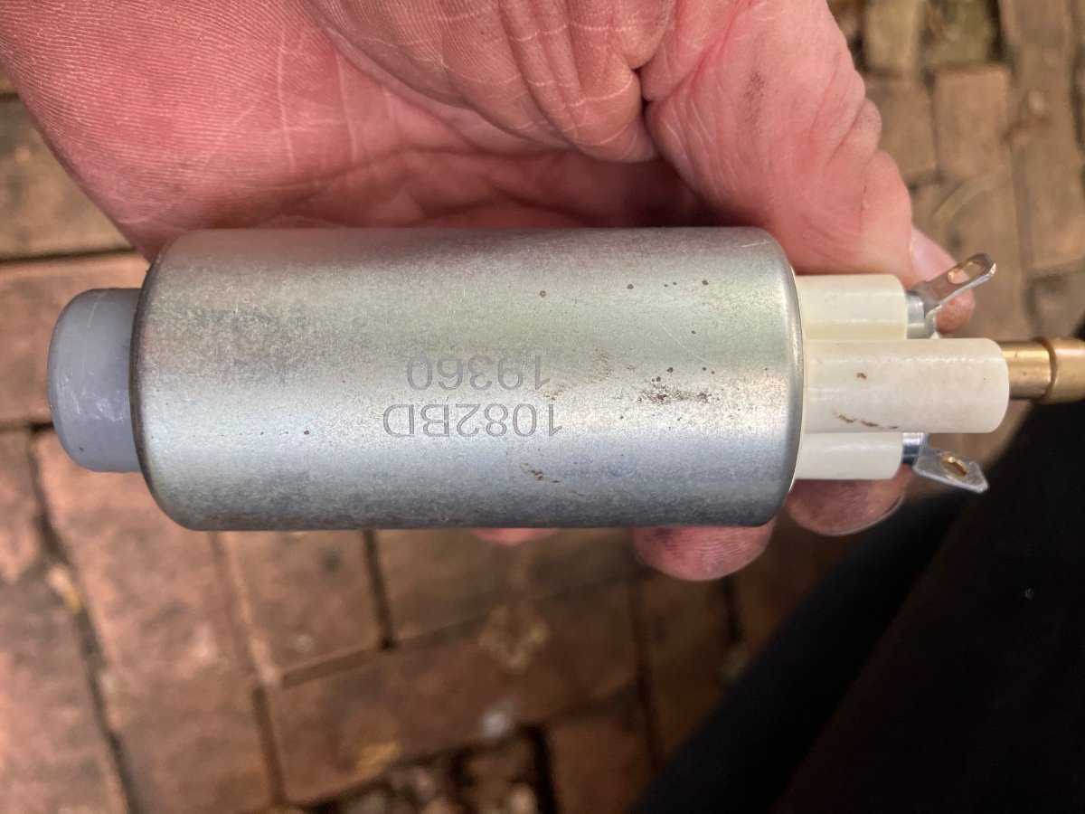

The only 1082BD pump I found is listed as for a Hyundai Sonata.
Nevermind. Here is the exact pump:
Haynes diagram for 86 shows power from fusible link "R" or "L" depending on date of manufacture to yellow wire at fuel pump relay. Then Orange/Light Blue out to inertia switch as in diagram above.

Update: had a little more time today to evaluate this 86. The power steering pump looks new, new water pump, new wires, cap and I assume rotor, the gas tank is new, the cobbled up Fuel Sender pump assembly is new, the transmission looks new, and that’s just a partial list. And all of that work looks like it was very well done, very professional.
Not so much the fuel system. The fuel system is a different story. With the crazy in tank set up, the lines up to the filter, and from the filter up to the fuel rail are kind of installed half-assed. Very amateur sloppy work, doesn’t fit in with the rest of the work on that truck. I counted four lines of different materials some slipped over the other and held in place with little hose clamps. The whole thing was flopping around inside the frame and I noticed two spots where there were critical gas pressure fuel lines rubbing on part of the engine and on the edges of the frame. I figured we could either straighten out and correct the lines, or maybe I could just add a spark plug with a button on the dash so Peter could turn it into a rocket ship anytime he wants! Again, appearance of that work did not fit with anything else that’s been done on the truck, so when we fix it, we will also make it look pretty too.
