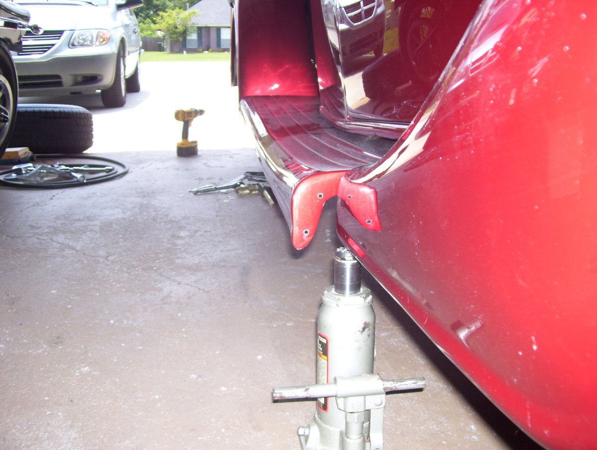

Hey Dg, I have been working with moving the cab around and had another quick question. How much space do you have between the bottom of the cab and the top of the top of the lower part of the fender and running board? I have seen some with about 1/4" gap and some with a 1"+. Thanks
Due to the meds....I didn't pay close attention to the gap between the bottom of the cab/fender/running boards....I've got 1/2" at the front & flush at the rear!
I should have put temporary spacers between the cab and running boards to keep the gap the same along each side of the cab as I attached the running board & support braces to the sides of the chassis!!!!!!!!

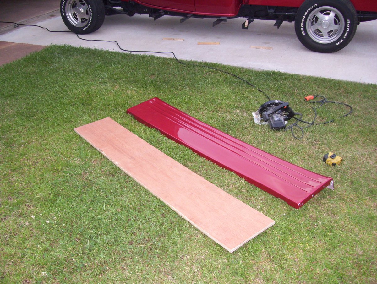

So....you could make the gap any amount that suits you......heres a pic of the support board that I arched to fit under the running board...then I attached the running board supports to the chassis (in the background)
NOTE; THE PICS ARE MISMATCHED....BUT YOU GET THE IDEA............you can see all the braces for the running board sticking out from under the chassis.
I MADE THEM LONGER THAN NECESSARY SO I COULD FIT THEM TO THE UNDERSIDEM OF THE RUNNINGBOARD......
also...the supports are bolted on/each at the height needed so the curved runningboard would fit solidly onto the braces and also it would follow the contour of the cab************

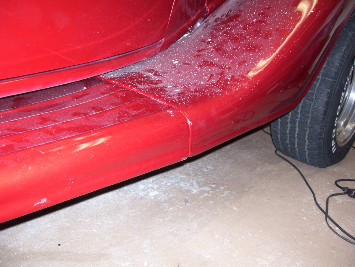

The running board is set in place.....

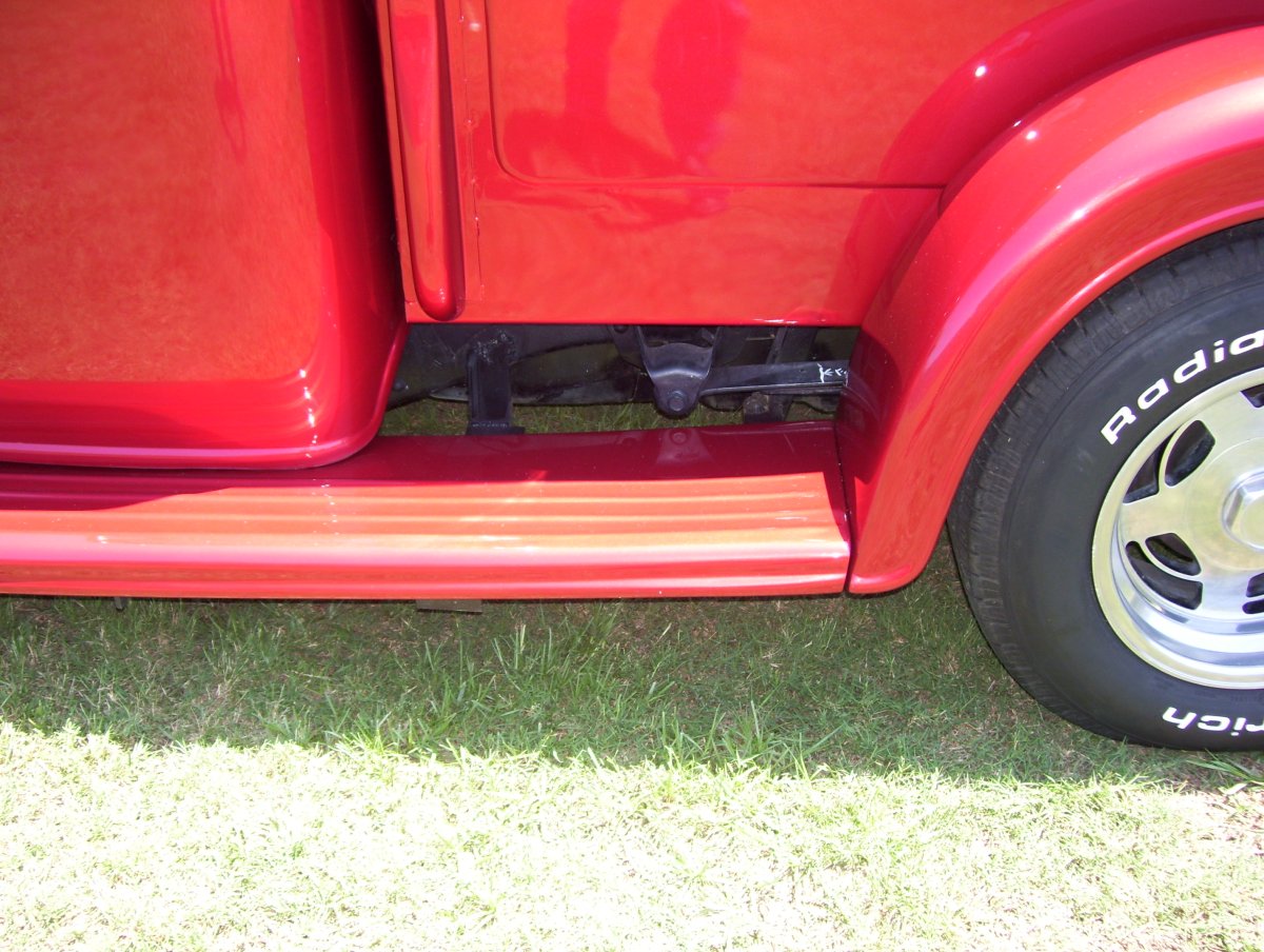

About 3 hours later.....the fender is bolted into place.....
This is the point that I should have shimmed the cab mounts/&/or/running board to get an even gap
I like the idea of the board under the running board. I guess you bolted it to the brackets and the running board is just sitting on top. Did you do anything else to secure the running board to the truck other than at the ends where it attaches to the fenders.
remember....I arched the board to fit the bend in the running board annnnnnnd I brushed linseed oil all over the board several times to keep it from rotting...yep it's bolted to the supports which helps hold it's shape too...I started to glue it to the running board, but couldn't....it fits down good on the board good and real tight between the 2 fenders.
