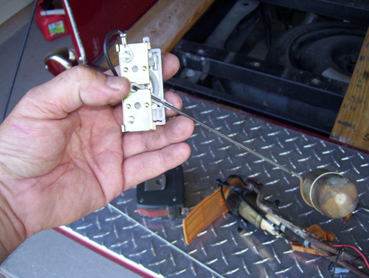

Sending unit is did.......again..(even though there was only 50 ohms difference between the OEM sender & the aftermarket sender, the gauge would not go down to empty--even if I was sitting on the side of the road thinking that I still had 1/8th of a tank of gas left...LOL).....

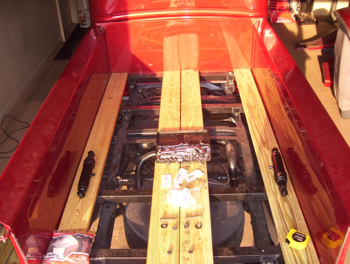

diamondplate is jacked aside.....

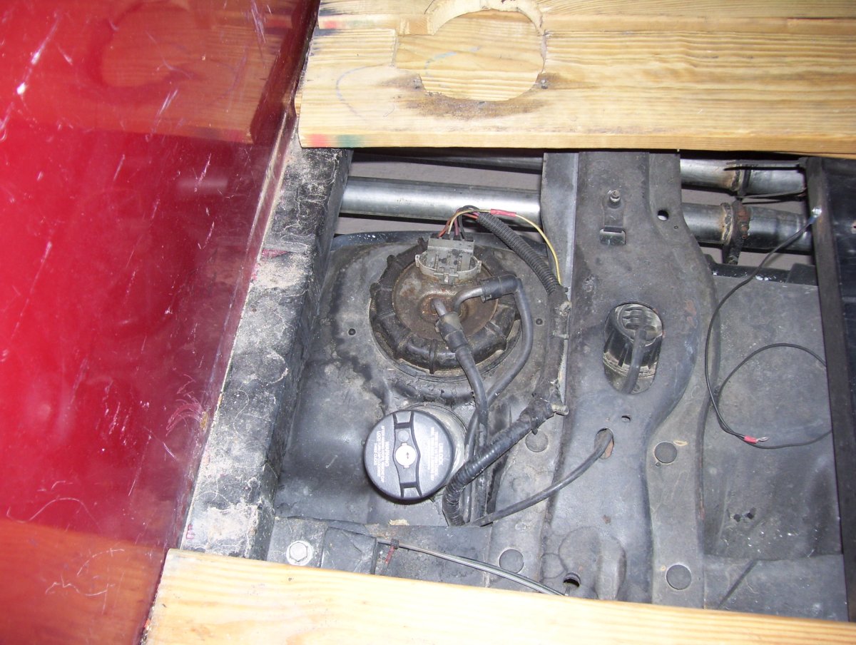

boards are removed.....
Rheostats are swapped between OEM sender & aftermarket sender.....the white rheostat & wire lead came off of the aftermarket sender that matched the dash gauge from Classic Instruments...it was easier to do it that way so I could keep the OEM plumbing & pump intact.....

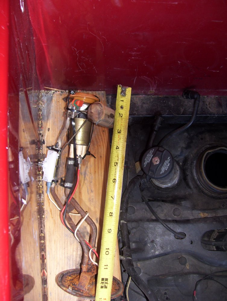

I measured the depth of the tank & bent the float rod to make sure I had about 3 gallons left in the tank when the gauge showed Empty....
I bent the rod a little more to get 2"s clearance between the bottom of the float & the bottom of the tank after this pic was taken.....
time to cipher...... ought from ought = ought/ought X ought = double ought........1" = 1.3 gallons/2"s = 2.6 gallons
n-o-o-o-o-o-body will evvver know.....total time....one hour!

yep....I even did an ohm test on the OEM Ranger sending unit & it was within 50 ohms of the aftermarket sending unit that came with my aftermarket dash fuel gauge.
I thought 50 ohms wouldn't make any difference.....BUT....it made a 1/4 tank difference....the tank was empty, but the dash gauge still showed nearly 1/4 of a tank of gas left.
After removing the OEM sending unit carefully with a dremel tool & installing the new aftermarket sending unit , the dash gauge reads accurately....I also bent the float rod so that the bottom of the float stopped 2"s above the bottom of the tank.
I have driven the truck & used the tank of gas until the gauge needle just touched the empty mark...I gassed it up & it took 13.1 gallons....which means that it still had 3 gallons left in the tank...which would get me 60 more miles after it shows empty....since it gets 21 mpg now.
