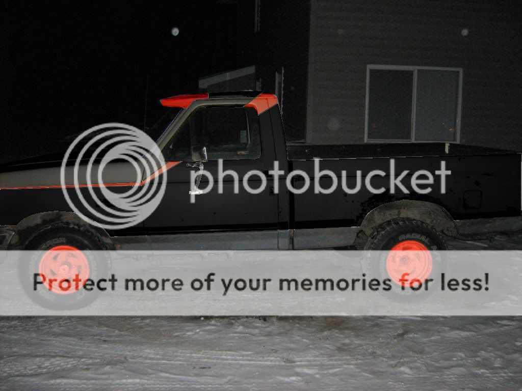

hows this for a chill retro 80s paint...
Just Plain  Stupied

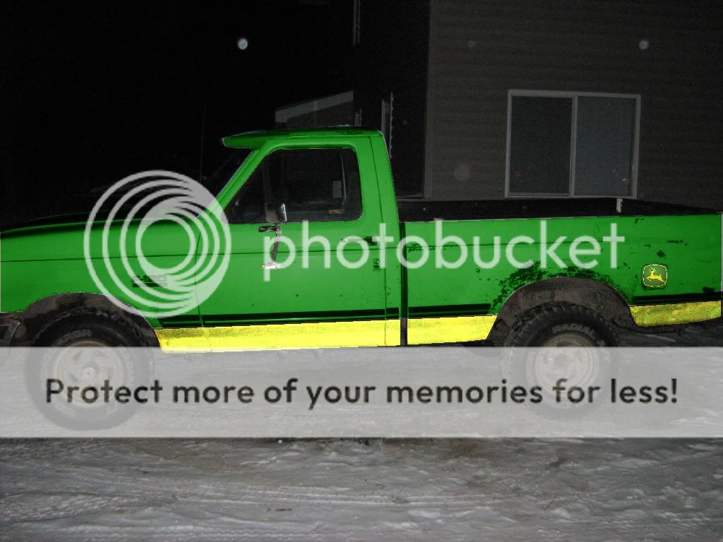

and da Deere
Just Plain  Stupied
Mikes does good work eh
