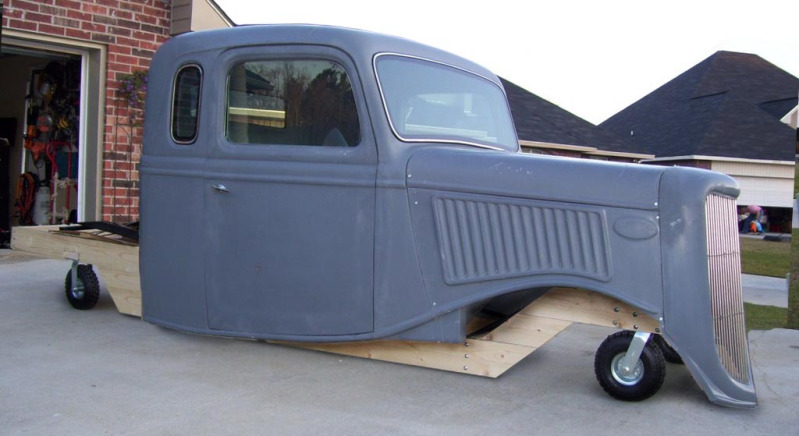

Been sliding and moving things around and came across a concern. I think the previous owner may have trimmed the hood and sides a little shorter. DG could you measure how long your hood is in the center at the hinge, and also on the side where the beltline is? Thanks

I also cut my hood(s) so the grill would have more rake at the top....
centerline length is 29 & 1/2"
side at latch/felt-line is 37 & 1/4....your hood can be longer....but it cant be shorter!!!!!!!!!!!!!!
It's not a disaster if the hood has been shortened previously....
you install the radiator main support hoop and hood bracket-----
install the rear hood support(bracket)-----
set the hinged hood in place---
trim the rear edges of the hood to fit the firewall shoulder where the rear of the hood rests----
adjust radiator-hoop until hood hinge-brackets bolt to front & rear hood supports---
temporarily bolt grill into place---if grill doesnt fit flush against the front edges of the hood---you CAREFULLY trim front edges of the hood until the grill fits flush...

It takes a few hours to get it to match---use a black marking pen to mark the front of the hood where it needs trimming...
I hope that makes some sense....once you start doing it...

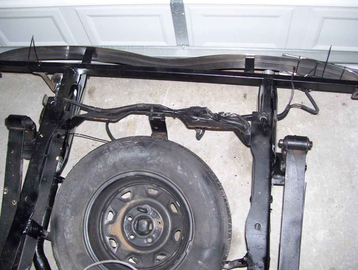

the OEM clutch/fan is removed & flexfan is installed so radiator can be moved toward the engine 2".....

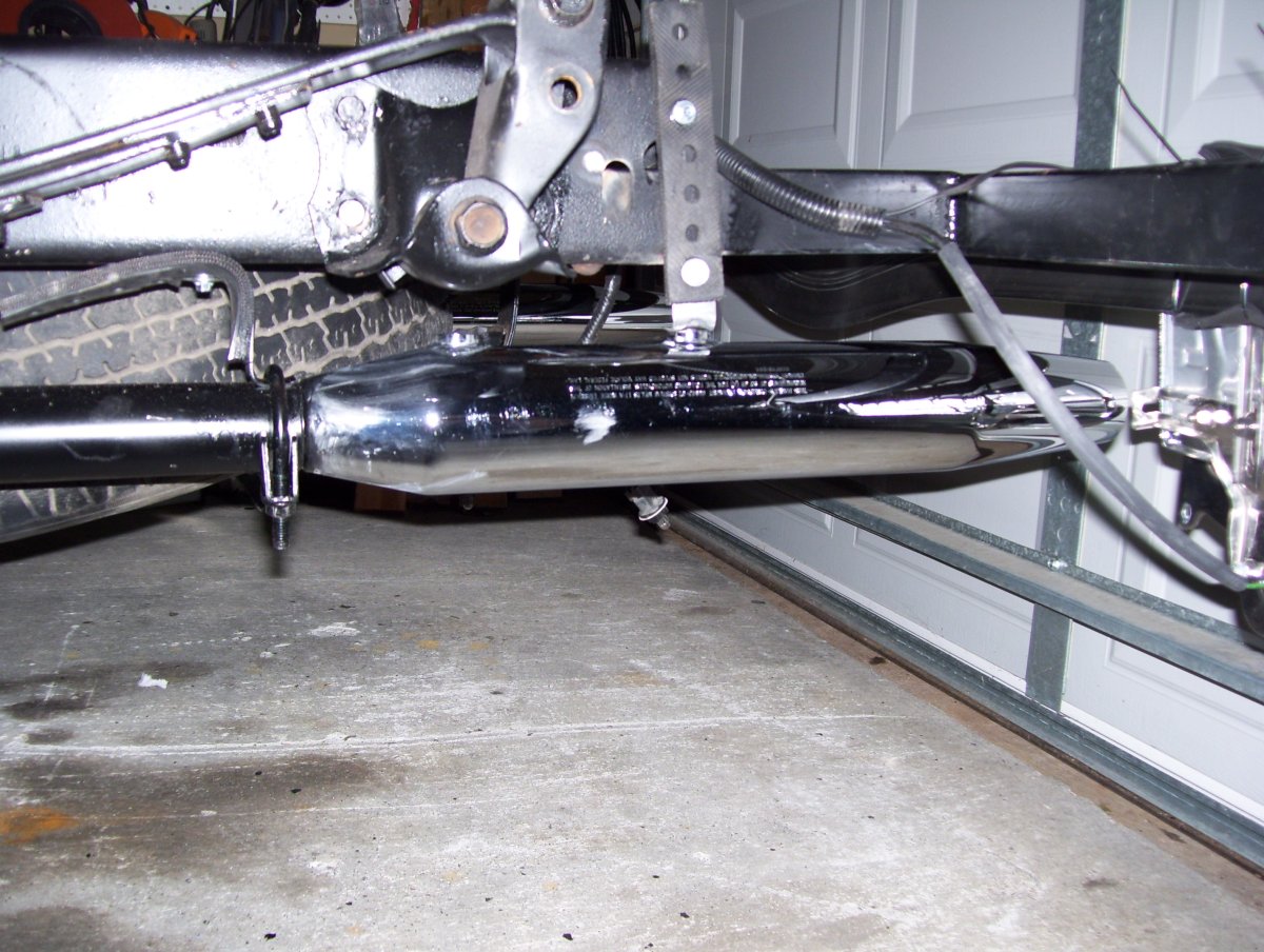

The flipped rear hangers get the difference split from the OEM hanger set-up...I dropped the hangers to the lower bolt holes on the frame--added a brace under the frame-rail for the bottom bolt-holes of the hanger to attach to....

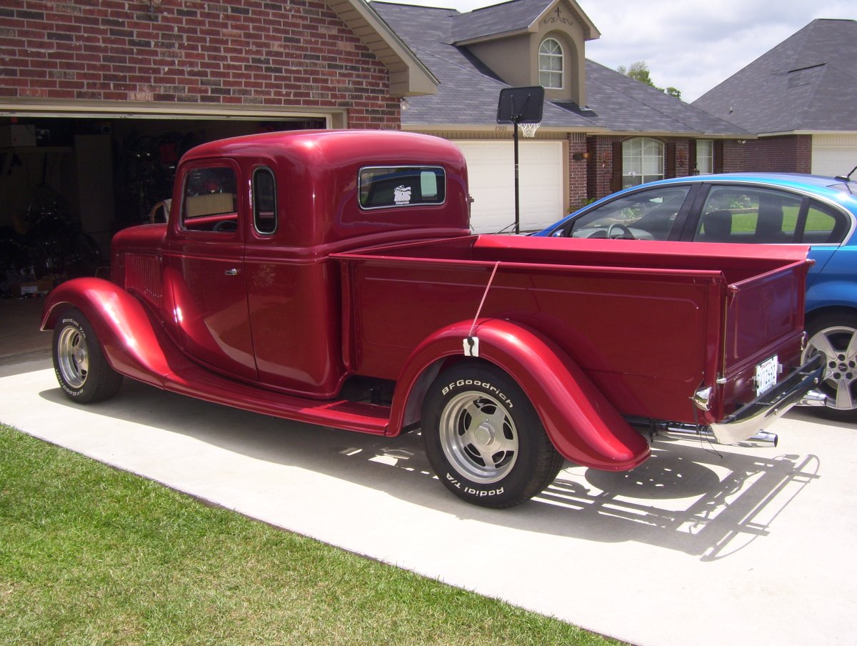

the truck no longer is level....the rear is 2" higher than the front end....
Now I gotta do the passengers side rear hanger mod.....

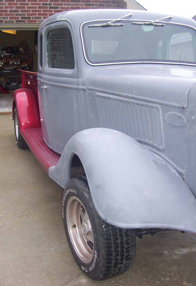

Edit: how bout that 4X4 stance/chassis is still at oem ride-height with modified body bolted down.

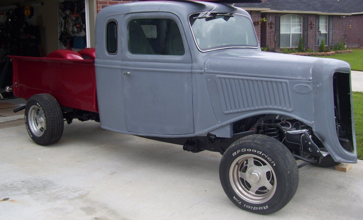

It's easy to see how high with the front fenders installed.....it lowered another inch when I installed the engine/trans.........but it was still 5" above the front and rear tires.....
The pics above is the OEM stance.....
The pic below shows the gradual changes I made to the stance in the last year..... the front and rear fenders sit level with the tires.......
The rear fender arch is now 2" above the rear tire...it is no longer LEVEL with the rear tires....the front fenders will remain level with the front tires for the raked look........

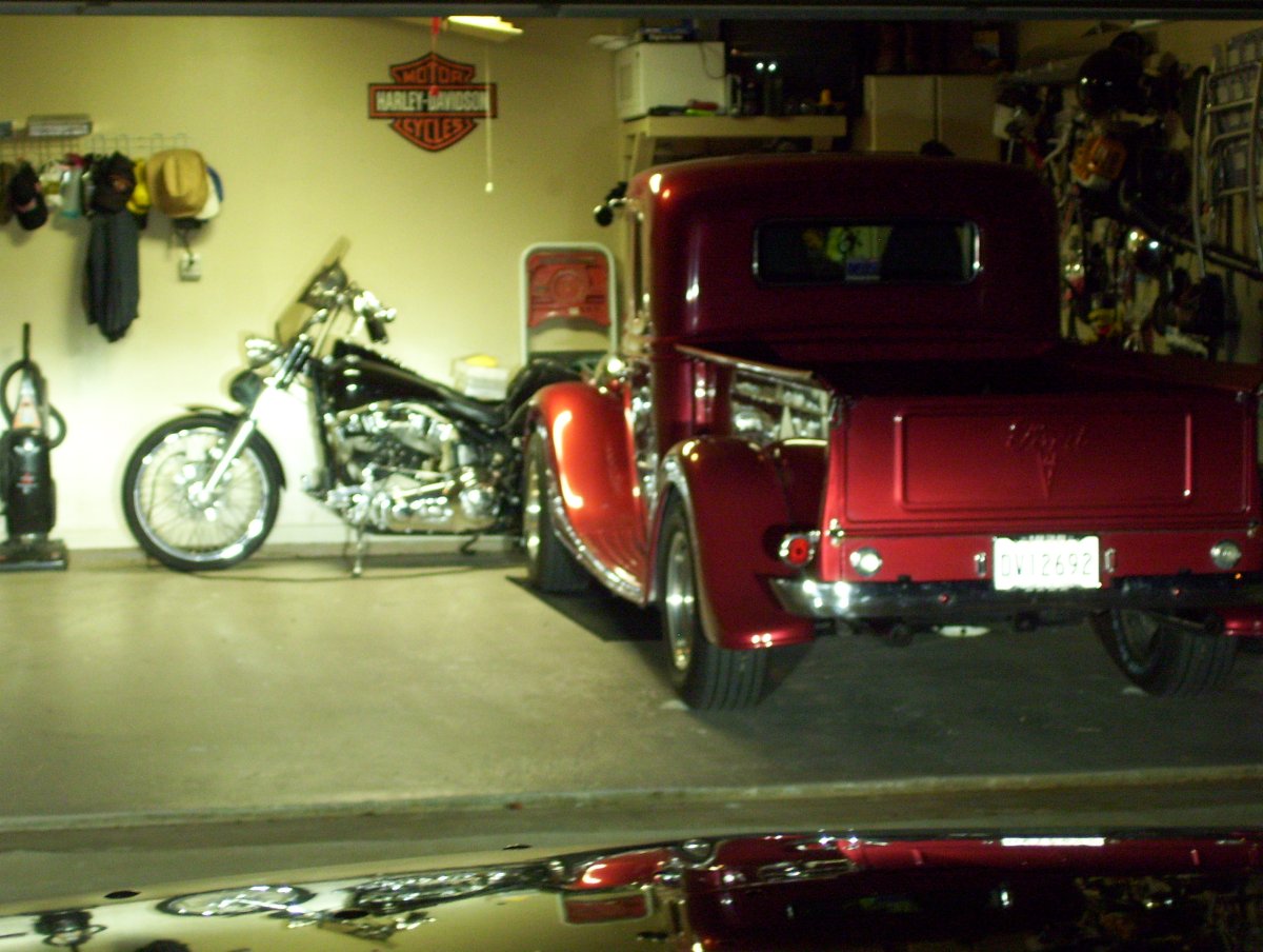

now i got 1 for u.....
HYENNA !!!!!!!
