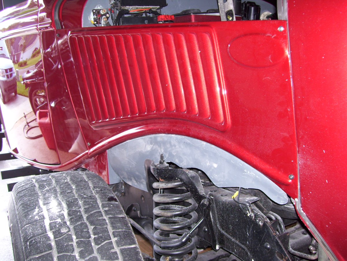

gregs______bad news first---you have to set the cab at the height specified in the instruction manual to get the front fenders to clear the steering box.......I STILL had to notch the fender & inner panel to clear the corner of the steering box.....
OOOOOPS....wrong side of truck...but the gray panel got notched on the driver's side to make room for the pump......

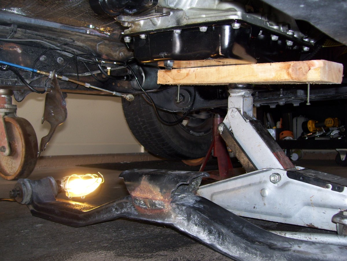

block the cab up on the chassis using 2 x 4's...it'll look too high, but it'll work out just fine....get the body square with the chassis measuring from the outside edge of the body to the chassis on 4 corners....and from the bottom edges of the firewall to the OEM alignment pin on each frame rail....

good news is.......if the driver's fender has plenty of clearance over the steering box once you have the radiator support & grill in place....you can lower the cab on the chassis until the fender lip is about to rub on the steering box, or do what I did---lower it too much & have to notch the fender lip in the pic above.

Let me get some pics.......you can see from the passengers side frame rail that there's only about an inch more the fender can be dropped before it hits the modified frame rail....(you could chop off more of the passenger-side frame rail to lower the fender/cab...but you'd definately have to lower the steering box an inch or 2 first!
