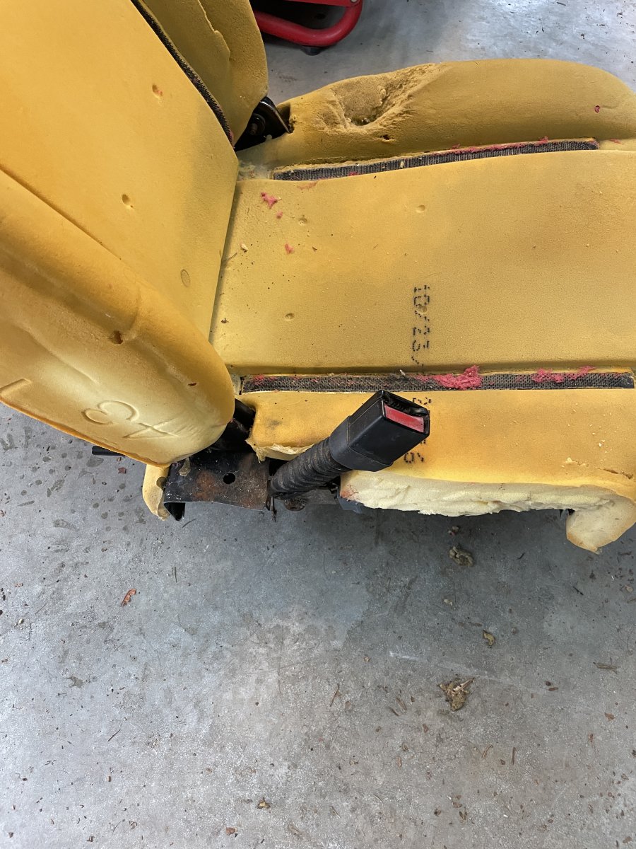

  1. The driver side seat is so destroyed any trip over 15 minutes is painful (I’m over 60 with back issues.)

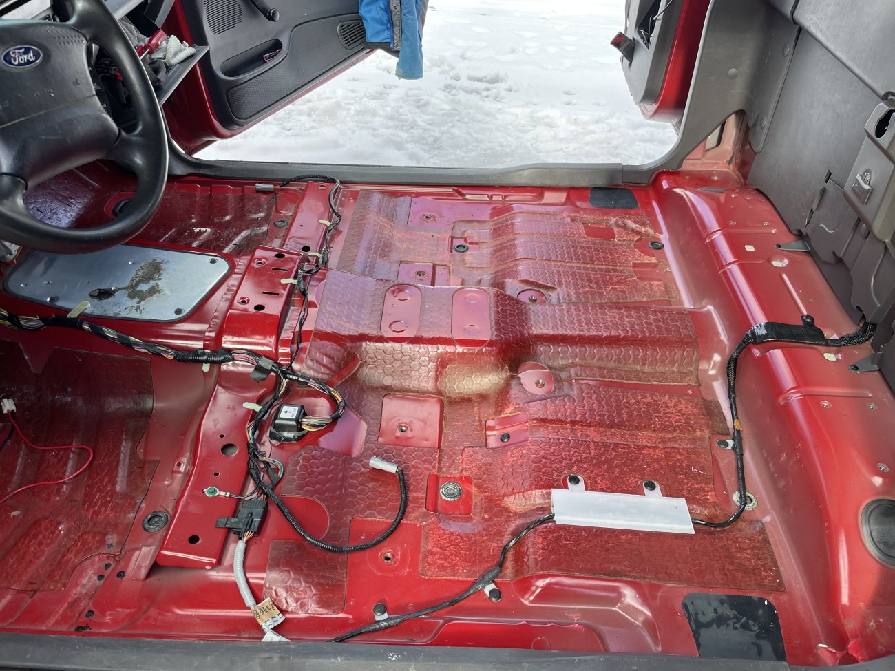

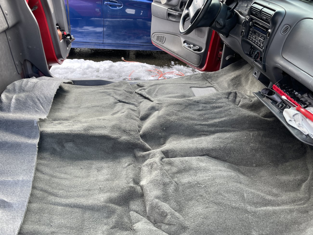

I bought new molded carpet and sound deadener from LMC. I have laid the carpet and cut it to size. The sound deadener arrives tomorrow. I want to run audio interconnects and speaker wire while I have everything out and I hope to have a new head unit FM Stereo/Car Play/Nav/Camera to replace the old OEM unit. No rust – one small dent I can pull myself and shoot myself. I rebuilt a couple vintage Mustangs in my youth, worked on a few friend’s street rods (for us) so I have some idea and means for doing this stuff. My biggest need wrt to this post, is advice on where to buy a replacement drivers side seat, I don’t mind buying new, I just would like to know if there is a new bucket seat out there with minimal welding customization requirements. What head unit you might recommend. How you would address the bedliner delam. What would be the first thing to check wrt AC problem. FWIW I had my mechanic “fix” it a couple years ago. He charged me nearly $500.00 for what I think was a AC service, which didn’t change a thing. I hope one of you can point me to audio head unit the fits without a whole lot of alterations to the dashboard. Apologies in advance if I have violated any forum rules or etiquette.

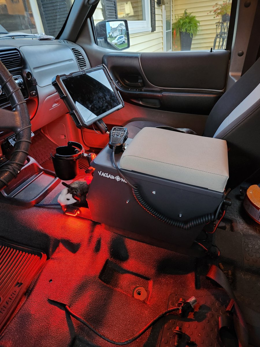

I did the 60/40 to bucket seat mod... not perfect but my seat was in good shape and works fine. I did a smittybilt securoty console... more utilitarian then refined... but totally functional for my needs.

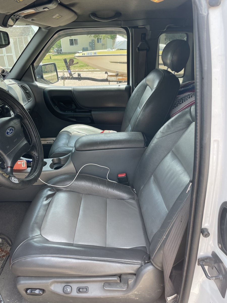

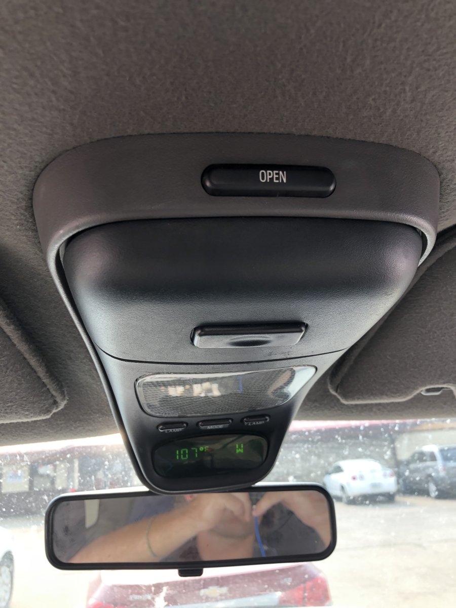

My seats, center console, and overhead console are all out of an Explorer Sport Trac. I followed the guides on here. For my seats, the wiring diagrams didn’t match my color wires, so I just connected them to my battery and tested the controls to figure it out. The center console, I never bolted it down to the floor and it’s been fine for over a year. There’s also a writeup somewhere in here that teaches how to use the explorer rear view mirror to wire in auto headlights which I also did.

Explorer console is definitely doable. There should be a few trhreads and write-ups on it around if you figure out the right search terms. I've got one waiting to go into my 99 as well.
Seats... I definitely understand wanting improvements there. Sounds like your DS seat is slap worn out from use over the years.
Do you like the stock seat other than the wear? Sounds like you are handy enough to disassemble and reassemble one. If you like the style of the stock seat, find another PS seat, swap the foams (and covers if needed) over to your DS seat frame.
If you want something completely different, your imigination and fabrication skills are the limit. Most other extended cab Ranger seats, at least mid 90s-2011, will bolt right in. Explorer (and ST) seats up through abourt 2001 can bolt right in. Almost anything else can be installed if you can adapt them to your existing tracks and/or mounts.

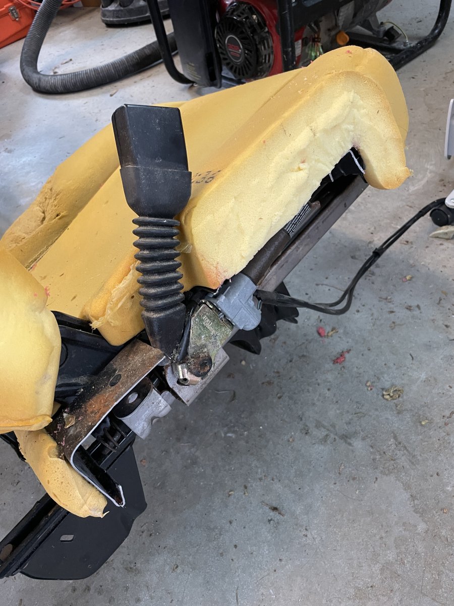

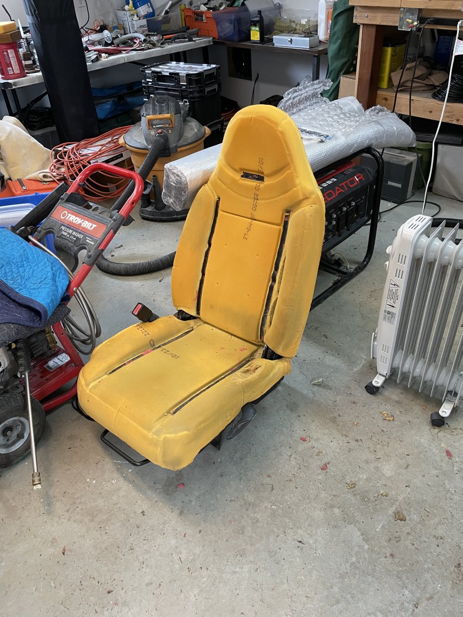

I don't mind the stock ranger seats, but I would much rather have a center floor cosole. I've never like the 60/40 seats. My back is in pretty rough shape, would be nice to have some lumbar support. I've started the conversion process for a center floor console. I hadn't thought about pulling the foam from a passenger seat. I would still need to either repair the old cover or find a replacement. I can handle just about anything, but I don't sew. Lots of a good ideas - thanks!
Back foams will be the same, covers should be too if you can find in the right color. PS side stuff is usually in a lot beter shape than DS.
For the base the foams should swap straight over. From past discussion, I was under the impression that the driver side seat pan was the same as a passenger side seat pan, just with an extra pieces added on for the center seat and arm rest. Remove the extra pieces, and pop on the PS foam. Covers are about the same too from my impressions, swap the PS cover over to the DS and pop a hole in the side for the back adjuster. Thinking about it there might be a decorative piece that hangs down on the door side of the seat to hide the tracks. That might be missing if you put a PS cover on a DS.
I could be way off base there. I'm going from old memory of past discussions.
