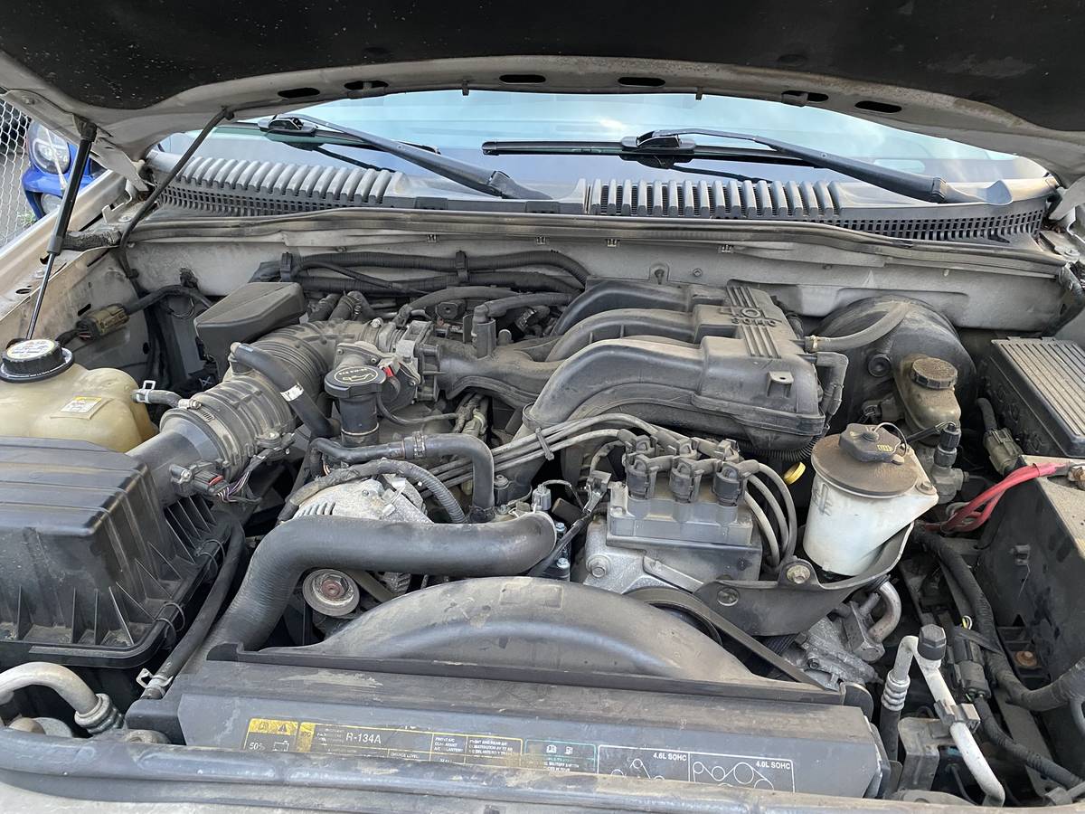

Spoke with the shop that has performed most of the service work on the Explorer. They haven't opened the engine up to diagnose the knock. It was said that the owner discovered the knock one morning after sitting overnight, turned off the ignition and had it towed to their place. They listened to the knock and said they would need to pull the engine to properly diagnose and the owner, given the cost, neglected to have them do it. I’ll have them start it up for a few seconds so I can record the noise, and I’ll post it to the thread. If it doesn’t work for my Ranger replacement, I’ll survive. I could leave the interior alone and rebuild the 4.0L, maybe end up with a backup to my backup… That’s why I come to this forum, to learn. I’ve attached some pictures of the Explorer.

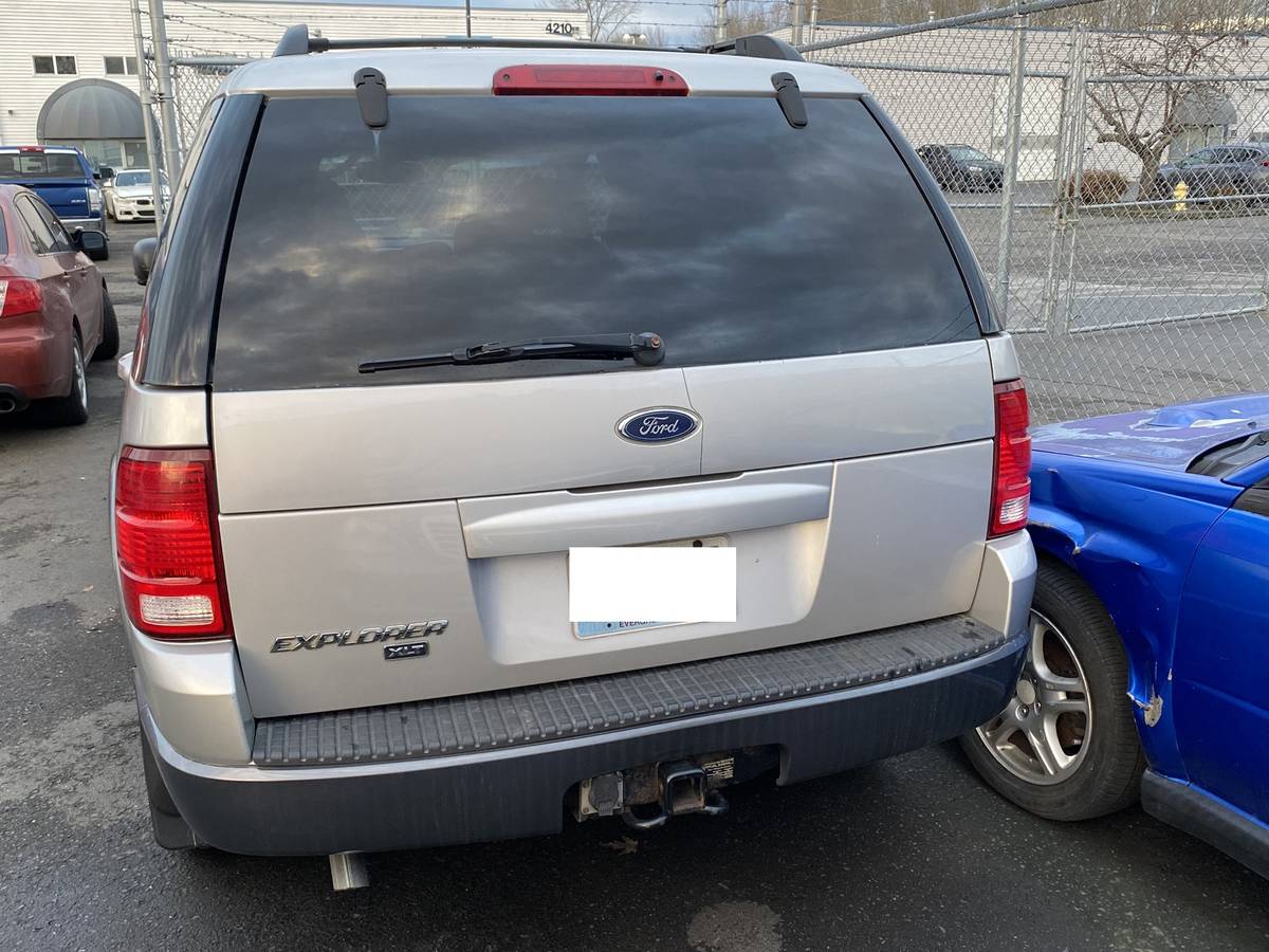

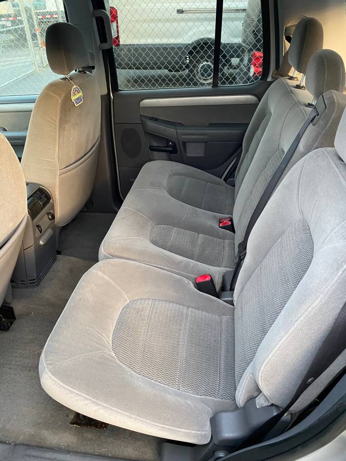

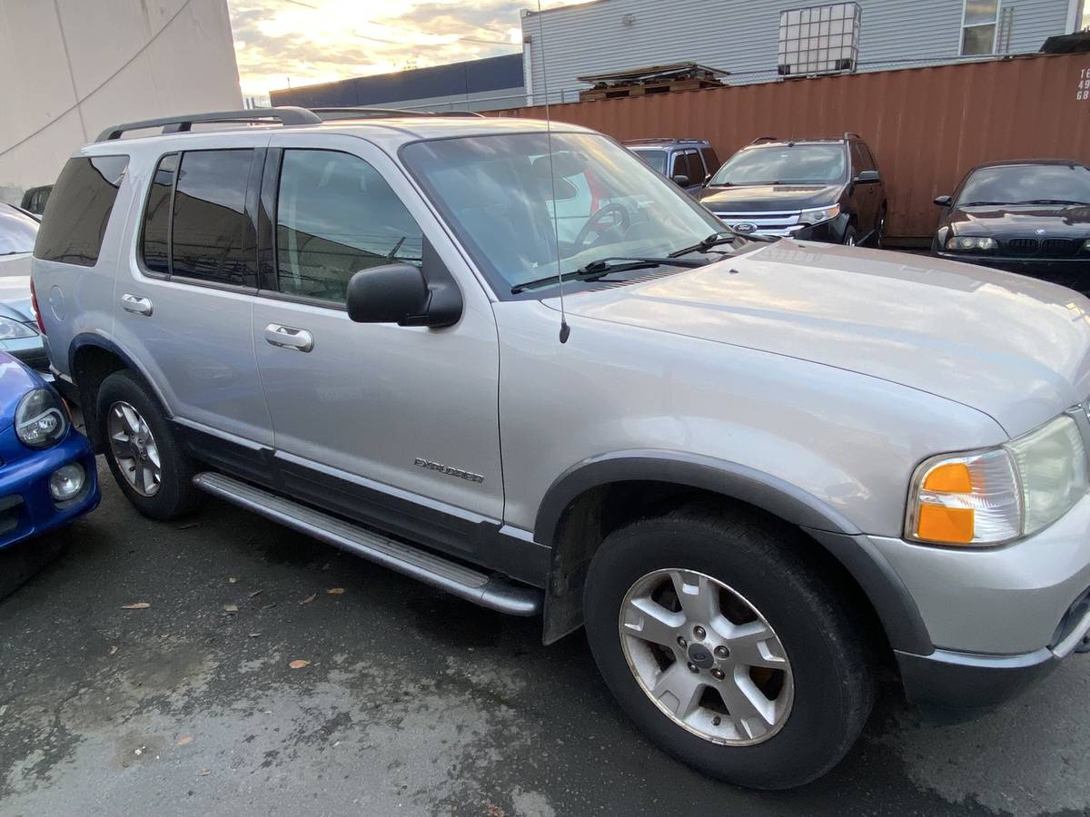

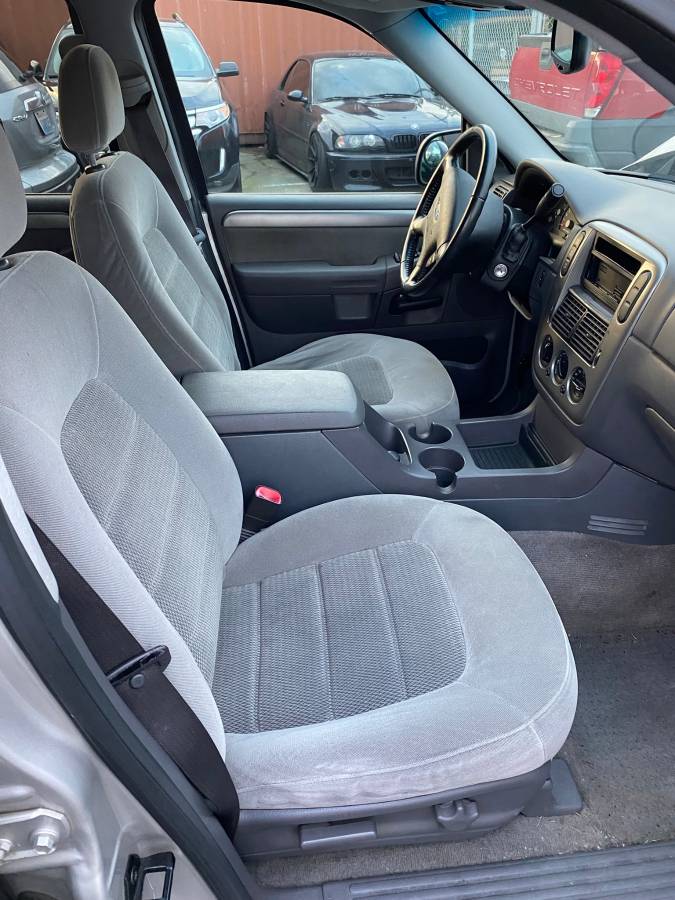

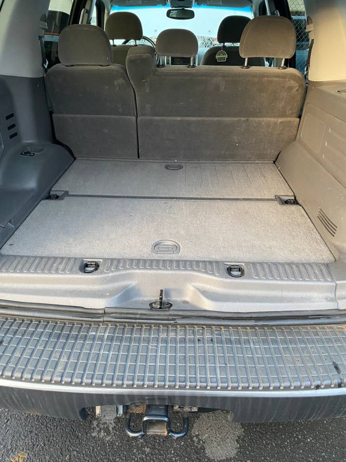

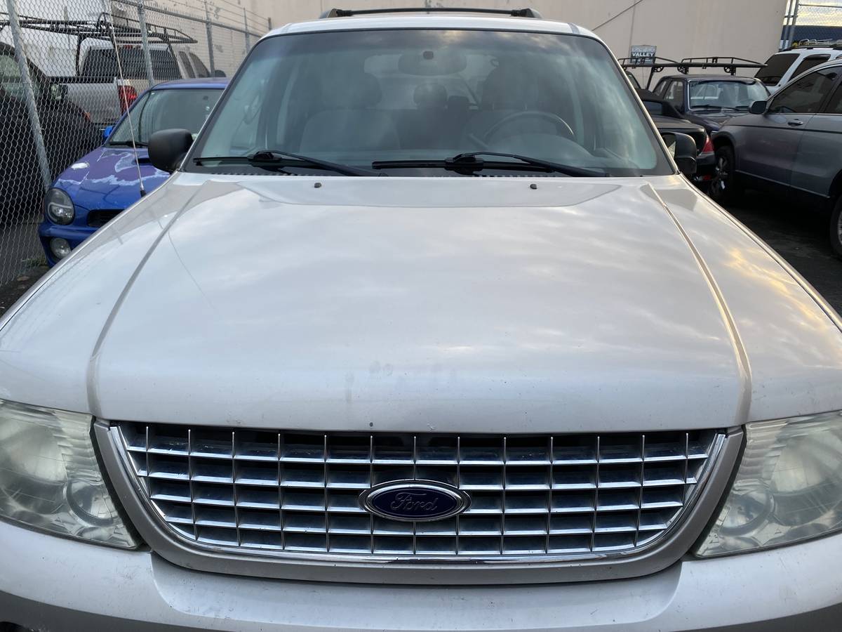

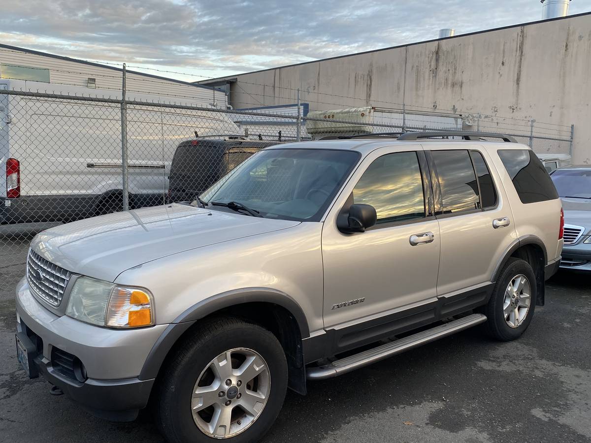

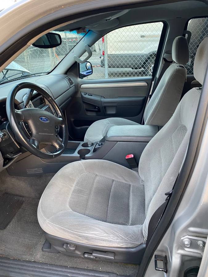

Man that's a clean vehicle, couple rock chips in the leading edge of the hood, no hail dents, excellent paint and body otherwise. Nice find.
I suppose I could get really really ambitious and swap the engine, tranny, transfer case and front at rear diffs! Did I forget anything?
Possibly... Mostly the fact that those are IRS, so you won't be swapping that rear axle/diff into the Ranger. I'm not too sure if the front diff changed or not. You might be better off keeping your Ranger transfer case, it will bolt to the Explorer's transmission. At that time, both the 3.0L and 4.0L used the 5R55E, they just changed the bellhousing pattern to match the engine.
The previous generation center console was a better fit to the Ranger dash since it actually had the same dash. I think this generation of console has been used, but I don't recall how the results looked. Anything can be made to work with a little creative fitting and trimming, and some timeseven made to look good. At the price it's probably, worth it even if you pull the seats and scrap the rest. Even better if you do use other parts and can part-out some of what's left.
If you don't use the drivetrain, I'd probably suggest cutting out the cats and scrapping them separate from the rest. They are going to base scrap value of the vehicle on weight, and cats don't add that much to the weight. The precious metals in the cats mean they have a much higher value when scrapped separate. You'll gain more from scrapping separate than you will lose from the decreased weight. Look into the legality and complication of scrapping cats in your area to determine if it is worth the effort.

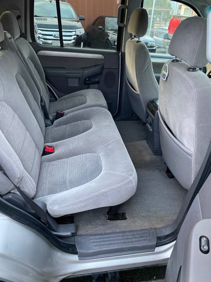

Edit: I have to admit, as a seat/interior donor, those seats and that interior do not appeal to me. I'd have to either fix and flip this thing, or pass on it and find different seats. Everyone's tastes are different.

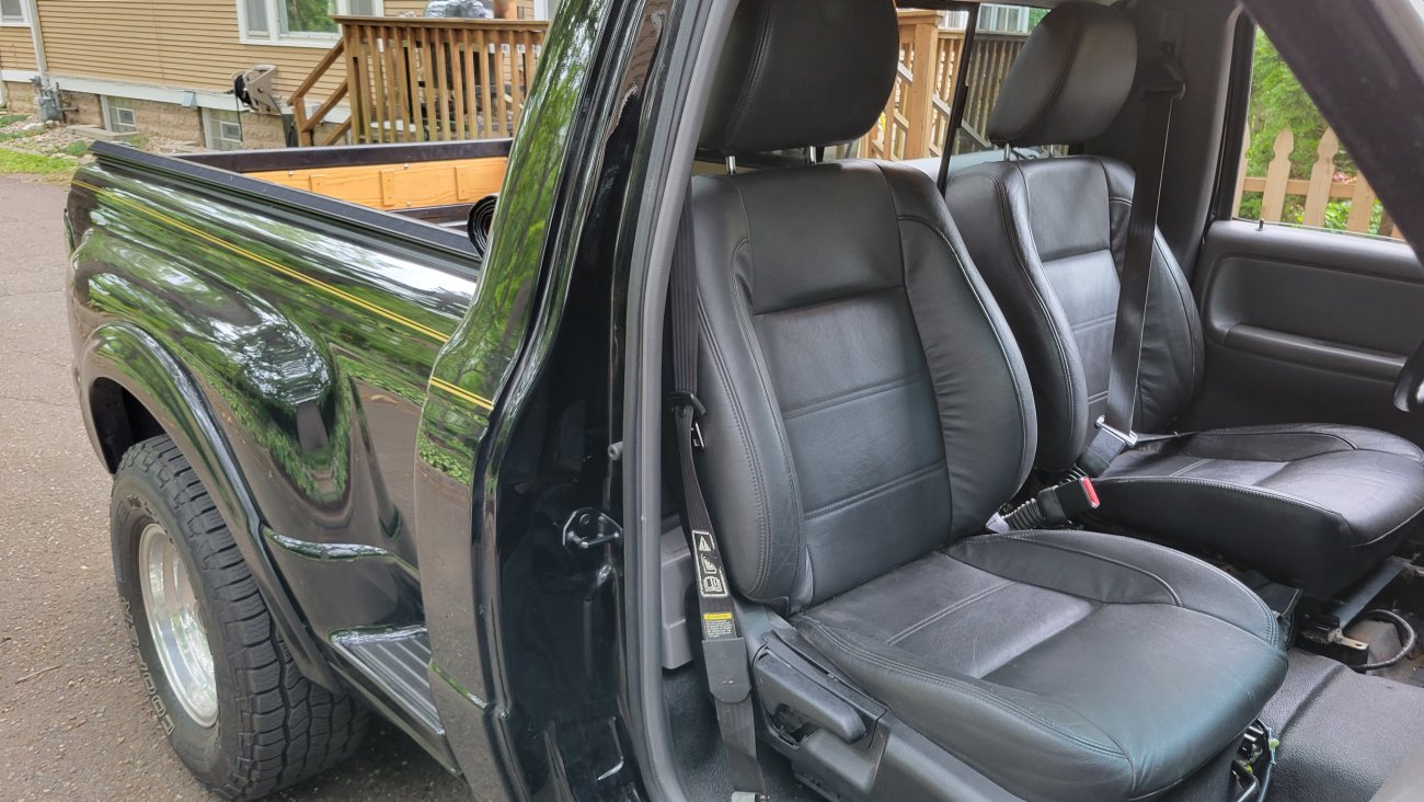

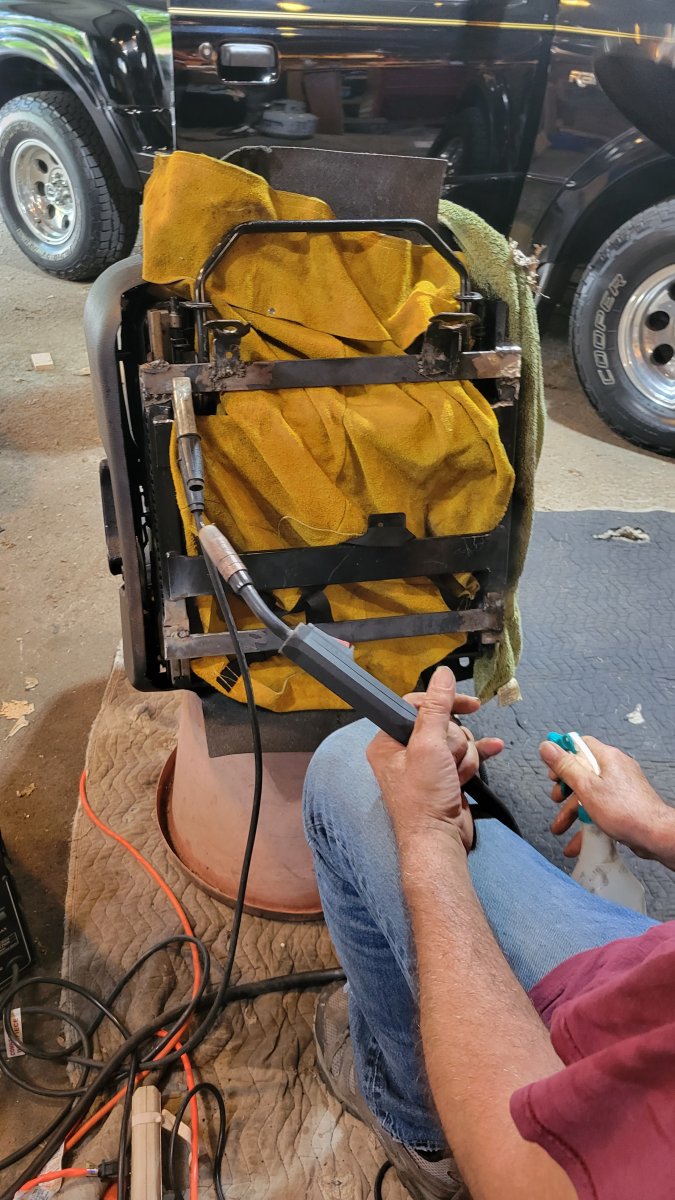

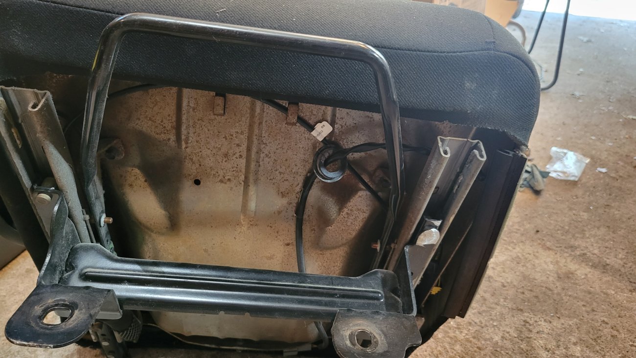

The old Ranger seats were nothing more than a slab of foam rubber inside a sheet metal pan. Just about anything is better than that. I bought two very nice leather bucket seats from an old Subaru. They were easy to install.
I cut the "feet" off the Ranger seats and welded them on.
It wasn't hard to remove the air bag units from the Ranger and reattach them to the Subaru. Personally I like leather. It's easier to clean and doesn't retain odors.
These seats look like they belong in a Ranger. The photo doesn't show it, but I did install a small center console/armrest.
I would consider stealing the seats out of the explorer to be ruining a pretty clean vehicle... If it was me (and again this is just me), fix and flip (or drive) the explorer (engine work) and find yourself seats out of a u-pull-it. As much as people say you "can" do 42 different models, I would probably stick with Ford AND find one with the exact same electrical connector.... but then again I have 3 cheap yards and can be lazy at the cost of being choosy. I get that location and availability play a lot more into it though.
