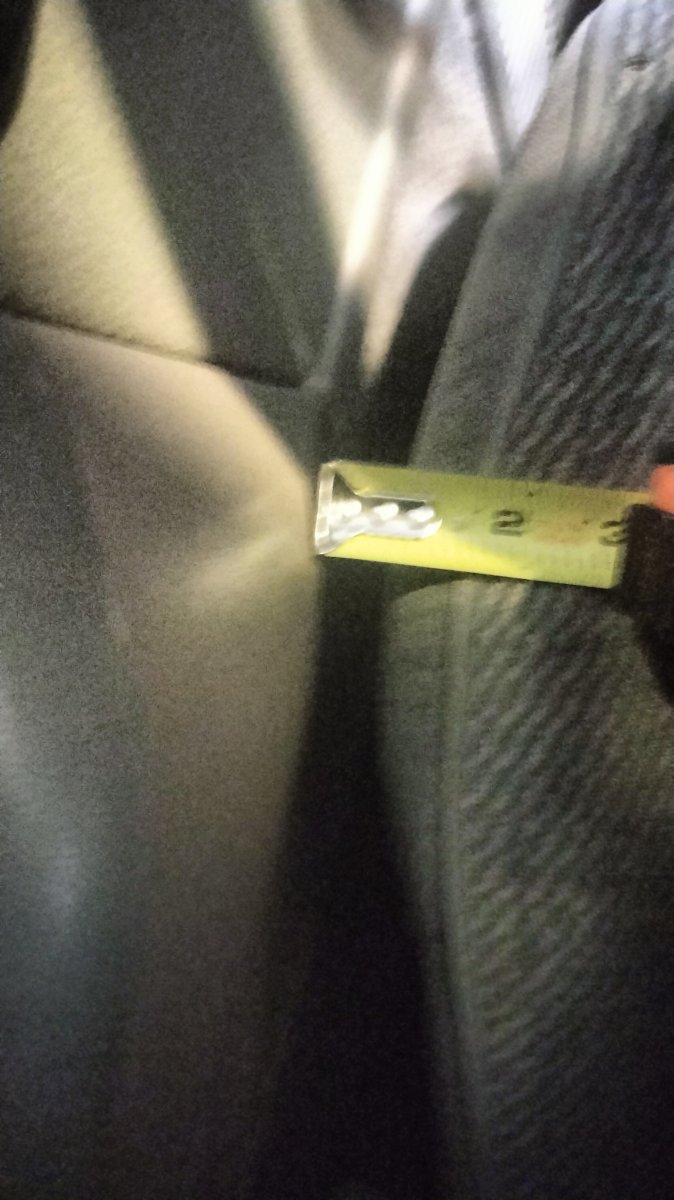

I gotta (very small) concern about the seats... and if you haven't finalized, now would be the time for others to chime in or check it out yourself... the seats got wider in 2002 I read repeatedly... is that too wide for 1st/2nd gen but perfectly ok for your need?
I really really thought it was in that tech article I quoted way back post #2... so I re-read it, 1 line above the 2000 explorer power seat wiring
"2002 and newer Ford Explorer seats are wider, and will not bolts up to the Ranger tracks."
I did not test anything relevant with that, I limited my search in the yard and found a 1995.
Only thing I did note myself is how close the door is to the seat bolster if you do it the same as I did (I fabbed new seat tracks out of ranger lower and explorer power electrics so as not to give up electric).
Interior upgrade advice - 2001 4x4 Seats
Sure it says that and they may be wider, but wider does not mean will not fit. They may not bolt up to the Ranger tracks, but again that does not mean that they can't be attached to them with some work to adapt them. Only way to know for sure is careful measuring of the parts that you intend to use and/or having the parts in hand and seeing what fits.
Most seats with removable tracks are effectively flat on the bottom. Seems like it should be possible to make an adapter plate assuming the width doesn't mean you end up with a bolt head halfway in the track...
And the explorer sports and sport tracs, that extend the year range by a bit. Up to 2004 I think
