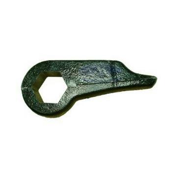

I ordered Torch Offroad's 1-3" lift using rear shackles and some new torsion keys. After reading some stuff on here I'm wondering if I just install the shackles and crank the stock keys. Here's where I really need some advice, What tires would work well? Is a 265-75-15 too big?

You can turn the torsion bars to raise it though
