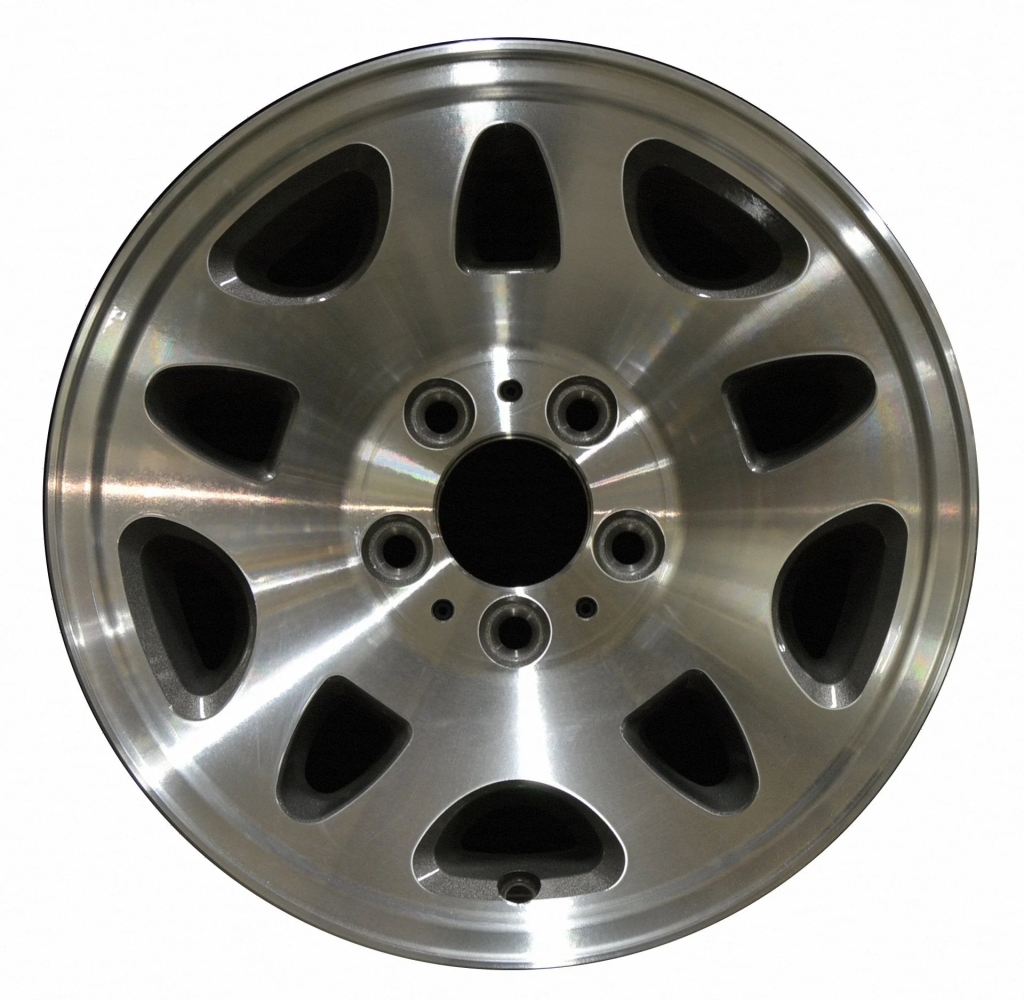

My 2011 came with 15" aluminum rims. The 7 spoke steel rims also fit. I haven't tried any of the other styles of 15" rims Ford has used on the Ranger. So, I can't say if they will clear the calipers or not. I'll get some images off the internet so you will know exactly which rims I'm talking about.

The wheels that came with the truck.

They looked like this, I liked the 16's better but the truck we had in stock with 16's had a bunch of options I didin't want.
