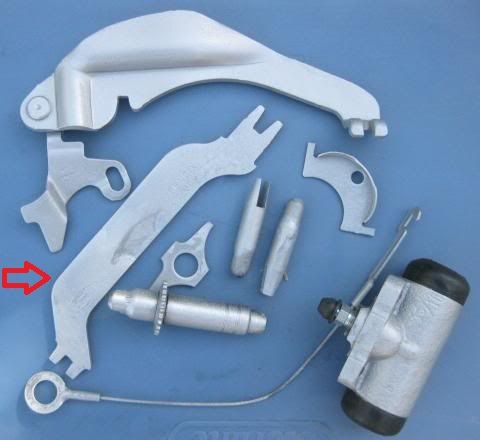

I'm trying to find out what this part is called? Also, If anyone can tell me and possible where I can buy it if an autoparts doesn't supply it i'd much appreciate it.
The forked end piece which spaces the brake shoes.
Depend on if you need ones for 9" or 10". Haven't been able to find any ones for the 10". Some places call it a brake strut.
Dave
I'm pretty sure I found them for the 10" brakes at O'Reilly's not too long ago...
Dorman makes it for the 10".
Dorman 21137 10" Brake Bar
Just copy and paste that part number into your favorite parts supplier's website to find the right thing.
