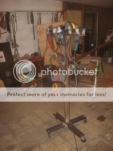

I have a bunch of $20.00 grinders so I don't have to swap out discs.... yes, I'm lazy! But they were all over the place and if in one place the cords would tangle. So I made a grinder tree;
One of the things I plan on doing is replacing all the cords with better, more flexible, -40c capable 15'-20' long cords.....unheated shop. I will attach electrical outlet boxes to the base to save time plugging and unplugging cords. Told you, I'm lazy! A 5 gallon pail will control unused cords. Some muffler tube welded to the mast will hold my two drills.

Only 2 drills? Why dont you have multiple drills with different size bits already in them. Or is that too lazy?
I like the tree. :icon_thumby:

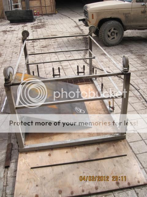

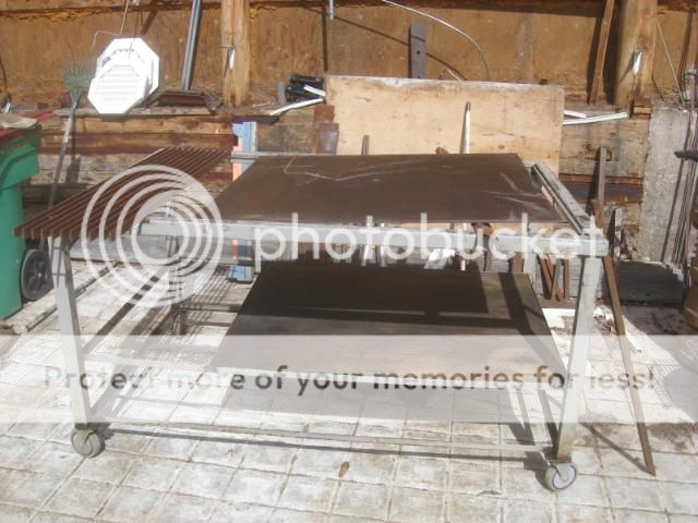

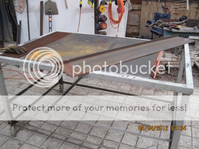

I was cruising Kijiji the other day and saw an ad for a metal table for C$50.00, as delivered;
It's 4'x6' and came with some good quality casters, two that lock, and a 1/4" 4'x4' metal plate top.I was told it was used as a deconstruction/clean up table at a motorsports shop and had a cleaning fluid tank on one end [not there any more]. I was building a table already but this is a much better foundation that what I was currently building. I decided to move the plate to the center of the table and fill the spaces, on one side a removable grate for cutting torch purposes, the other side with a depression to hold my band-saw.
I started out by removing all the old tabs and 1/2' angle that was used to support the plate as it was set 1/4" below the table edge surface, I suspect to help prevent stuff from rolling off. I want my table level.

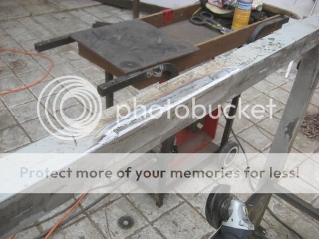

Repaired a bad section;

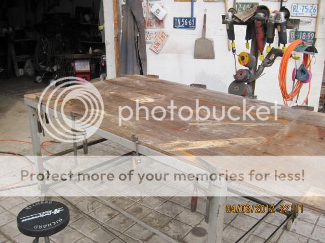

Because I wanted to make the surface level, I used a piece of 3/4" plywood clamped to the top;

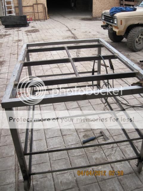

Flip the table over, lay in my top pieces and tack in my supports;

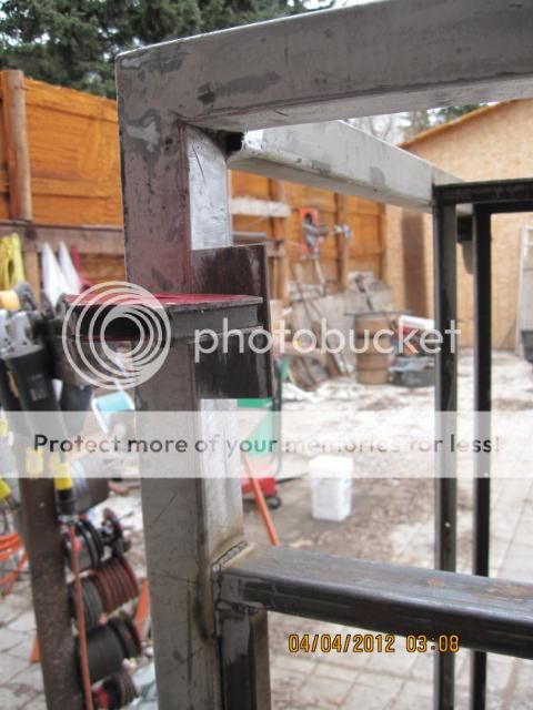

Before finish welding I checked;

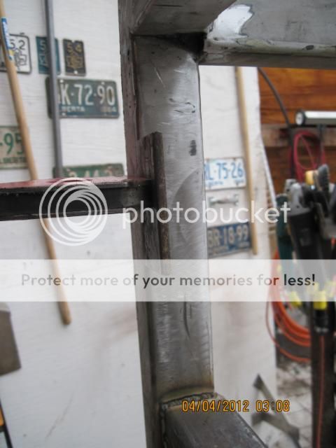

and found that the plate was sitting proud of the perimeter, I suspect because I was using used, warped plywood on un-level ground. I sat it on edge an used some scrap the same thickness as the top to place the supports at the proper depth;

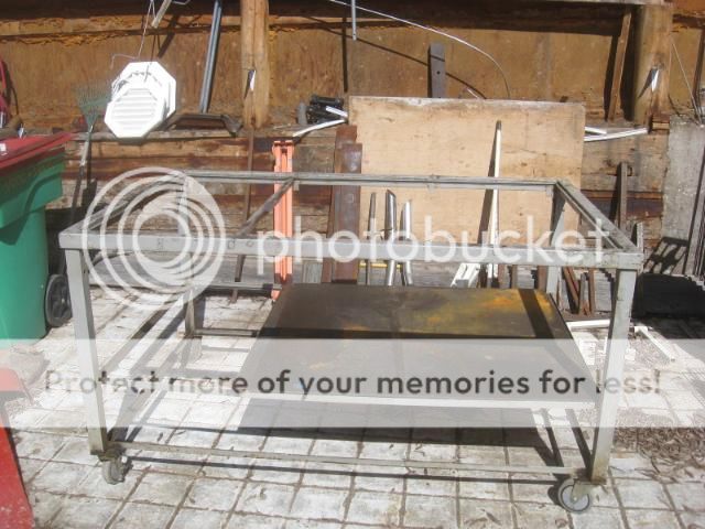

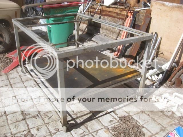

And where I finished for the day;
I found the table perimeter wasn't totally true, so parts of my top-plate still sits proud of the perimeter. I still have to build the support for the band-saw. I also am trying to figure a way to mount a 6" vise so that there is a vise/leg support that moves up out of the way for when I roll the table to a new position. Total cost so far is ~ C$60.00 plus 1"x2"x12' tube and 1"x1"x14' tube to be priced. Grate was free as is the support for the band-saw.

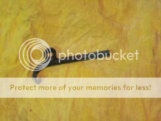

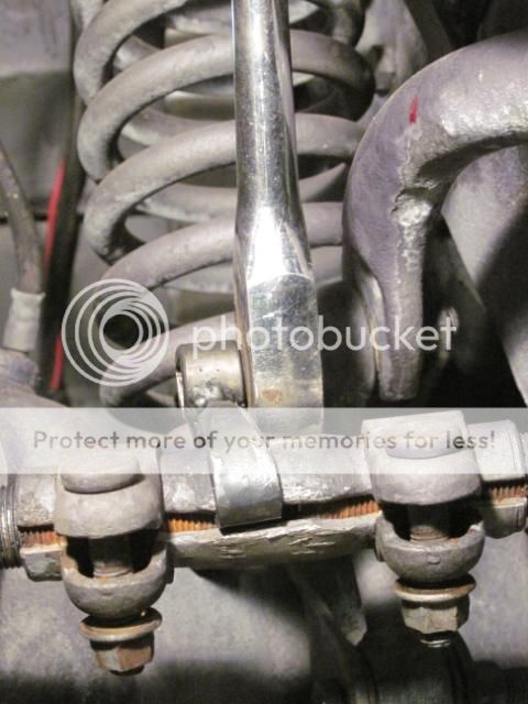

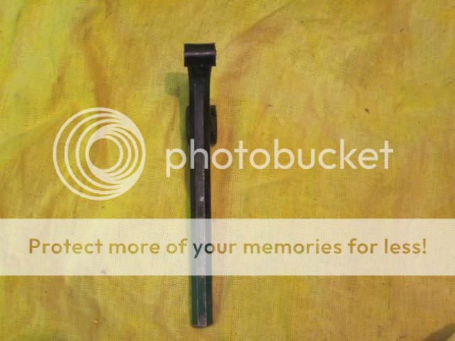

Needed a tool for alignment. Used a cold chisel and a 1/2" to 3/8" adapter. Heated the chisel with oxy/acet. and using a vise and hammer beat it into shape, quenched in motor oil. Cut the 3/8" part off the adapter so I could access both sides with a 1/2" ratchet and welded that to the newly beat chisel, heated red hot and quenched again in motor oil for stress relief. Seems to work....even better than I'd hoped.
Richard
Thats a sweet tool. :icon_thumby:

Needed a tool for alignment. Used a cold chisel and a 1/2" to 3/8" adapter. Heated the chisel with oxy/acet. and using a vise and hammer beat it into shape, quenched in motor oil. Cut the 3/8" part off the adapter so I could access both sides with a 1/2" ratchet and welded that to the newly beat chisel, heated red hot and quenched again in motor oil for stress relief. Seems to work....even better than I'd hoped.Richard
Nice fabbing! :icon_thumby: Im suprised that hardened chisel didnt shatter on you when you bent it tho.
