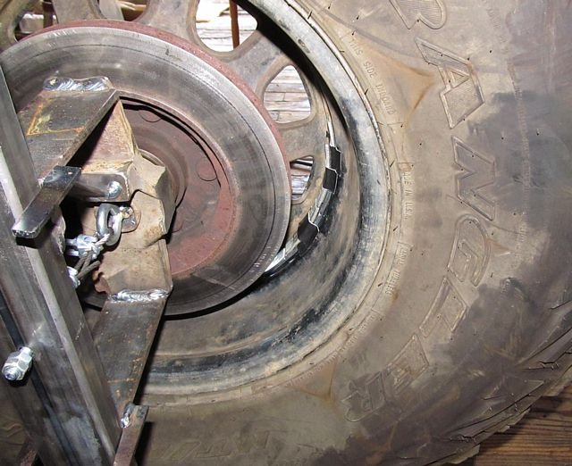

Dynamic tire spin balancer
In my ongoing battle of trying to get my Goodyear MT/R-Kevlar tires balanced (and in the process finding out what a POS the bubble balancer sold at the local Chinese-tools store is, :no2: at least the return was hassle-free), I finally decided to build myself a real unit that I can also do actual spin tests on. :icon_welder:
Homemade tools
If you're patient enough, this unit is capable of static-balancing a tire to within 1/2 oz for bigger tires (>33") and 1/4 oz for smaller tires (<30"). Imbalances of 1 oz and 1/2" oz (respectively) will be readily obvious however.
Dynamic imbalance is the prime cause for steering wobble or shimmy, so it should help eliminate those issues also.
If your tire shop can't (or doesn't want to) balance large oversize tires (or charges obscene amounts to do it), then just another reason to read on. :icon_thumby:

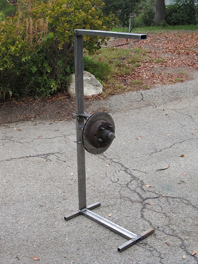

To build it:

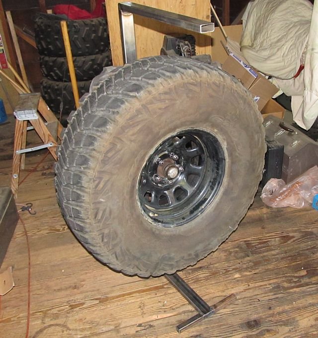

First, weld together a stand like shown above that will fit around the largest tire you plan to balance (I used 1x2x.120" rect. tubing).
Next you'll need a spindle & rotor from a 2WD vehicle with the lug pattern you need (I sourced mine from a '86 Ranger at a junkyard).
Make sure the brake rotor you get is good (not warped), otherwise this will negatively affect your spin results.

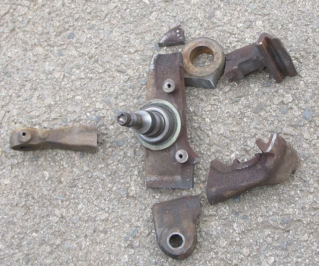

Trim the "fat" off it until you're down to just the spindle itself and a portion of the knuckle about 6-8" long

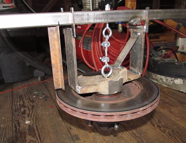

Make a pair of brackets like shown that will fit around the stand's frame to stabilize the spindle (I used various pieces of strip steel 2" wide, 1" wide, and 1/2" wide, all are 1/8" thick except the 2" is 1/4" thick). Leave about 1/16" of 'wiggle room' between the guide prongs and the stand (grind the inside of the prongs a little bit if necessary)
Make a "hook" on the spindle and a "pocket" on the stand so you can attach the spindle to the stand while it's stood upright (two offset pieces of strip steel stacked on each other forms the pocket)
Weld an eyebolt (threaded end cut off) into the rear of the spindle and attach a short piece of steel cable between it and the stand using a 2nd eyebolt (I used 1/8" cable and 1/4" x 2" eyebolts)
Weld a piece of 1/2" or 3/4" wide angle steel to the stand so that it's end will be about 1" from the rotor's surface
Hook the spindle to the stand and assemble the rotor & bearing onto the spindle.

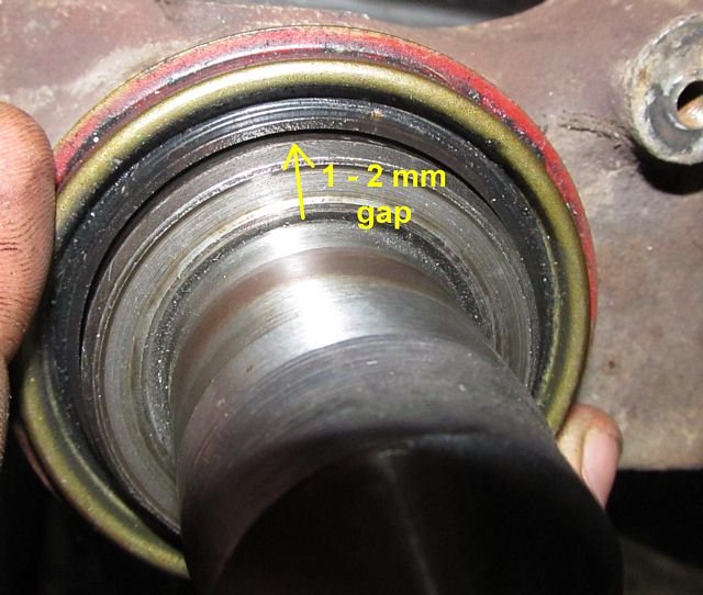

To minimize rotational drag as much as possible, hone out the bearing seal using a drum-sander bit on your rotary tool (Dremel, etc.) so that the seal has about a 1 mm gap around the spindle (you could also leave the seal out entirely, however this will leave the bearing more exposed to dust, which can affect the balancer's performance).
Lubricate the bearings with engine oil (don't use grease), and tighten the bearing nut just barely finger-tight (leaving a couple thousandths free play in the bearing).

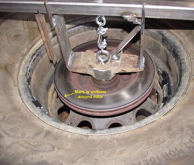

Dynamic spin balancing:
4.
Once good static balance is established, disengage the spindle hook from the stand and place the stand with the tire facing downward so that the spindle assembly hangs by the steel cable.
5.

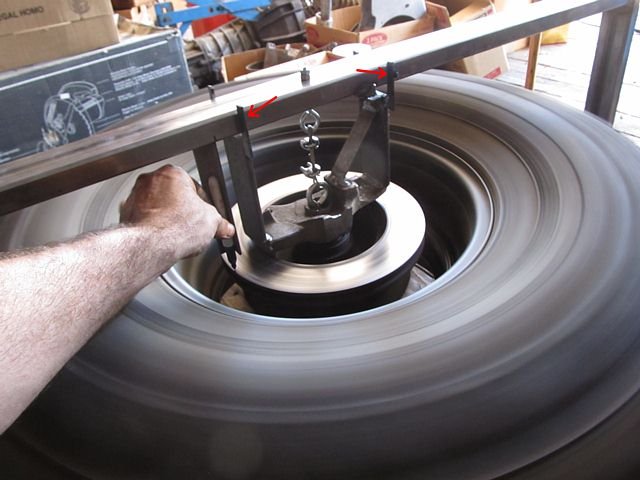

Spin the tire up to approximately 300-350 RPM, or about 5-6 rotations per second (put your angle grinder or a die grinder against the tire tread to spin it up).
Stabilize the spindle assembly by firmly pressing the guide prongs (red arrows) up against the stand with your thumbs for about 8-10 seconds (this is to eliminate any slow-speed wobbling (precession) of the spinning tire).
6.
Take a marking pen (Sharpie, etc.) and carefully place it within the angle steel bracket directly above the spinning rotor. Very slowly bring the tip down until it just barely contacts the rotor, leaving a mark on the rotor.
7.
Slow the tire to a stop by placing a wood 2x4 or something similar against the tread (don't try to stop it with your bare hands unless you like friction burns!)
8.

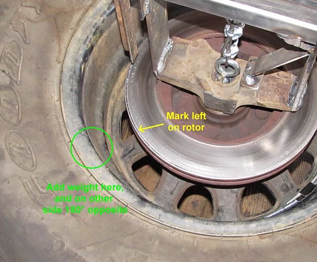

Examine the mark from your pen... If it's uniform all the way around the rotor, skip to step #9.
If the mark occurs only partway around the rotor, add weight at the inside edge of the wheel rim immediately next to where the mark is thickest/darkest on the rotor, and another equal amount of weight to the OUTSIDE edge of the rim 180° opposite of the mark, then repeat steps #5 thru #7 (a paper towel soaked with brake cleaner or acetone can be used to remove previous marks from the rotor).
Continue repeating until a uniform mark that fully encircles the rotor is formed during step # 6.
9.
Dismount the tire from the balancer. It is now ready to put back on your vehicle. :yahoo:

This is awesome! I wish I had the welding skills and a shop big enough to create one of these.
I do have a sugestion for a finer tuned spin balance tho... get a peice of your square tubing and cut it to the same diameter of the rotor. drill a hole in the center of it and mount it on the rear of the frame perpendicular to the frame. drill another hole at each end of it and weld a nut to the top.
get a long bolt or threaded stud that will fit the nut you just welded and place a knob at one end and thread it through the nut. Take your sharpie and cut off the end of it and create a slot in the end of the sharpie, slide it over the other end of the threaded stud and secure it with a small hose clamp to the stud. the tip of the sharpie should be just above the rotor surface and you can use the knob to turn it closer. this will let you fine tune it fairly well, as you will always have the sharpie in the same place at all times.
AJ
That's a good suggestion, though I didn't really have any issue getting good marks the way I did it, I just lean the pen at a slight angle into the rotor while holding it against the bracket (if it looks awkward in the pic, it was because I was trying to hold the camera taking a pic with one hand behind me while at the same time holding the pen with the other... Maybe I should make a tripod my next project lol :icon_twisted: )
I added another pic showing the mark all the way 'round.
