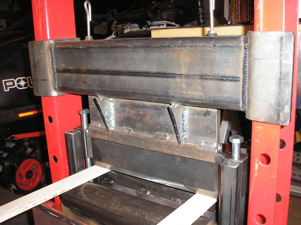

Nice!! And beefy!!

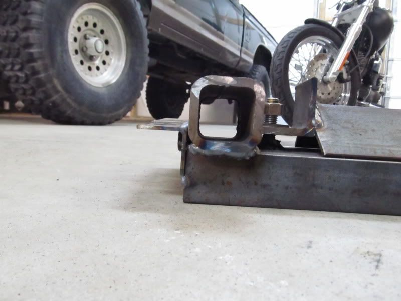

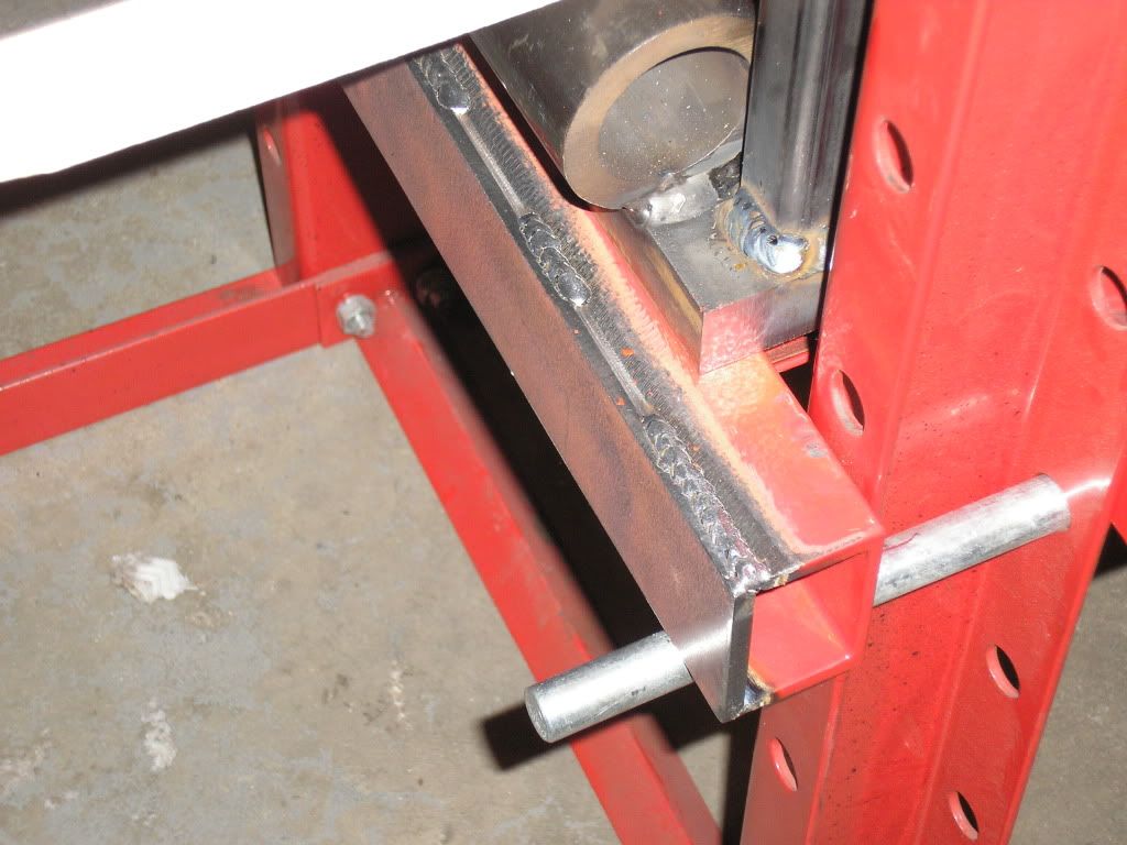

This is for reassurance. Boxed the lower portion for strength
Homemade tools

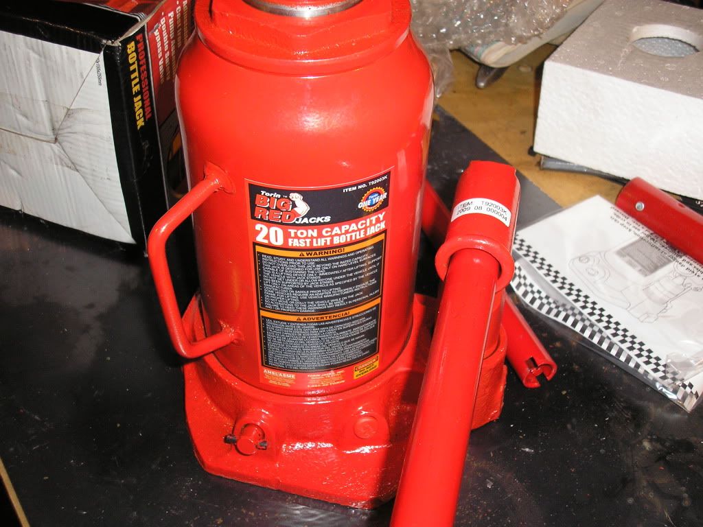

And upgraded the bottlejack.
Homemade tools
looks great!
i like how your guide plates were formed on the press they became a part of.:icon_thumby:
Well, I don't want that thing slipping off. And I have you to thank for all your input! Notice I reinforced the inside of the bazzoka pipes?
yup...i saw that.and that 20 ton jack will keep the effort down.i'm amazed how that thing pushes,even lifting a huge boat with it is effortless.

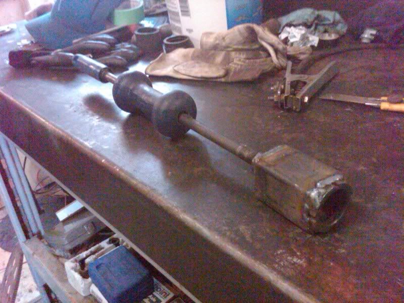

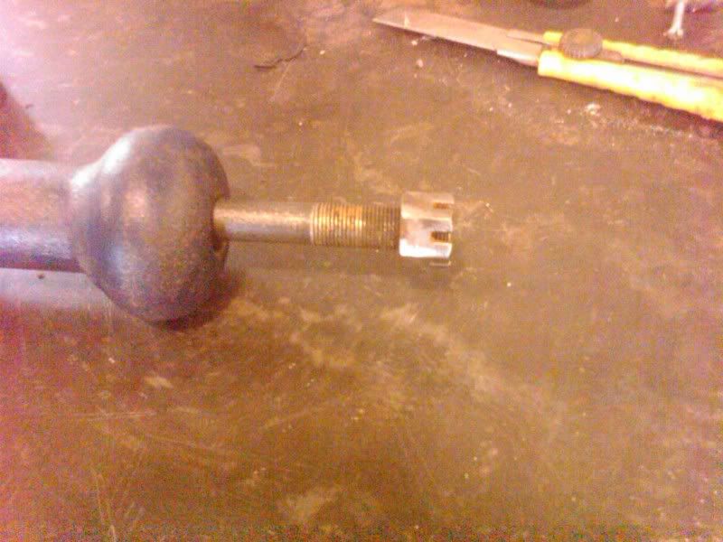

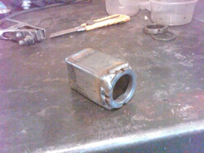

So, in order to pull out the axleshafts and dig out the 3rd member, the spindles have to be removed from the knuckle. This is a b!tch. So instead of beating with a chisel or pry, I whipped this guy up. I made an attachment to use with a slide hammer, to yank the spindle off.

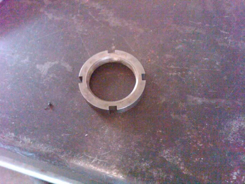

I snagged an additional spindle lock nut when I was at the boneyard.
Homemade tools

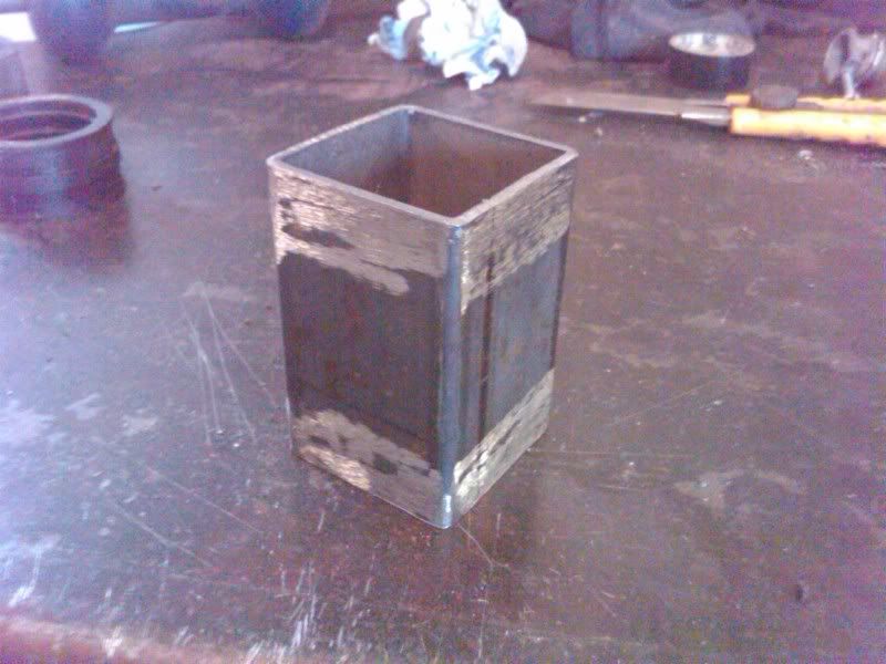

Then ever so elegantly cut a piece of square tubing (this was laying around, and big enough for spindle to fit in). The inside diameter of the tube needs to bigger than the inside of the nut.
Homemade tools
dug through the coffee can of random nuts, and found a nut with the same thread as the end of the slide hammer
Homemade tools
cut a piece of plate to weld to the end of the tube
Homemade tools
burned it in.
Homemade tools

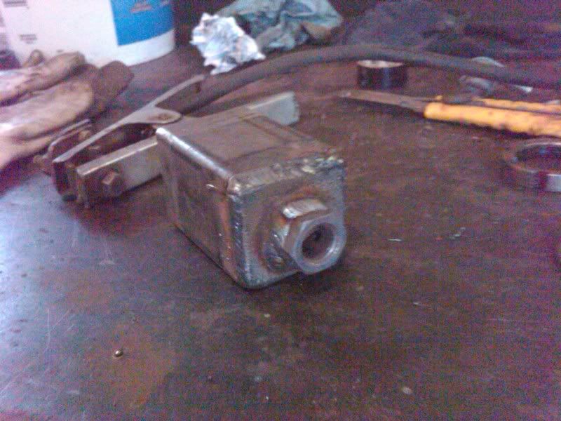

welded the nut into place.
Homemade tools
and welded the spindle nut to the other end.
Homemade tools

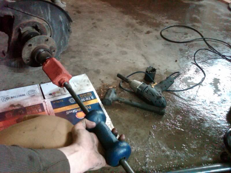

and here it is attached to the slide hammer.
Homemade tools
will make things much easier in the teardown, and is just another cool little tool to have kicking around.

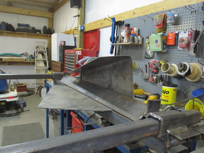

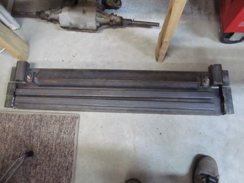

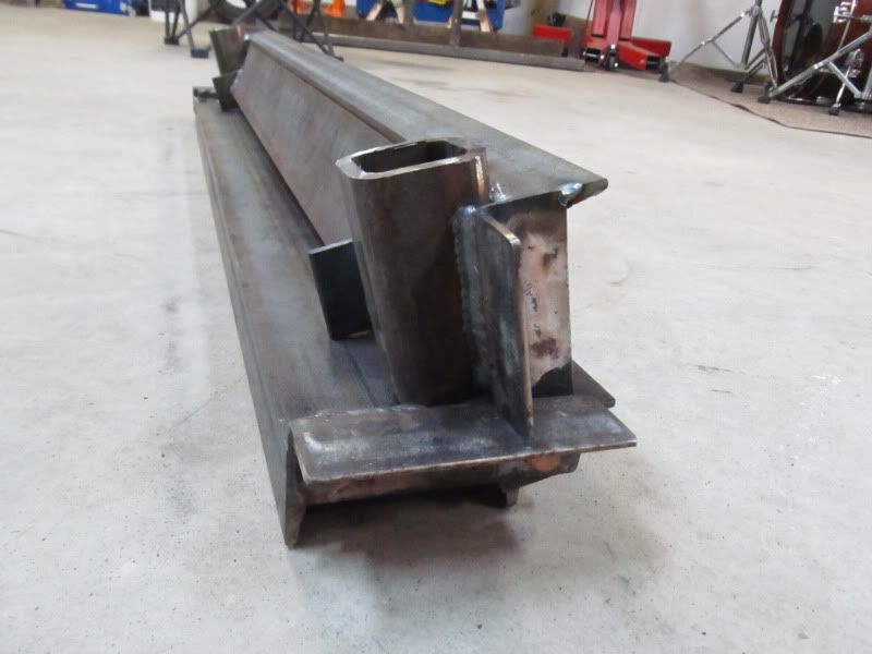

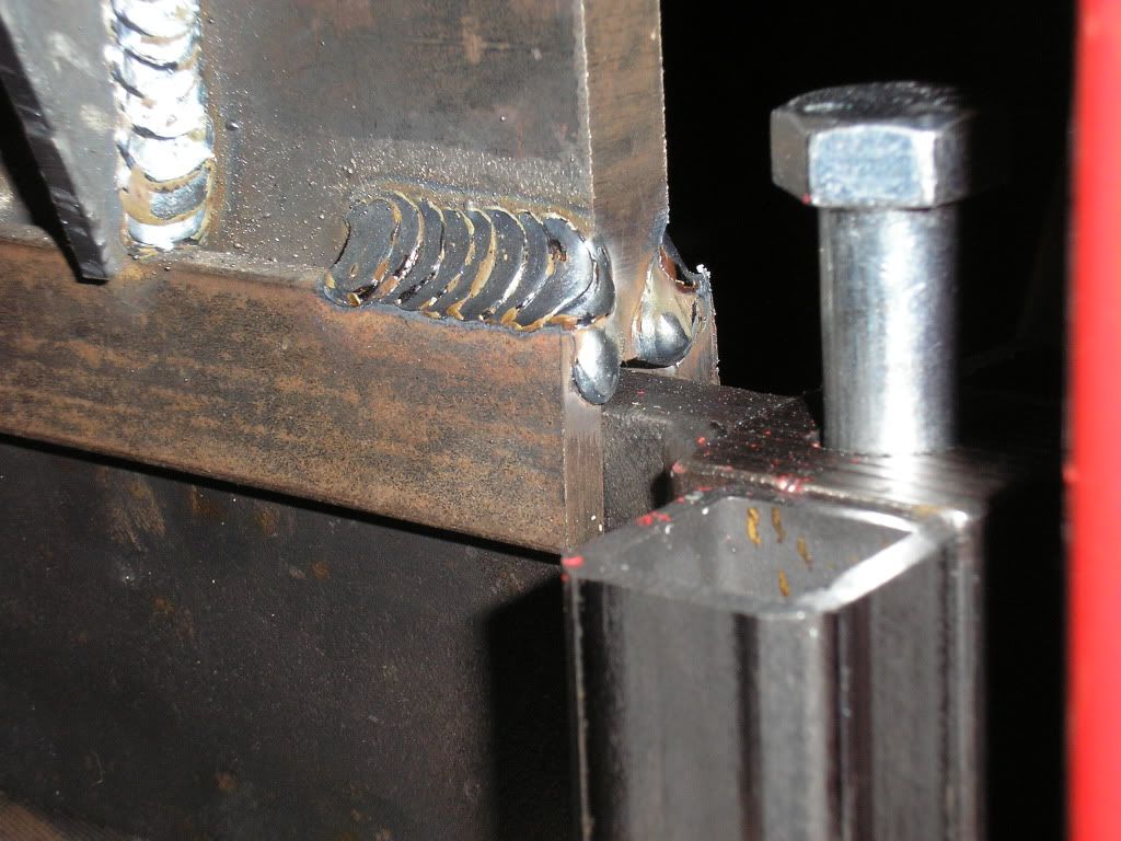

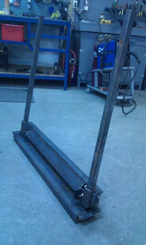

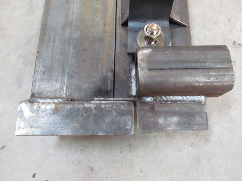

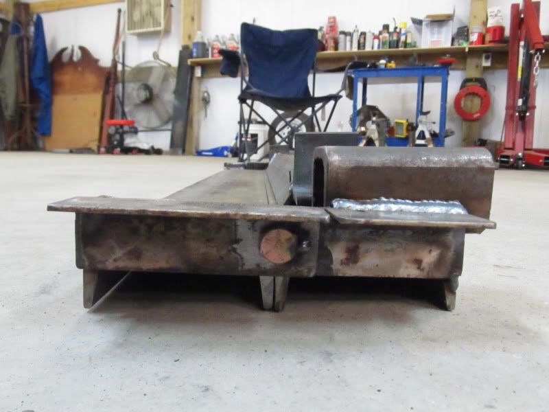

hand sheet metal break. I saw there was one post like this kind but figured I would add mine to
Homemade tools
Homemade tools
Homemade tools
Homemade tools
Homemade tools
Homemade tools
Homemade tools
Homemade tools
Homemade tools

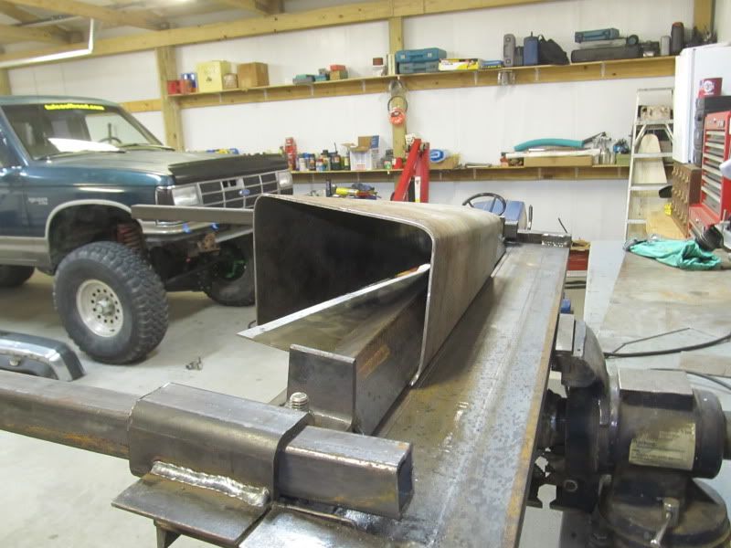

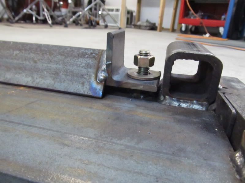

This was my first test with it 3inch wide 3/16 mild steel.
Homemade tools
For now I just put it in the vise but plan to make some sort of stand for it. here are a few building my bumper.
