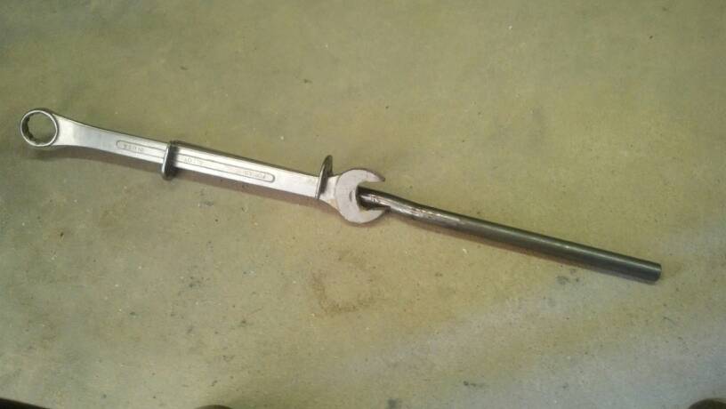

Just made this, this morning. Pretty simple. Anybody guess? (Its easy to figure out).
Homemade tools
Is there any reason not to just run diesel fuel instead of solvent? I soak stuff in it all the time and it works great, actually just used it to remove a bunch of road tar from a chain strap wrench I found.
I don't see why not. I wish I had thought of that.
Homemade tools
A lever for lifting; suspend by the middle and hook chain connected to ? at the end...?
I just took a closer look and with the bends that idea isn't as likely......so what is it??? I'm turning green from holding my breath in anticipation!
Thats all it is. A cheater.....
Our shaker screens obviously shake for 12 hours a day and 8 carriage bolts hold them in. Spec calls for damn near 300lbs of torque and the guys keep complaining the screens are coming loose. I don't like double wrenching because if you slip its never good. So I made this so it cannot slip.
Flip it over and loosen a streched or rusticated bolt as well with no slippage.
That's what it is. Instead of using another closed end wrench on the open end of the original wrench, that have a habit of slipping causing owies.
Edit; Angry beat me to it.
Richard
Look at me take something so simple, and make it out to be more complex. :D
