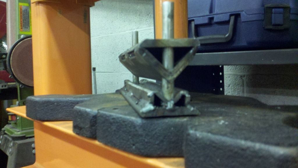

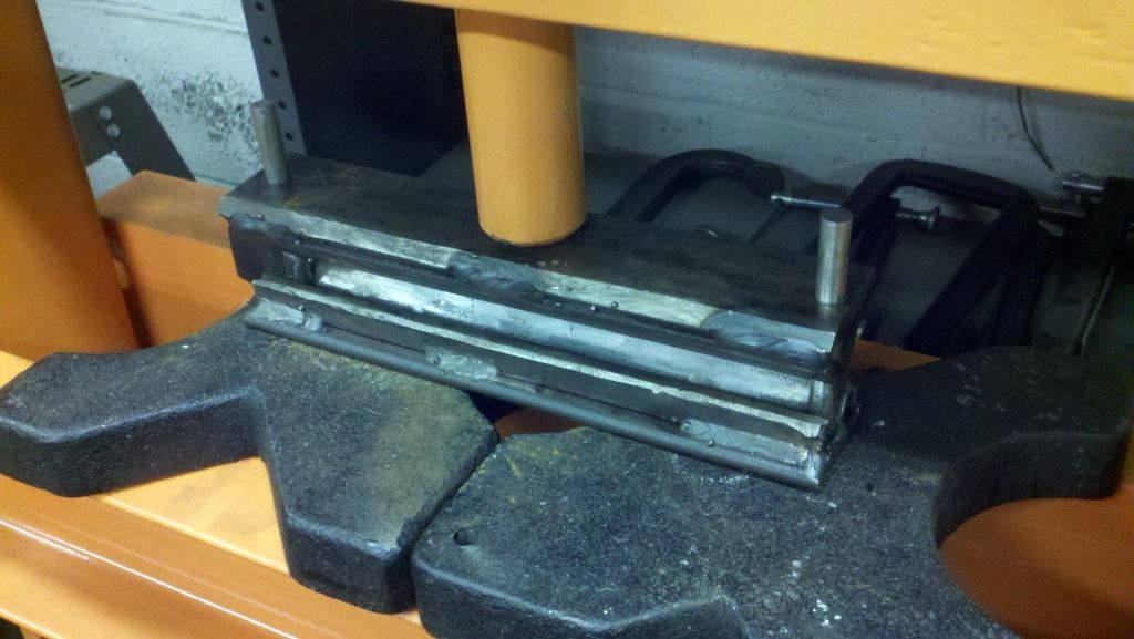

I'm grinding an edge to this plate to use in a homemade press brake.

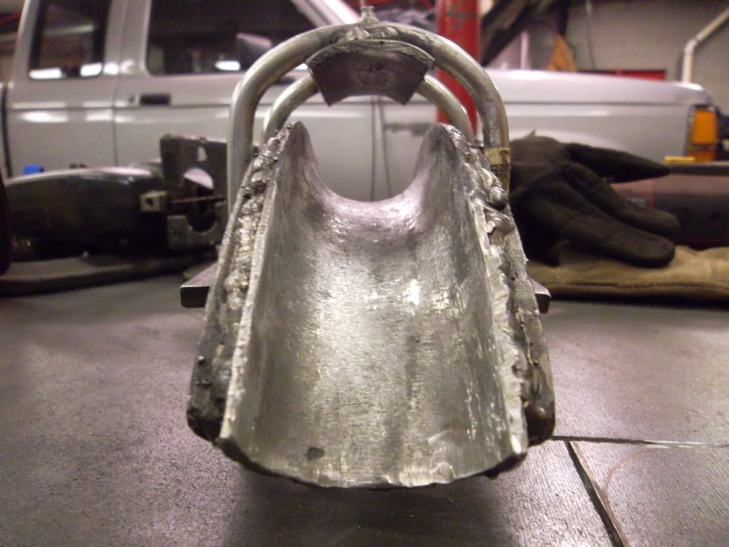

With a fence at the back tubing could be ground on the roller for cage fit-up purposes.

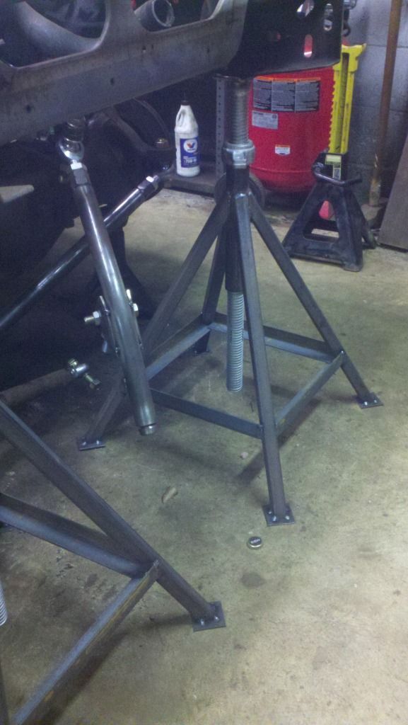

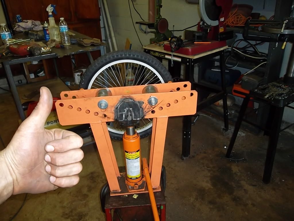

Portaban Table, Leafspring rearcher, press brake, tube bender, tall ass jack stands....

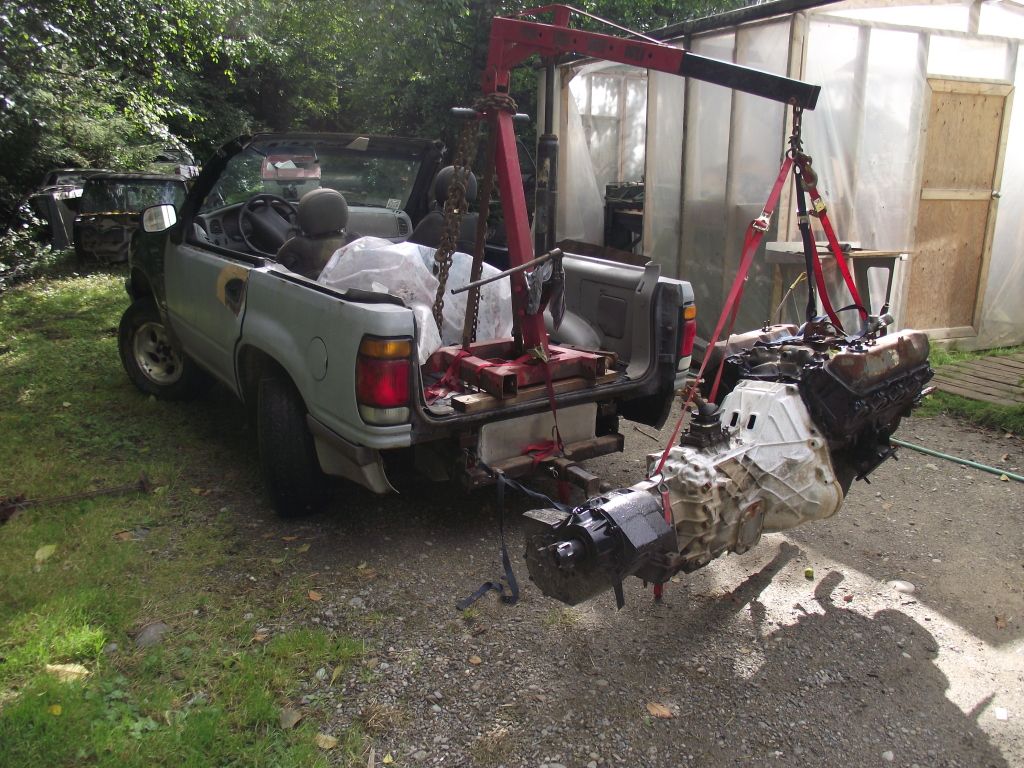

thought i would share my mobile cherry picker boom hitch thingama jigger.
those are pretty handy-i made my setup a few years ago and use it constantly.
