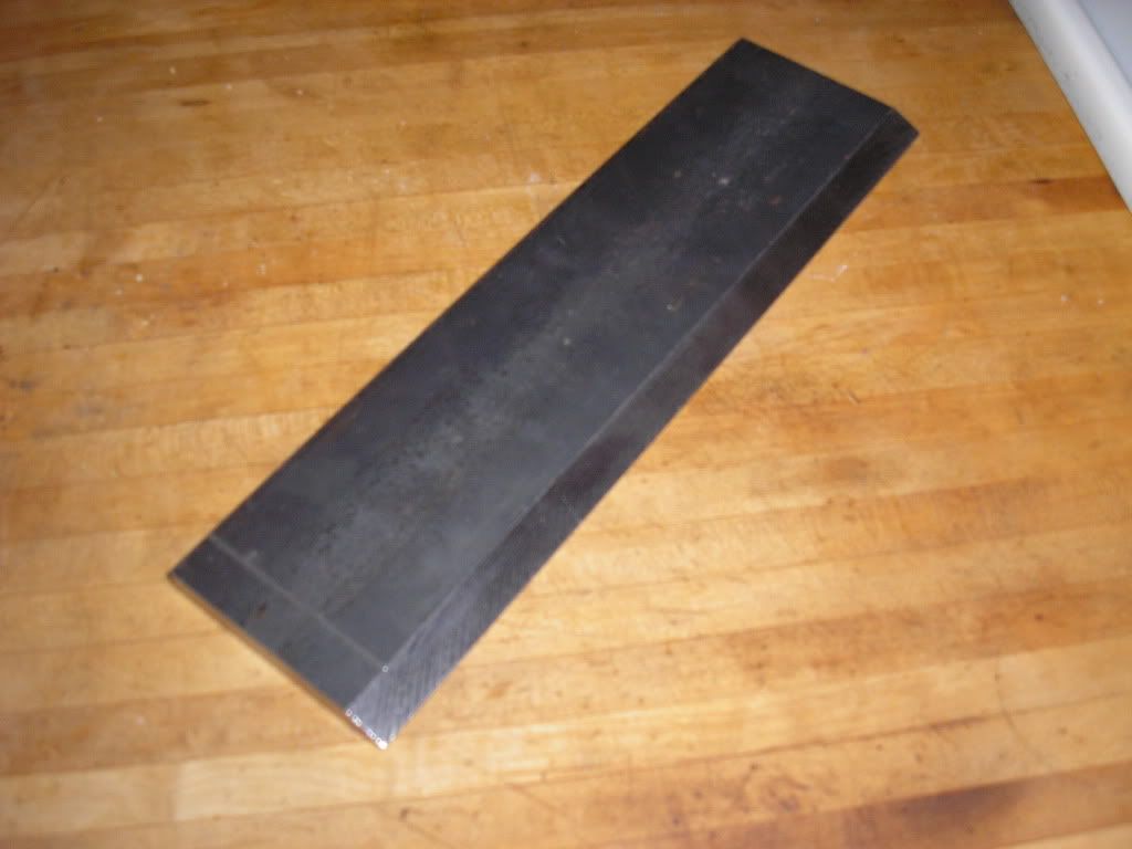

Here's the top die I made with 1/2"X3" steel that I got at work, then I scribed a line down the middle of the edge and another on both sides for a uniform grind. Not bad for a 9" grinder, huh? :D
Homemade tools
Homemade tools
nice edge.that reference line is pretty much a must to get an even grind.
looking forward to seeing how the lower die turns out.
Thank you sir! I got the edge down to .060" +\- .010 (roughly) :D . A sharp sharp edge would fold over in the first usage, so I left that much of a land. I was more worried about a straight beveled edge, so yes, scribe lines are a must.

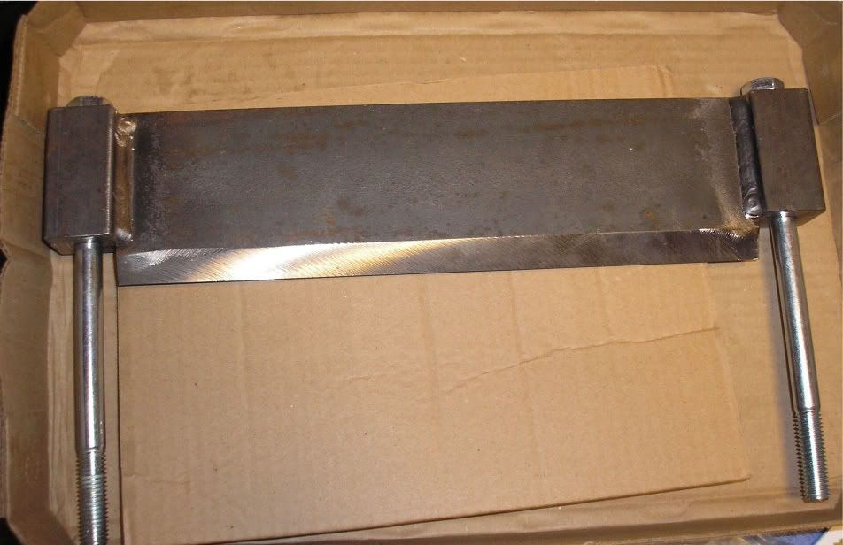

Got the side blocks welded in place with some 1/2" bolts as guide bars.
Gonna start on the lower die(s) now.

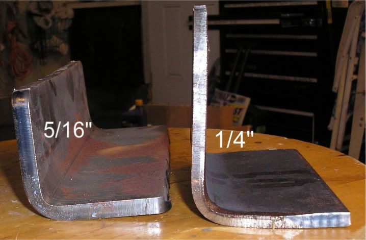

IT WORKS!!! IT FREAKIN' WORKS!!! WOOHOO!!!
Homemade tools
Homemade tools
Homemade tools

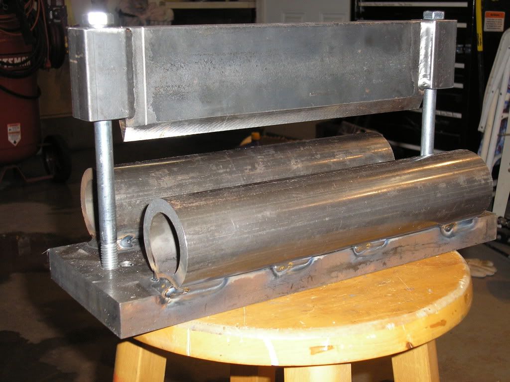

And here's the masterpiece that did it all:
Homemade tools
Homemade tools

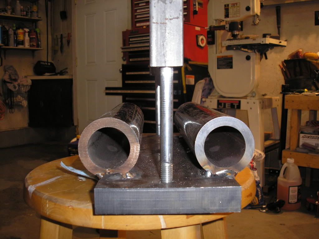

This is what I had to work with (since it's all I could find at work that isn't too thin.) The nickname for the stuff is "bazooka pipe" for obvious reasons. :D
Homemade tools
beauty!you wouldnt get better bends from a professional fab shop.
i do have one concern,though.there are huge forces pushing outward on those lower tubes,and as strong as the welds are i would put some narrow flatbar from the bottom of the tubes to the base to gusset it some,or you may find that the lowers start to spread apart.you don't want a weld letting go when there's 12 tons(remember,that's 24000lbs)pushing on it.
i would also put some more bracing on the top plate,as it will start to bow over time with all the force in the middle,but a load going to the ends.
not trying to be critical,it looks great.just want to make sure it stays that way in the long run:icon_thumby:
Yup yup. I'm actually gonna make a special top portion for the press to distribute an even force over the top of the brake.
And I'll do the bracing deal. I spray welded the tubes to the plate, but a little extra insurance is always a good thing.
I welcome any tips from the pros! :icon_thumby:
