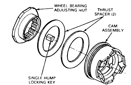

one of the " single hump locking key" 's was broken.

ill try and post a pic of what im looking for. thanks guys....

dealer or yard would be my first guess
I just threw a set of auto hubs away about a week ago, could have sent them to you haha.
I think a junkyard would be your best bet to find a new one
Yeah, hit the yard. Those keys aren't hard to get to as long as you've got a big ol set of vise grips and tiny pick/magnet. Shoot, they may not even charge ya for it. I got some valve spring retainers once for free.
I think if you buy a new spindle nut, it comes with the key.
