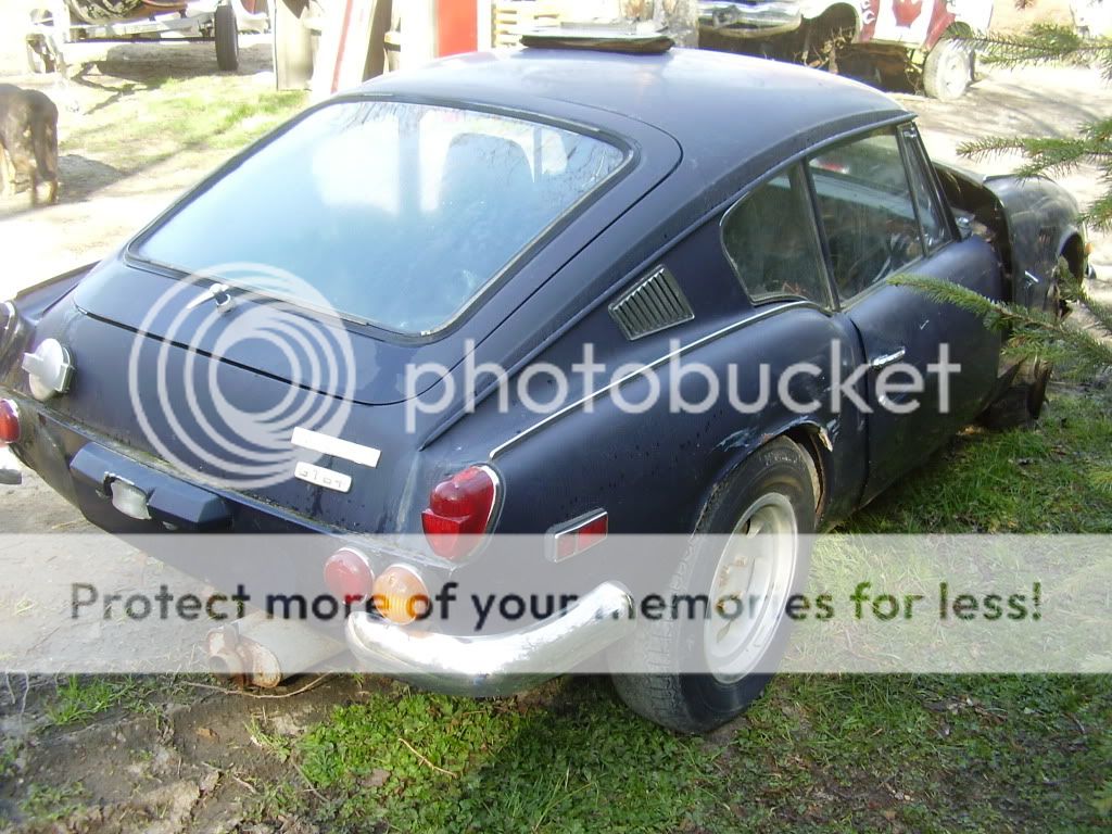

so here's the plan...
Gt-12
1.those round lights across the bottom....gone.
2.the bumpers...gone.
3.side markers...gone.
4.pinch welds...gone.
5.top windshield seam...gone.
6.headlights...frenched.
7.taillights...small french,just the depth of the bezel,but still allowing the chrome to show.they seem to stick out too far,but i like the funky style of them.
8.gas cap.too cool,gotta polish that to a mirror finish.
so much for just sticking a jag motor into a gt6.this thing is getting out of hand,so i got it just where i want it:D
and by the way-that thing that houses the backup light and licence plate is cast aluminum...so i just might polish it up too.

you're right-the headlights need frenching.the roof is as low as it goes,they are kinda bulbous on these,i've been considering ways to streamline it a bit but i may need to just live with it.
and yes,the top bar on the windshield needs to be raised.
Don't get me wrong I wasn't trying to say it was not low enough, hell any shorter you may as well not have a roof.... oh shit, shouldn't have said that.
Just that that top over the windshield will block part of the little view you'll have left with that engine in the way.

don't worry,i don't take offence.actually,if you go back about 15 pages or so to where the cowl was first brought in with the windshield frame,i discovered then that i could raise that bar...i just haven't got around to it yet.as for the roofline,that's one of the things i've been bothered a bit by,but i'm only going to redesign so much of this thing's style.so that part's just me.
so don't worry about the input-i appreciate it:icon_thumby:
