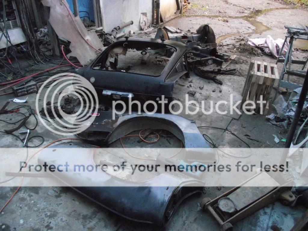

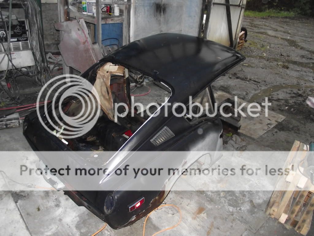

i knew there was no way to get this into the house,but then i got to thinking(dangerous)and realised that if i was cutting the seam on the top of the fender,and the one below the taillight,and the floors are going,there's not much left holding the fender to the roof section.and fitting the body to chassis interface will be much easier when the parts are all in one place,so i got to sawzalling.
Gt-12
it's much more manageable like this.i'll only be able to tack it together untill i get it all out again,but all the fitting will be much easier now,especially around the rear wheelwells.

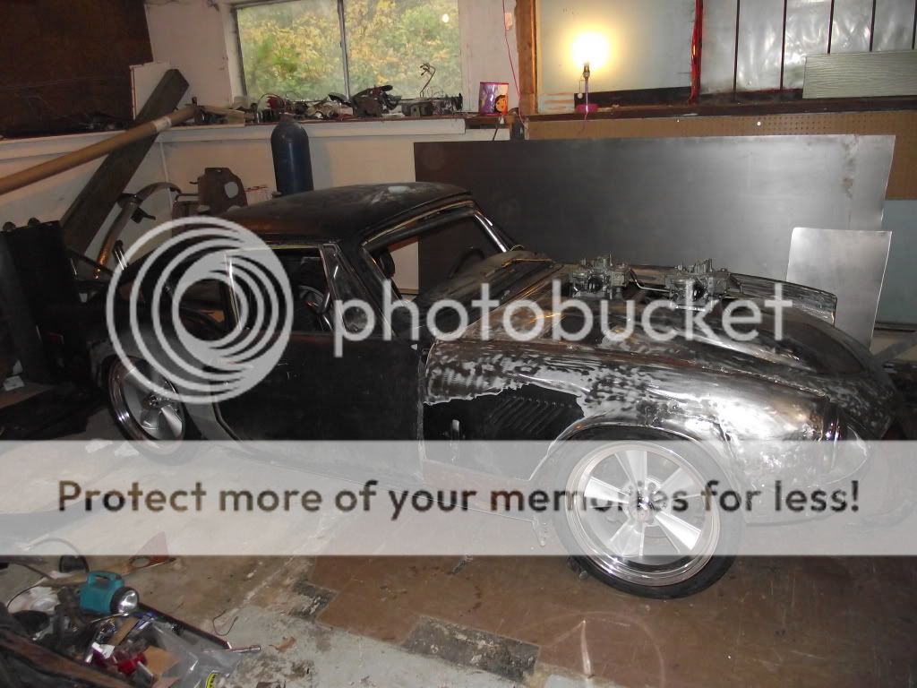

it's kinda cool to see it looking like a car,even if the panels are just sort of draped over it for now.it's even more cool to see that things are fitting where they need to be.
sitting in the car now i can see it's a good thing i'm not claustrophobic,as it's certainly not as roomy as the f350,and getting my aging butt back out of it is a bit of a chore.
the view through the windshield is pretty cool,though.:icon_thumby:
