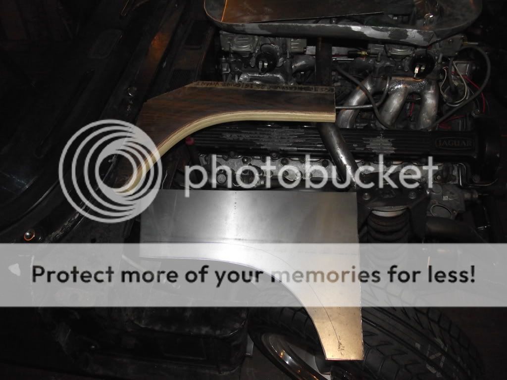

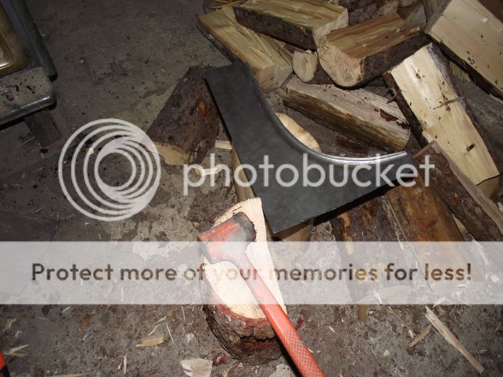

time for some sheet metal work.i'll make a patch panel for the left rear wheelwell.a simple plywood form was made,cut to the profile of the wheel openning and sanded to the shape of the flare,in negative,of course.

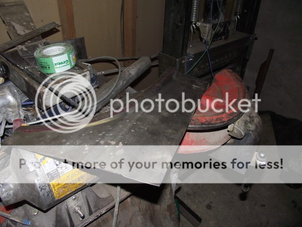

a chunk of sheet metal was cut,leaving ample extra material.
sheet metal gets clamped to the plywood form,with another peice of wood to spread the load.

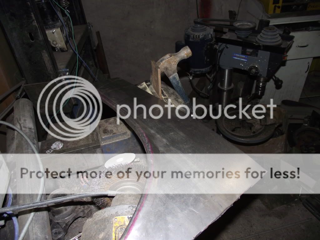

after some beating with a deadblow mallet,i have the rough form of the flare.now i need to get the outer edge.the red marks are the approximate lines for the flare edge.
an old pipe bender die has about the right curve for the first edge,so i cleaned up it's edges and put it to use.a bit of hammerwork and i have a crease on the flare.
a chunk of flatbar in the vice forms the second edge on the flare,giving me the turn in to finish the profile.and yes-that's a carpenter's claw hammer i'm using to form it with.for all the bodywork i do,i don't even own a proper body hammer.i do have some pretty good dollies,though.and i keep a smooth face on the hammers i use-any mark in the face of the hammer will transfer to the metal being worked.
after forming the edges,i went to the endgrain of a piece of home heating fuel to form a slight convex curve to the outside face.this is done by tapping the inside face against the wood with the deadblow,using even strokes with good overlap.
immediately after forming the proper curve,this piece of custom metal forming equipment was put to another use...
and there i have it-a patch panel that i think is a bit better than what it will replace.it took less time to make it than to post it.
Looks good. I like learning [the plywood form idea]. In my build thread it's usually how NOT to do something...but it's still learning!

hey,if anyone can get some ideas about how to do something for their own project from this,i'm a happy man.
i think with a lot of this stuff,people think they need a lot more equipment than they really do.that's why i'm happy to show that these things can be done with really basic tools-and a little bit of thought-and still get the results a fully equiped custom shop would expect.

Sick work on that patch panel buddy!
thanks,and thanks:icon_cheers:
i figured there must be someone from pg here.and on the patch,they just don't make them,and i couldn't live with the mess that was there...so out come the hammers:headbang:
