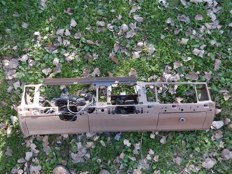

And then the metal first gen dash enters the chat...

Ok. Didn't realize you had a metal dash. I wish I had a nice, durable metal dash.
It would be.
The plastic cap they put on the edge right in front still cracks and falls apart lol. The panel across the top the speakers mount to is steel also.
