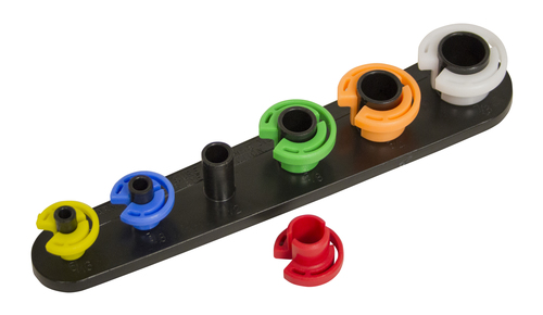

When I've done AC work on my trucks, the scissors type didn't work (I think they're too blunt to get under and spread the spring), whereas the plastic wrap-around ones did work. It seems to work best by pushing the joint together while at the same time pushing the tool into and under the spring. A little twisting of the lines also helps.
The joint can get packed with dust. Pressurized spray bottle of liquid alternating with air has helped me get them apart.
The plasting clips work best for me too. The scissor type never did.
IIRC, there are 2 scissor types, giving 4 size options total.
The tool doesn't really need a handle. All it does is push the circular spring back out of the way to unlock the fitting coupling.
I would think they're easy to find; I got mine like 40 years ago off the tool truck.

It's called a garter spring...
I most always shoot some lube from a can into the spring cavity... then blow with compressed air before trying to insert the tool. And yes... push and twist the coupler together... insert tool fully and twist them apart.
Some can be a struggle. I have a few different spring lock coupler tools... I like the plastic ones on the rack about the best.

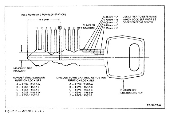

I've replaced the mechanical ignition switch in of one my '94 Explorers, as it was "falling apart" like yours, and it only came with one key. So I looked into it, and here's the deal; it should be the same dope for your '93 Ranger- single key that works ignition and doors.
It's called a "10-cut key" system. Cuts 1,2,3,4,6 work the ignition switch cylinder and cuts 5,7,8,9,10 work the door lock and glove box cylinders. Both groups of lock cylinders share cut 6, which is why a a Ford dealer sells replacement ignition cylinder based on the depth of cut 6 (there's five cut depths, or 5 total possibilities).
Like this:

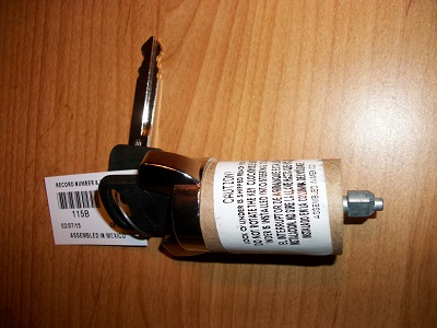

What I did on my Explorer, sounds crazy (I'm sure the counter people thought I was crazy) but I went around the local parts stores and asked to look at the new replacement switches that they had in stock. Sure enough, I found one with the same cuts as mine, just in the wrong positions. A new cylinder will have keys that are only half cut, for the ignition part:

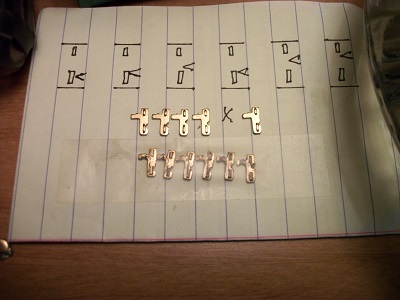

What I had to do was take both old and new cylinders apart and rearrange the six tumblers in the new lock to match my old lock.
Kind of aggravating, precise work but actually really easy; take tumblers out of your old one in order and rearrange the new lock tumblers to match:
After putting the reassembled new cylinder back in, my old (single) key would start the truck. Then I went by a locksmith, bought two more new blank keys, and had him cut them to match my original key. The ones that came with the new cylinder won't work after repinning the cylinder
