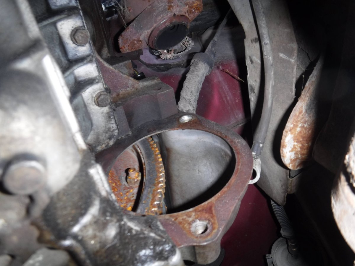

I dug that starter out of there today, that was a chore.
Now there's enough room to get the camera into the hole, makes it look big but the camera fits inside, but my hands don't fit as well :D I also will need a mirror stick to see where the tools need to get to :/ And I hope those are the bolts I'll need to get off?
I think other than those the mounts are the only thing left holding it in place

Yes, that is one; there are 4 of them. You can turn the crank with careful use of a big flathead screwdriver on the flexplate, or with a socket on the crank balancer bolt. I think that I used just a 3/8 ratchet wrench and socket to get the flexplate / TC nuts.
Yup, 3/8” ratchet and appropriate socket through the starter hole for the 4 flywheel nuts. You can either bar it around through the hole or a socket on the crank on the front of the motor to do the same thing, but that works best with someone to turn the motor and someone under to watch for when it lines up. It’s a pain. If I don’t have to disconnect an automatic in the vehicle, I pull both. It’s harder to pull both together though and your gantry may not have enough height to pull both. If you need more leverage on the flywheel nuts you can use a 3/8” drive socket and 3” extension, then an adapter and 1/2” drive ratchet.

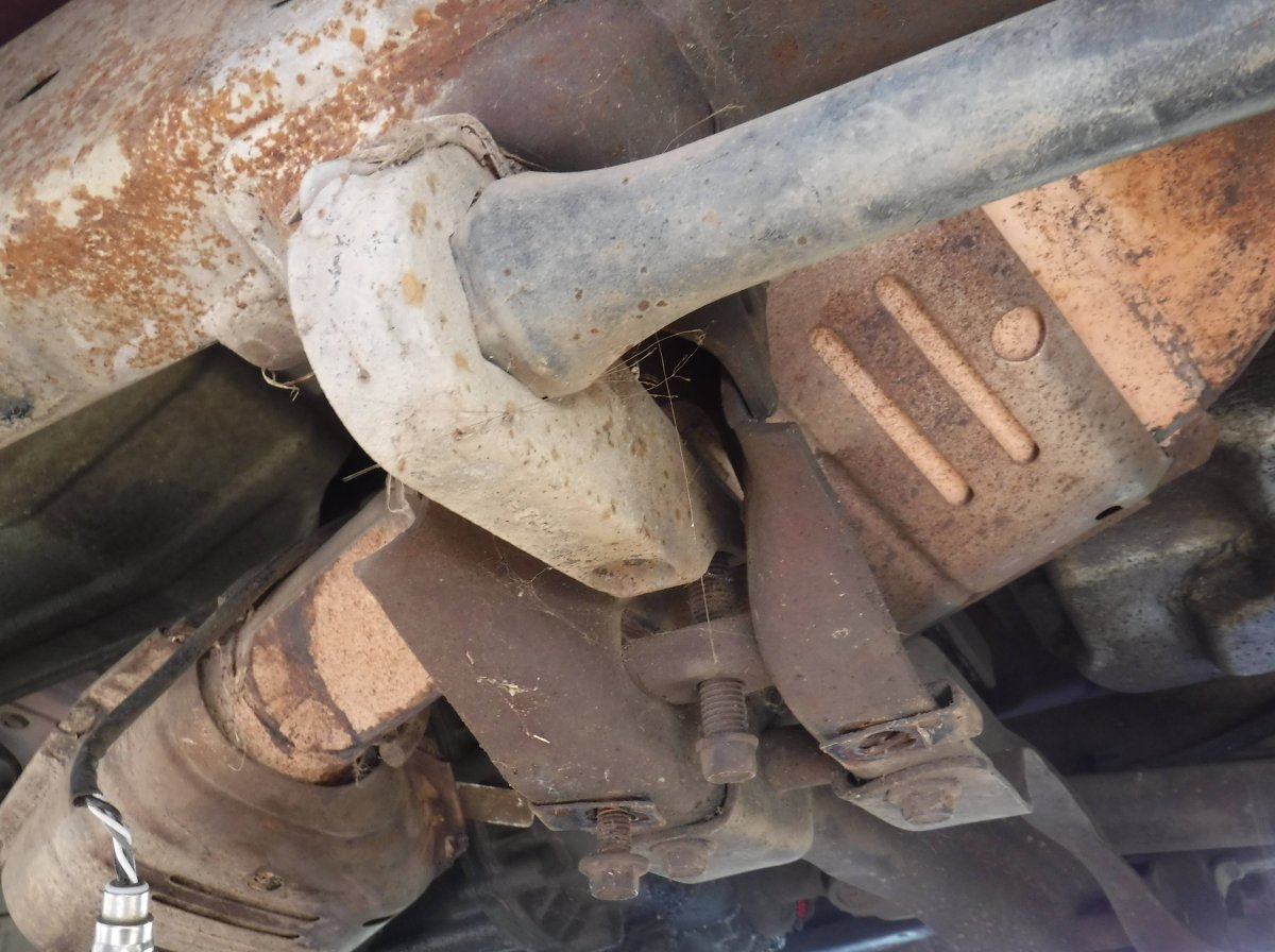

Does this rod have any tension on it? I'm wanting to get the muffler out of there and I think the cross support needs dropped to loose the muffler
Yes. It's the torsion bar end where tension adjustment is done. The torsion bar is the spring for your front suspension that is holding the truck up. You can loosen the bolt in the picture to relieve some of the tension but I'm not sure it will be enough to drop the cross member. The better way is to use one of the two tools listed here https://trsgarage.com/product-category/ford-ranger-suspension-lifts/1998-2011-ford-ranger-lift-kits/ to press on the key to remove the bolt and the part the bolt threads into. That will enable you to remove the key so you can drop the cross member.
You can drop the center part of that crossmember but the rest is welded to the frame I think...
Thanks Scott and SGT. I think the other side is enough to get the transfer case out, that's all I wanted
You might be right. It's been a while since I messed with it.
EDIT: Looking at the supplied picture, you are indeed correct. The bolts are in the picture.
The bolted center of the crossmember does seem to wedge in pretty tight, i pried them out of both trucks and hammered them back in with some grease. You can drop the center with the torsion bars holding tension. The ends that hold the torsion bars are welded to the frame.
