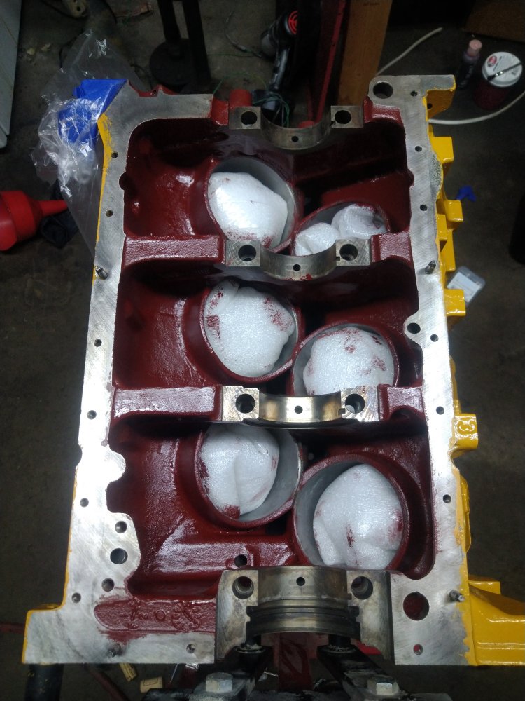

I used it on my 3.0 build. Lifter valley, heads, timing cover, and underside of the lower intake manifold:

Hoping this fixes a cologne trouble spot. I've ripped a few 2.9s apart, and common to engines with rockers that look like sh*t is thst the underside of the lower intake will be full of tar. The lower manifold gasket prevents oil return, and the lower gets decades of crankcase garbage baked into it. I have one that's been soaking for weeks in aluminum safe cleaner trying to clear it. Nope. So, eliminate the sludge trap. When I do reassembly, I may try a few drain holes in the lower. Now that I can drain stuff back to the filter, let's see how it looks in a year now that oil vapors can condense and gtfo. Sure, could be said that glyptal may hold a little heat in the lower. Sludge holds more.
Methods are easy. Organic brushes only. Trust me. Had to clean the block back out. Harbor freight horsehair acid brushes or chip bristle brushes. There's parts I painted with a Blick artist brush in the lifter Valley.

Did a tew tests with it. Baked the timing cover to "set" the paint (2hr, 260F) to the metal. Definately changes it for the better. They were right, this sh*t is like it iron when it cures.
Was said in a YouTube video that the paint needs to be baked on, but the instructions on the can are for armatures, the paints intended purpose. It lists baking as optional. It's not. You have to bake for engine application.
Need to dry before bake. I didn't do two weeks between coats, just a few days. Color changes when it's ready for recoat.
Did try to bake for three hours at 220, hotter than engine Temps could heat the timing case cover for three hours to see if engine heat could cure it. It did not.
