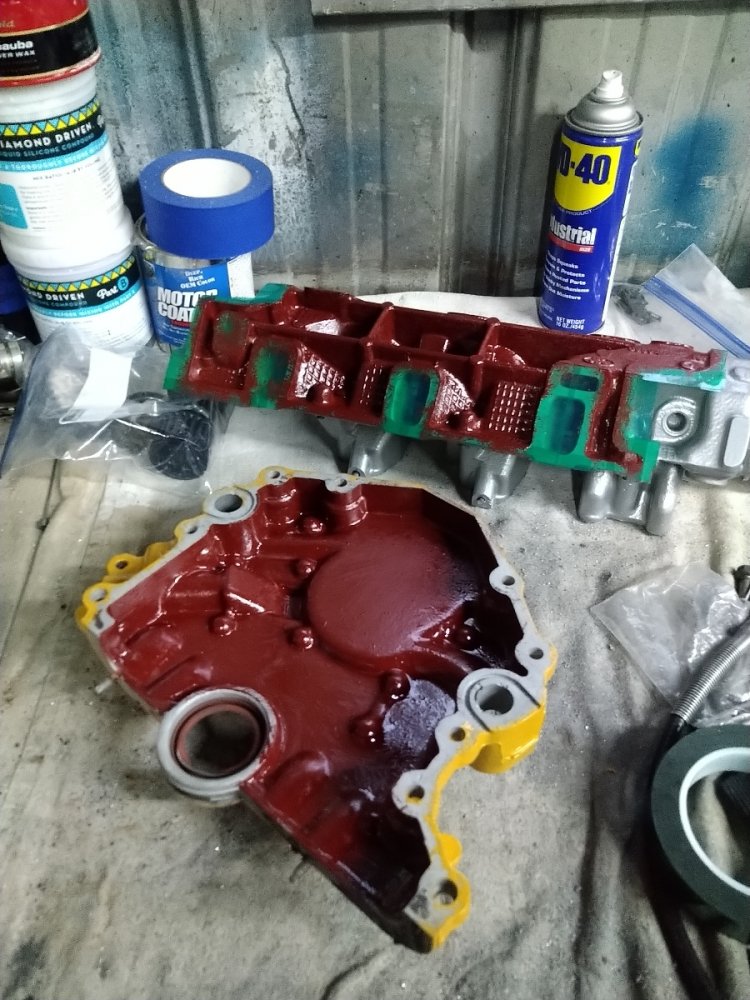

So, baking this stuff on is apparently critical for an engine environment. Good to know.
Doesn't the ummm engine do the baking on its own? I never baked it on.
Dunno. Prep is done on block, heads, timing cover, and lower intake.
Thinking about using it on the inside of the oil pan as well. Have a quart of the stuff, so, can't see a reason why not to do it.
Except that I used a rubberized coating on it last time called "outlast."
Stuff is tough as nails once it sets up, but chips and comes off easily for the first month or so it's on. So, my oil pan is going to be a study in chemical strippers because it's chipped to hell and back.
Not even the electrolysis tank or blast cabinet running aluminum oxide will touch this crap....
So...... This crap is weird.
Glyptal Engine Paint
First coat is on half of the block, lower intake, and timing cover.
Stinks like hell, hard to lay down, gets freaking everywhere, and dries as you put it on.
Still have to do the heads and inside of the block, but progress has been made.
Definitely need to pick up some artist's brushes for around the lifter galleys, etc. Missed a few spots because every damn brush I had was too big.
Oh, and I've used absolutely none of this can. Joy.
