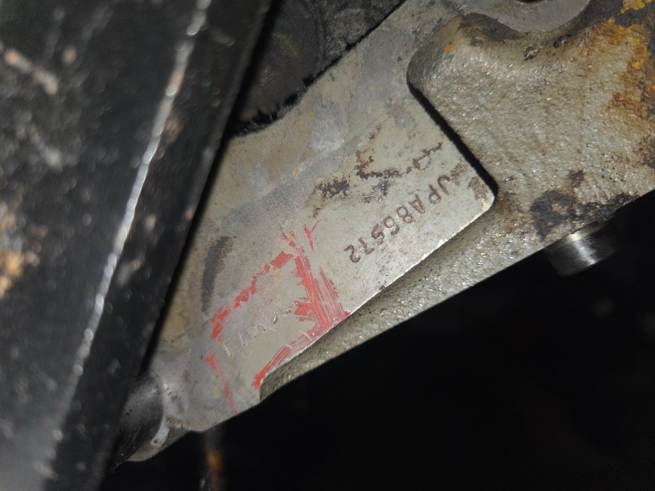

Ok, finally remembered to update this. The 2.9ls ARE in fact, serialized with the serial portion of the VIN. Funny enough, I would've sworn my trucks engine was swapped. It turned out to be numbers matching. Looks like I'll be keeping that block. The stamping is hidden by the bell housing. Its on the flat surface the bell sits against, below the back end of the driver side head. Note the crude tramp stamp is from the junk yard. The stamp next to it matched the serial portion of the vin on the door tag I snapped a pic of before pulling the engine.

I am pretty sure that is where Ford has stamped the partial VIN on all V engines since around the late 60s, probably 1968. I know my 69 Fairlane Cobra has partial VIN stamped there and is numbers matching. Mine is not under the bellhousing but is below the backside of the driver's side head. It is very difficult to see without pulling the engine, but a small mirror works pretty well.
