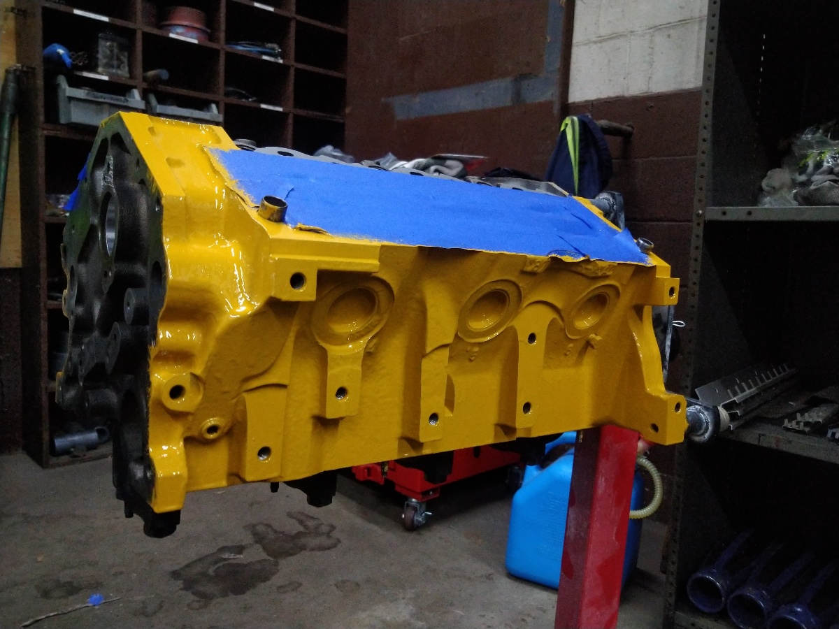

I want to paint my engine blue and white, these usually requires high heat enamels and they work great. I was hoping however to prevent it from ever picking up road grease, or at least that it could be easily wiped off. I've heard of glyptal, but that only comes in red. Are there other paints that have this property?
It's for the inside of the engine not the outside...
Glyptal - inside
Motor coater - outside
This is motor coater:
