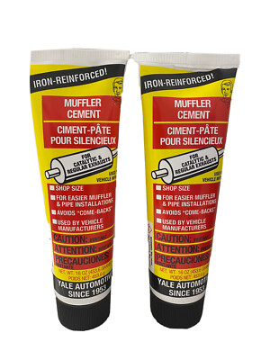

muffler goop and wire will patch it up and get it quiet and flowing...
there is screen and tiger weld patches combined with the muffler weld goop that will get ya by

If it is damaged beyond "muffler cement" covered with a good 3" butt joint clamp, then I recommend scavenging some decent junkyard tubing or complete exhaust.
In the past 2-3 years I have bought a dual 2" exhaust and a Borla Pro Xs muffler for $50 total; this is twice as much material that any single tube exhaust will require to fab up. To hold it together either The Walmart online or The Amazon for the needed number of simple butt joint and lap joint 3" clamps...usually 4 of them for $20!
Good luck ..)
