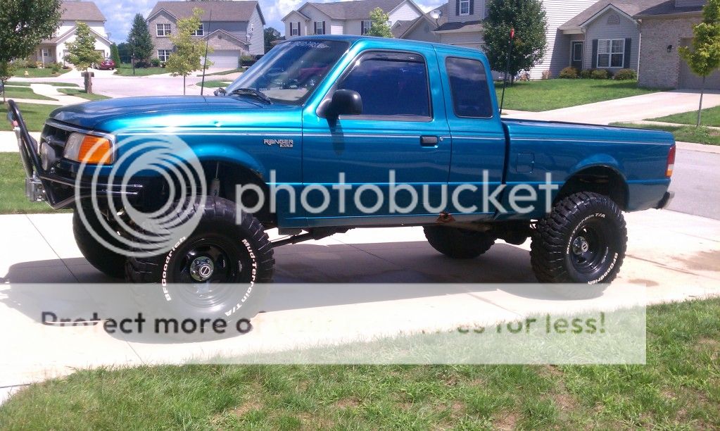

All cleaned up for tomorrow's show 'n shine at BFGoodrich.
