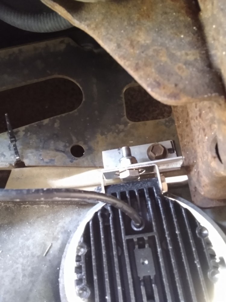

I made a comment in another thread that I made my own fog light mounts/brackets. A few people were interested to know how I did it. I used aluminum angle stock. The bumper has existing bolts near the fog light location. You can see where the existing bolt is in my picture. I drilled for that first, making sure that the angled aluminum extends far enough over that I could make a hole to line up the fog light. I bolted the metal in place, then marked the hole to drill for the light. Then, I hung the lights upside down. I got the angled aluminum from Lowes, and it took maybe 45min to do both sides. I hope this helps. (y)
