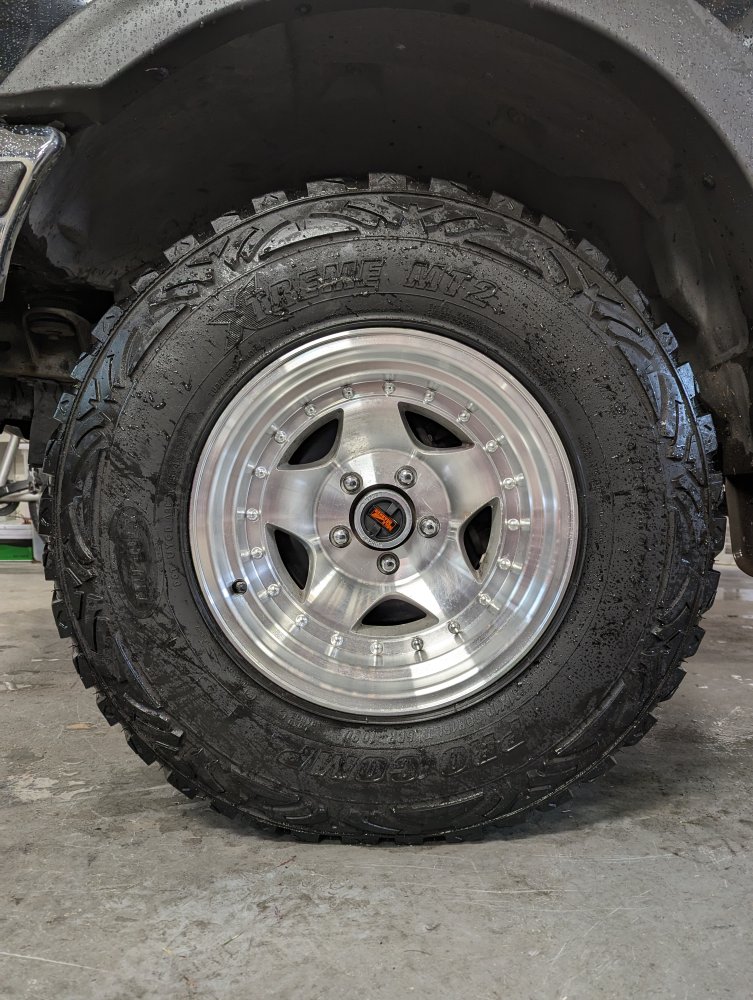

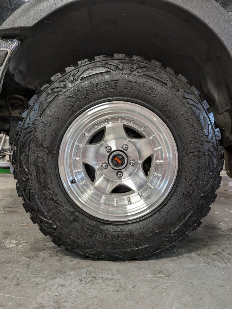

Since my Jan. 2nd post, the project has taken a slightly different route on wheels and tires. Sometimes I think things just happen for a reason. With the planned black steel "D" window wheels, I was a bit concerned about adding 9 lbs of rotational mass on each corner, the truck driving worse than stock and I didn't really want the "blacked out" look. They sold in a day and I was satisfied saving for new 31's and using the stock 15x7 wheels.
Cruising Facebook Marketplace, I found a great deal on a slightly used set of wheels and tires in the exact size needed:
Wheels: American Racing AR23 machined w/ clear coat fisnish 15x8, -19mm offset, 3.75" backspacing
Tires: Pro Comp Xtreme MT 2 31x10.50R15
They fit great and still have plenty of room for no rubbing. I love the new look of the Ranger!

Looking at all the clearances with the wider wheels, there is definitely room for 32x11.5's without rubbing issue. I'm still going to keep with the 31's for general driving.
The front on mine is leveled just by adjusting the stock torsion bolts/keys. They took 3 full turns on each side to bring the front up about 1.5". It isn't maxed out and there is still upward adjustment if needed/wanted. With corrected tire pressure on all 4 corners, the fender arches all sit perfectly at 36" off the ground. Couldn't get more level than that! To compensate for the raised front end, Rancho RS5000X extended length shocks were installed. Part #RS55374.
With the current setup, the truck rides great! Not being maxed out and with the longer shocks, there is still downward travel available in the front suspension.

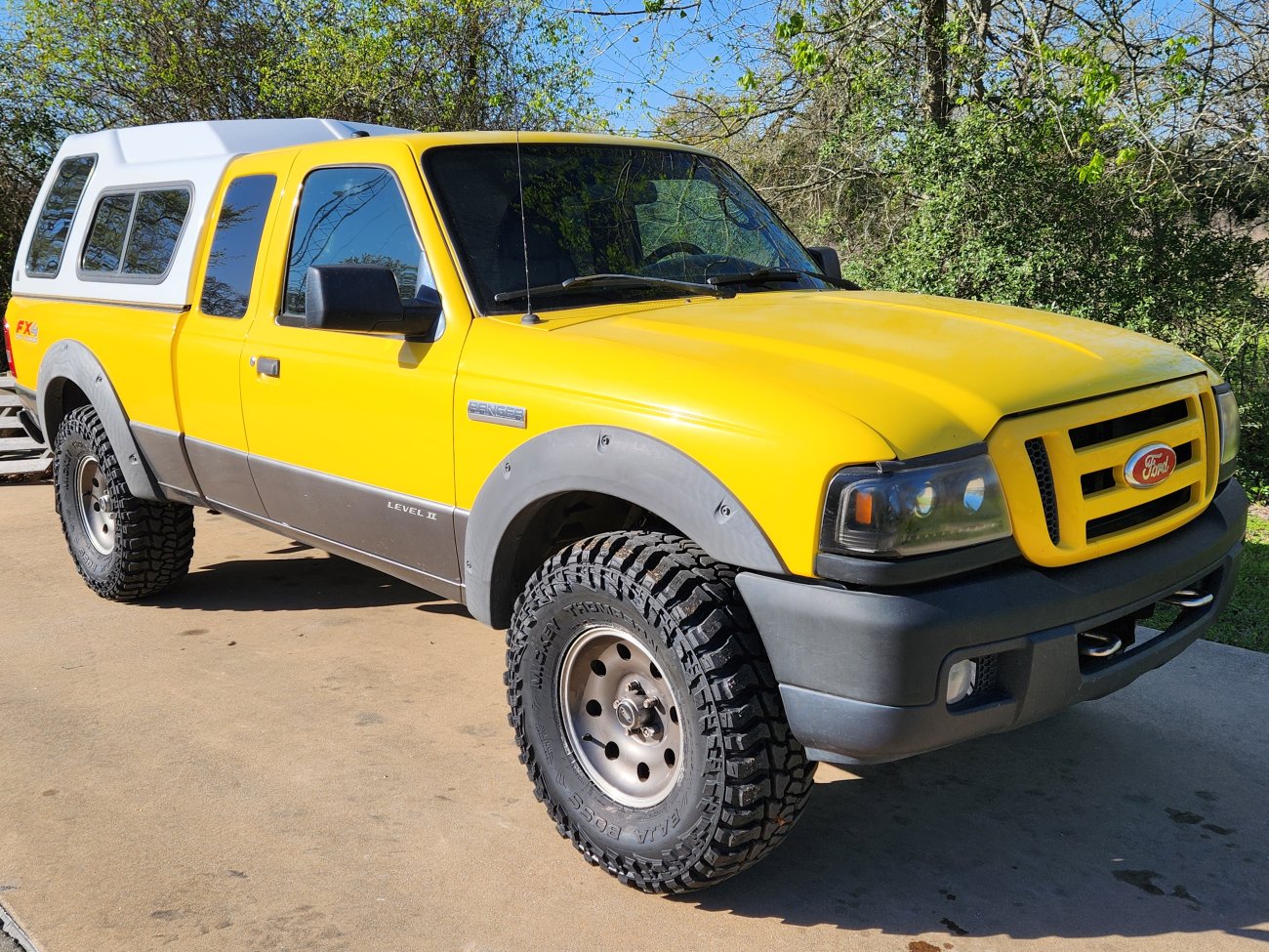

I just cranked my torsion bars, as I have a pre-2008 ranger. Why? A couple reasons. A- I wanted the truck to not be as canted forward, B- I am lazy and don’t have the time to install a proper lift, C- I am cheap and don’t want to spend the money on a proper lift, and D- I wanted to fit bigger tires.
The keys aren’t quite maxed out, but close. I can now comfortably fit 265/75R16 tires, which are basically 32”.
Someday, if I have the time and money, I’ll buy the superlift or rough country kit. Someday.

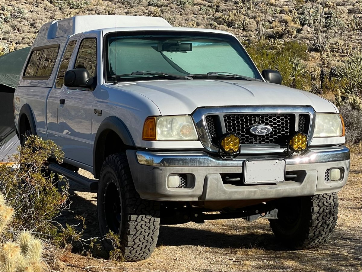

Torch 3in lift kit, which has the shackles in the back, and the bigger torsion keys. Haven't installed yet, I read I need to change the axle going from the diff to the front transfer case, or it will break. There is a cup like coupling instead of the standard splined slip yoke, which you can buy in a replacement kit.
I bought the lift kit cuz I wasn't sure if I would be able to fit a set of P255/??R17s with bigger rims on but they fit, I just need some wheel spacers for the new wheels; they are sitting a little too close to the upper control arm for my comfort, and a think a 1 inch spacer will put the wheels closer to where the factory wheels were (right now their a bit too inside the hub).

Changing driveshaft is not necessary for a torsion key lift. Driveshaft change is needed for lifts like Rough country and Superlift where the differential is lowered. With a torsion bar lift the differential stays in the stock location.
Can you post a link to where you found that information, I'd like to read it and try to make sense of exactly what they were trying to say.
While Torch claims 3" of lift with "without compromising ride quality", be aware that that may not be true for your vehicle. Adjusting the torsion keys up increases the preload on the torsion bar, and that will have an effect on ride quality. You'll also be pushing shocks closer to their limit of travel which can have an effect.

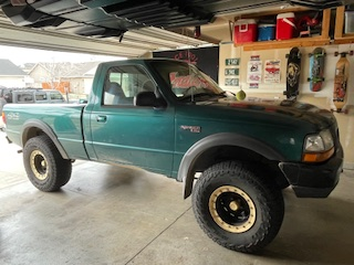

I did it, put 33s on. With a 2 inch coilover front mod, the prior 32s did well. Try to find any in my favorite brand, NOT. So here it is. 33 x 12.5 x R15 just touching CCW and CW barely (1/4") sway bar rub. Can't even feel it. I'm still intimidated however. Need to look into longer rear shocks and then either new leaf springs or just a 1 inch block for the rear. When I'm on the trail, I'm loaded. That is the truck.
I ordered some longer rear shocks. Went with the correct length Rancho RS55126. I have some 7/8" aluminum plate that will act as a lift block for the rear end. Waiting to see what the locating pin size is. Either 9/16" or 5/8ths inch, then drill & press in a pin. For the front to keep the whole rig level, I'll need to relocate the upper coilover mounting point 3/4" - 1 inch further down in the shock tower. Been using grade 8 x 1/2" hardware. I can keep one of the two holes currently under use & simply drill the new second one. Will be easy, only have to remove the wheel, unbolt the upper shock, lay it over in the upper A arm & get to it. Then back to the alignment shop. After the T storms pass later this week, I'll park the Challenger outside. A garage shop is better than none. All because I had to have 33s. :)

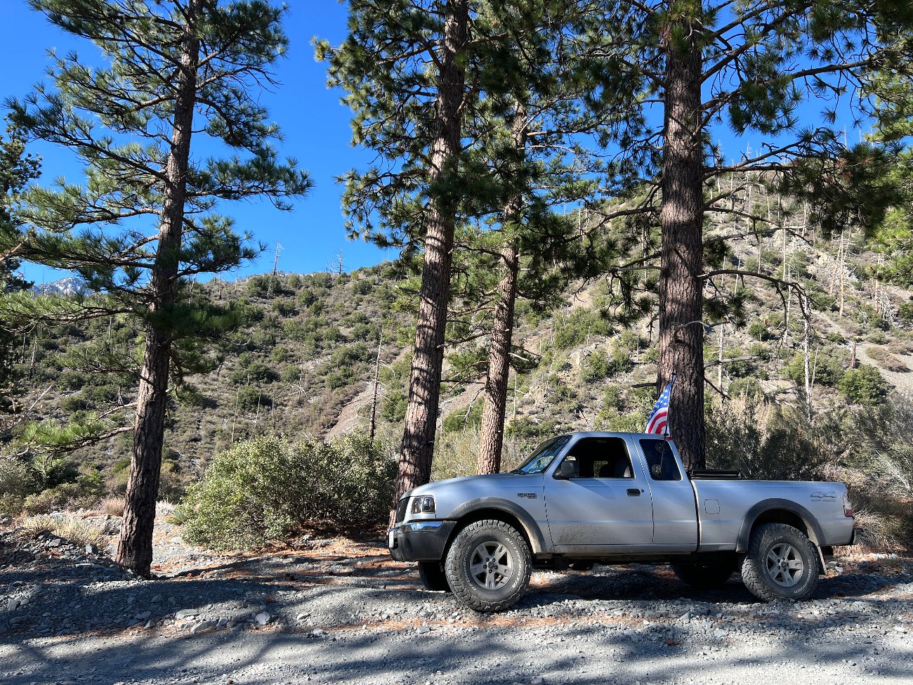

Brand new to the forum. Had my Ranger for 3-4 years now. Just rolled over the 200,000 mark yesterday. Early this year I got it leveled out and put some 33's on it. Okay so just shy of 33", but I'm rounding up. It does rub a bit at full lock, but damn does she look good. When I can afford it I'll probably lift it up more to hopefully get rid of the rub. Very open to suggestions.
Been offroading a good bit so far since I got the tires on it. My previous offroad vehicle was a Jeep Renegade, so needless to say this is a nice step up. It was definitely a learning experience, especially since this is my first manual transmission vehicle. Very different world, but loving the extra control.
