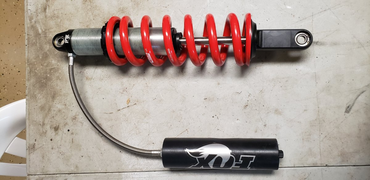

Which shocks and spring rate did you go with for the coil over setup? I've got the bits coming next month for the coil over mount. Also hoping a used lift kit might show up at some point to buy rather than investing in a new one.
It has been a while since I put the lift in so know which shock other than the brand I am not sure.
Shock were Fox and purchased through a special buy from 4WD... !
Rate of the springs was 750#, because I was going with a Winch that never got there.
Truck run good, when I put the lift in I use SuperLift rear Shock but they were the wrong ones for my setup.
I took my truck to the local Off-Road Warehouse and they put on two different sized shock.
I have the FX4 Large Tubed rear axle, maybe that was my problem, but all I know is once ORW got through with the front rebuild and the rear replacement shocks the truck had a great ride and still does two years later.
I brought it to ORW two weeks ago and had them check out the shock condition and all was still good.
There are articles (Postings and How-Tos) on other Ranger Sites about the Coil-Over Kits and How-To's... check them out to get an idea of what was used.
That all I got !
Thanks. I've skimmed through those articles in the past and will definitely read them more thoroughly when the time comes to order and install parts. 750 vs 800# springs is one of the things I need to decide on. No winch any time soon, but I do have the V8 sitting up there.
I went with the Wulf leveling kit. I didn't want to go too big and the only thing besides a key lift/level kit would be a 4 or 5 inch lift. I do have plans for a body lift in the future but I'm not sold yet on what size to go with.
The FOX 2.0 with Eibach 800lbs/inch springs did the trick. No winch. I had to push these up more than I expected to get it leveled, but now that the springs are broken in with 1kmi, time to let it down a half inch at the tire edge. Too bad because I love the weight over the rear end, but the ride is a little rough sometimes. Heck, the A arms are stock and I do have full travel at ~40+ miles/hr. So I'll try taking out a couple of turns and see if I get some more betta smoothness. There's ya some suspension tek jabber. Longer A arms coming after I come up with the longer axles. That's where the $$ is. I'll have to get some CroMo 1" tubing and fire up the Miller' Tig. I love to TIG. But the travel will be smooth. Will have to push the upper shock mounting up. With a hoop. So if yall want a smooth operating front suspension prepare for big changes. What I did here is nothing. Easy to reinforce what is already there. Gotta know how to install supporting structure. Not everything that works is "bolt on", only (for the most part) is cosmetic.

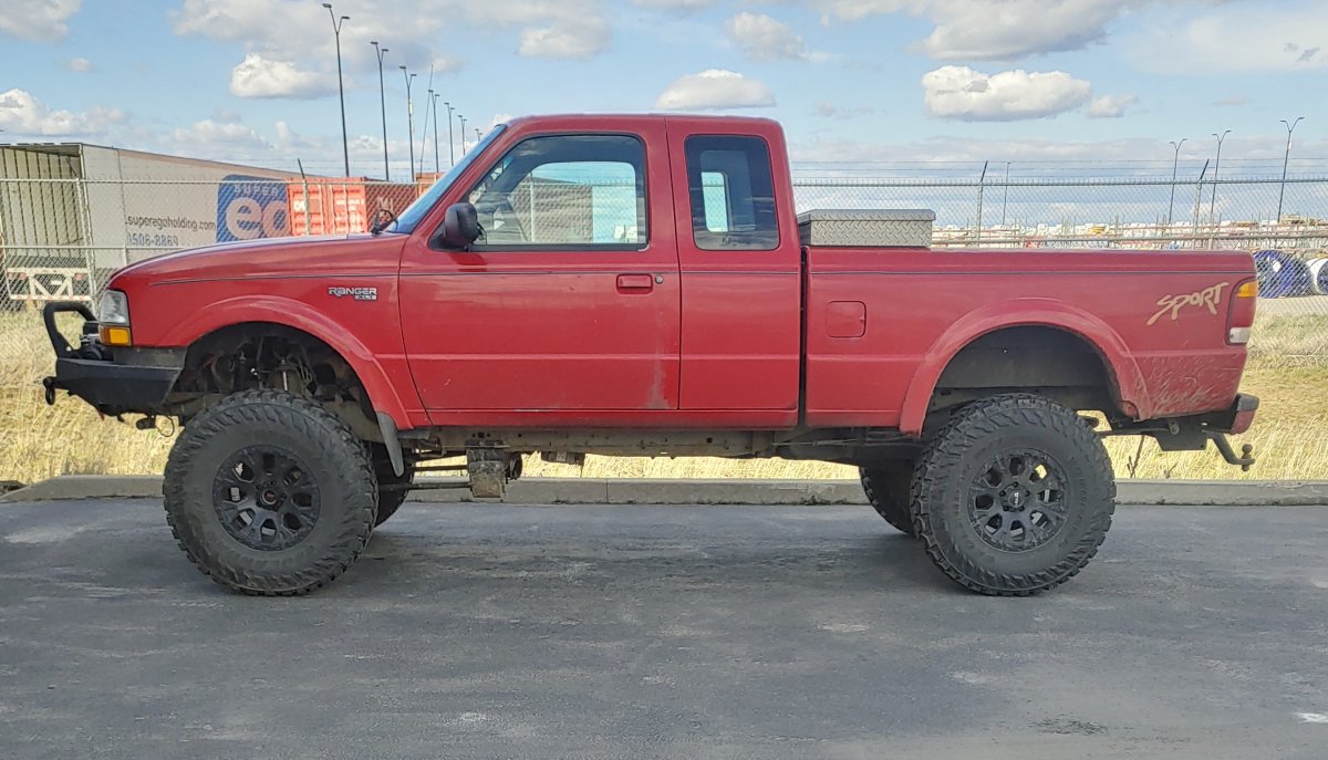

Did a little of all of them. 1999 Ford Ranger excab sport 4x4. Installed 5 inch Rough Country lift, Explorer disc brake LSD rear axle swap with new welded on spring perches, Explorer rear springs, 3 inch rear lift shackles, 3 inch lift front torsion keys, 3 inch body lift, and sitting on 35 in tires.

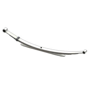

Junkyard explorer leafs for a cheap few inches of rear lift ~$63 for both
Everything else stock. Although, at the same time as installing these I installed many other new suspension components, new tires and got an alignment. Threw a heavy fiberglass camper on the back to load the rear and bring it down. Installed the new T bars and cranked as little as possible to level it out. Relatively smooth riding and has proven to be solid long term so far. Loads weight nicely, isnt too stiff. Fits chunky size 265/75/16, or over 31" without an issue. Very minor rubbing on the wheelwell rubber splash at full lock. Could probably go bigger but see no need to.
I ran into complications with explorer-ranger leaf compatibility which should be sorted out here.
