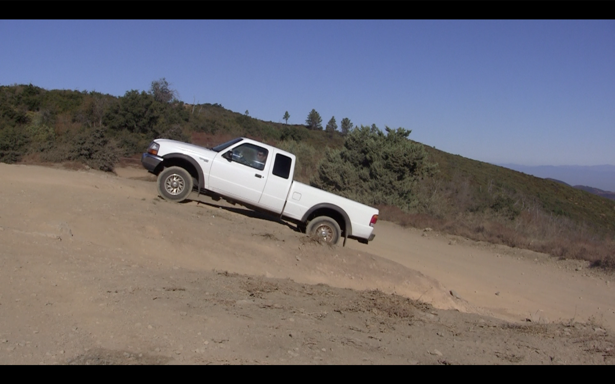

I've had the 1999 Ranger XLT 4X4, 3.73 LSD, 4.0L with tow package for 4 years and have just started to go off-road with it. The truck is showroom stock with the exception of manual lockers on the front replacing the vacuum hubs. How capable is this vehicle?
Should I start with skid plates or bumper and winch?
Your 99 Ranger should be fairly capable but will be limited in clearance. That limits where you can go to a degree but you can still go many places. You just need to be careful. I think it is better to start with taller tires like 31". That got me over a lot of stuff for many years but my 89 STX had the factory 1.5" lift also. I never used a winch but it can get you out of trouble if needed. Skid plates (and rock sliders) will help protect vulnerable areas, which you might need as you try rougher stuff. Learning where your differentials are and keeping the big rocks away from them is very important.
BTW, the term lockers is normally reserved for locking differentials. What you have is locking hubs which is a different thing.
I don't have a winch or rock sliders. I do have factory FX4 (Level II equivalent) skid plates which are not heavy armor but are better than standard factory skid plates. I also have 33" tires and 4.56 gears. That has just let me get into rougher stuff and I still have a few light scrapes on the bottom. I have not hit the differentials because I pay close attention to where the big rocks are.

Thanks for the info. I just bought new tires two days ago. I should have asked this question first. The truck needed them as the spare was the original, 20 years old never on the ground. The other 4 tires were made in 2011 and showing signs of rot but still with plenty of tread.
Thank you for helping with the terminology on 'lockers.' I guess my rear diff is a locker with the LSD option.

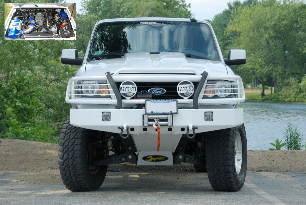

It's been a long time Jim... here's the write up from my web site on my 2007 Ranger Sport 4X4!
I had a 4" Superlift kit and also ran a set of BellTech 6400 rear shackles installed. I replaced the 3" Superlift rear blocks with a pair of Skyjacker Softride 4" lifted leaf springs and had them installed with the original 2" factory blocks and my BellTech Shackles. These leafs offer a little more lift and a much more pleasant ride than the blocks. The ride was further smoothed by four ProComp ES-9000 Nitrogen Gas shocks!
For tires, I ran LT285/75R16 (33") ProComp Xtreme M/T's. I had them mounted on my 16x8 American Racing Outlaw II aluminum wheels. With the Superlift, everything fit neatly under the truck and in the wheel wells with no clearance issues. The increased circumference however, affected the gear ratio. For that reason, I had new 4.10 gears installed at both ends and a Ford Racing "TrakLock" limited slip carrier in the rear. It pulled nicely now, even with the taller tires. That's it... for the suspension!!! ;) (Oh, and as per the insert, she had a Ronald P. Caster M90 Supercharger Kit to help turn those muds!)

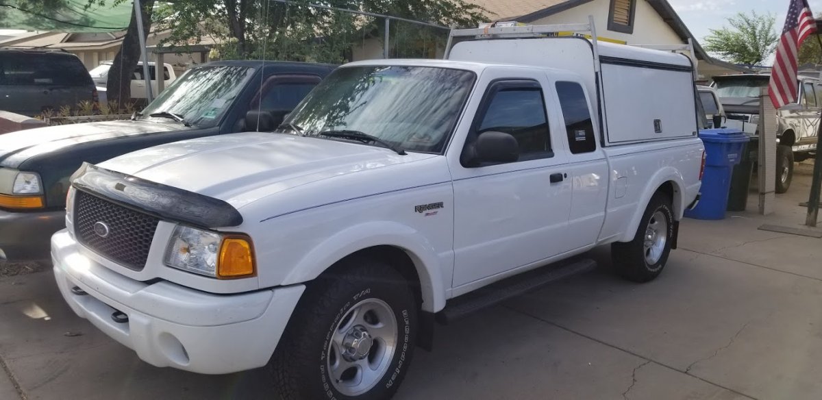

needed some room because factory tire size rubbed a little bit plus I wanted it level and I use it for work

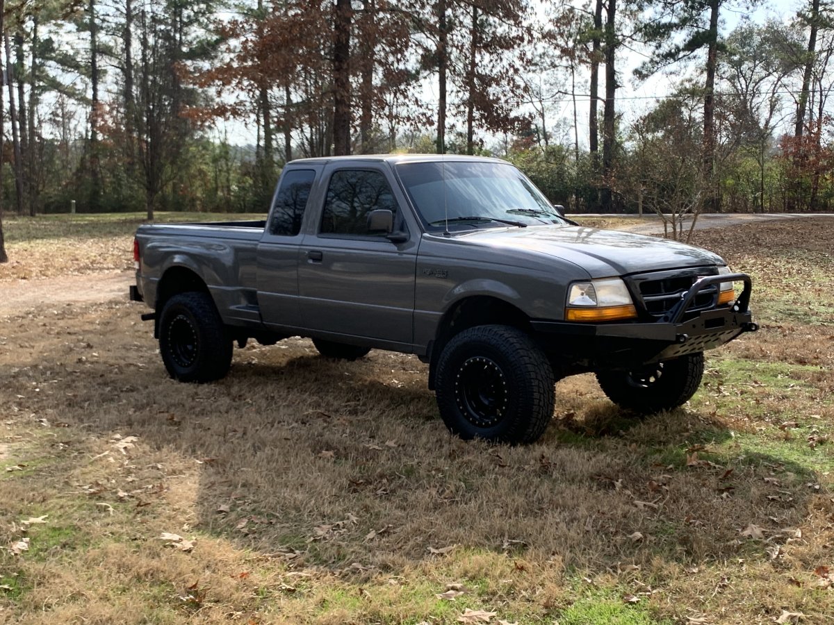

Bought the Solo Motorsports stage 2 long travel kit because, well, it's the best "bolt on" kit. Cut and turned 4" over per side TTBs. If you didn't need an engine cage I'd have got the stage 3
