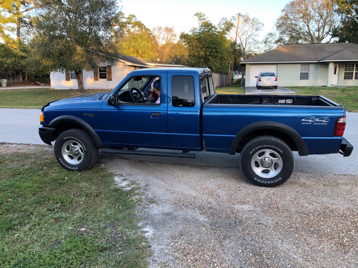

New keys and shackles. Also put some new Rancho 2 inch shocks. Didn't want to go too crazy because it'll be used to tow a small trailer for my business this summer.
3" Keys, 2" shackles, longer shocks.
Edit: Been running this setup for awhile now with 32" tires on stock wheels and am very happy with it. Ranger II.jpgRanger.jpg
How does the front end feel? I'd do the same thing, but I'm worried about the cement truck feeling. Real sweet truck. A keeper!
-Doug
-Doug
I got new keys and taller shocks for it. Its up a couple inches and drives really nice. Probably better than stock.
-Doug
A little stiffer than stock, but livable IMO. I reinstalled the preload bolts to the original length as recommended, but wound up backing them off a couple of turns to soften the front a little. Even doing so did not significantly decrease the ride height.

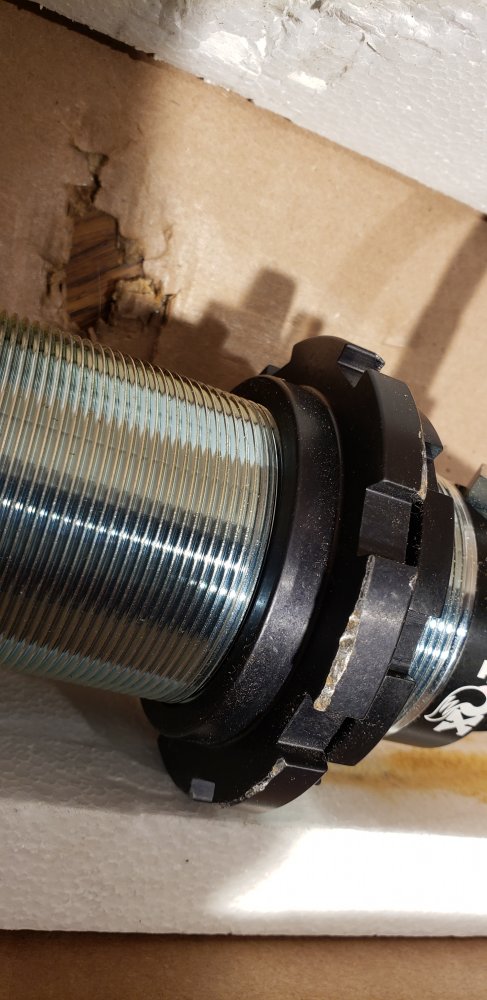

4WD shipped my shocks in the display box, damaged the tension nuts. Waiting for 4WD to get back to me. Should have Shawn's brackets delivered in a couple weeks.
