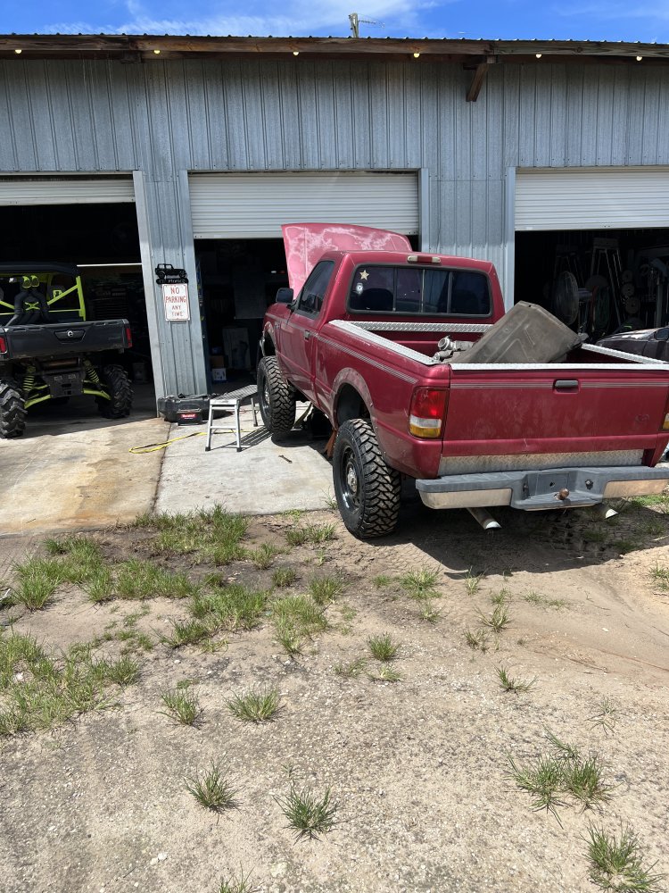

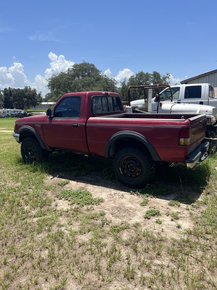

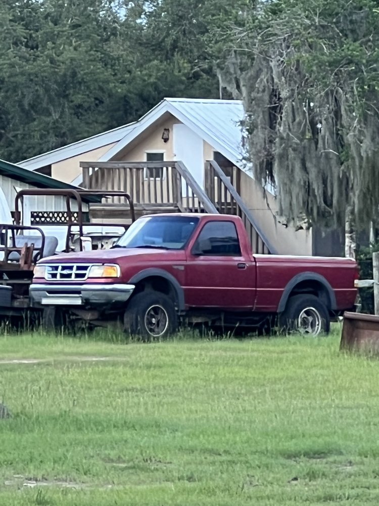

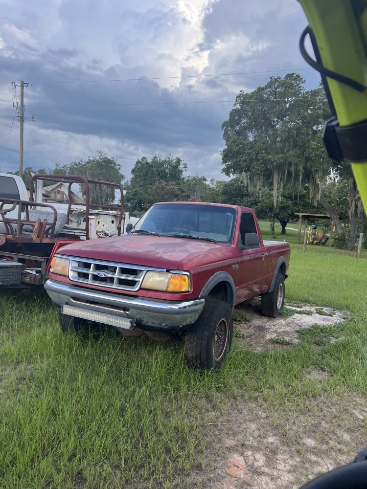

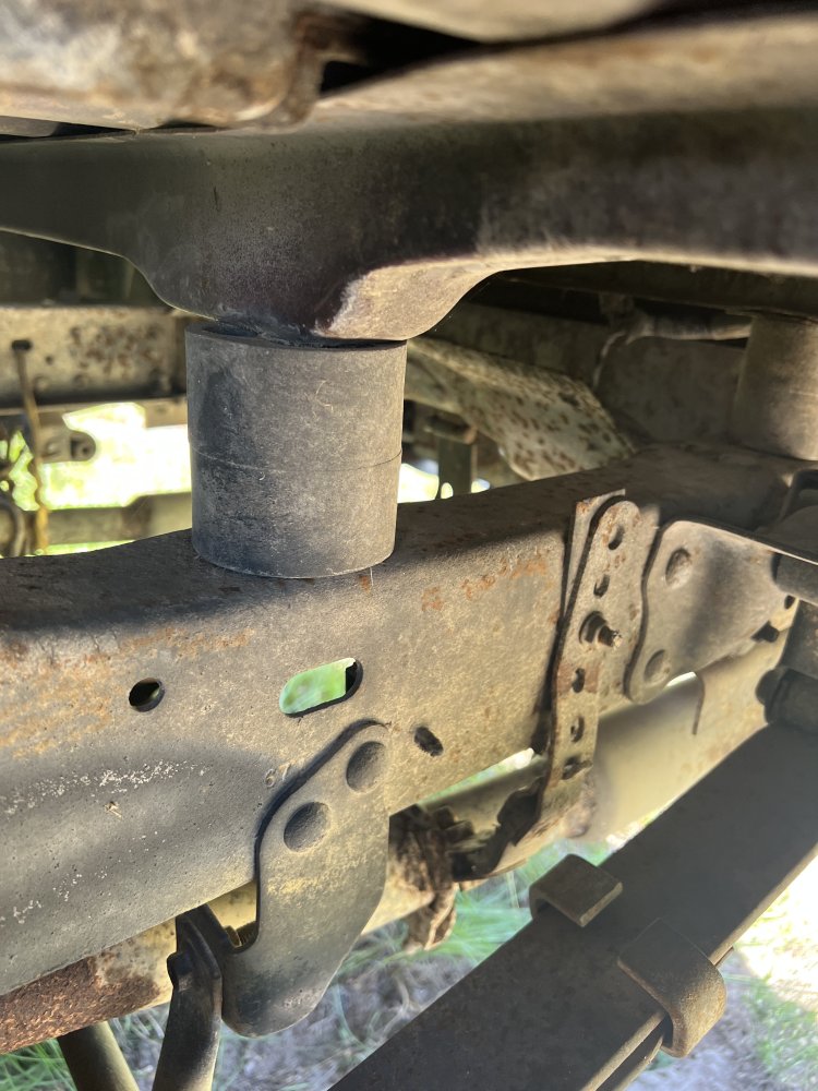

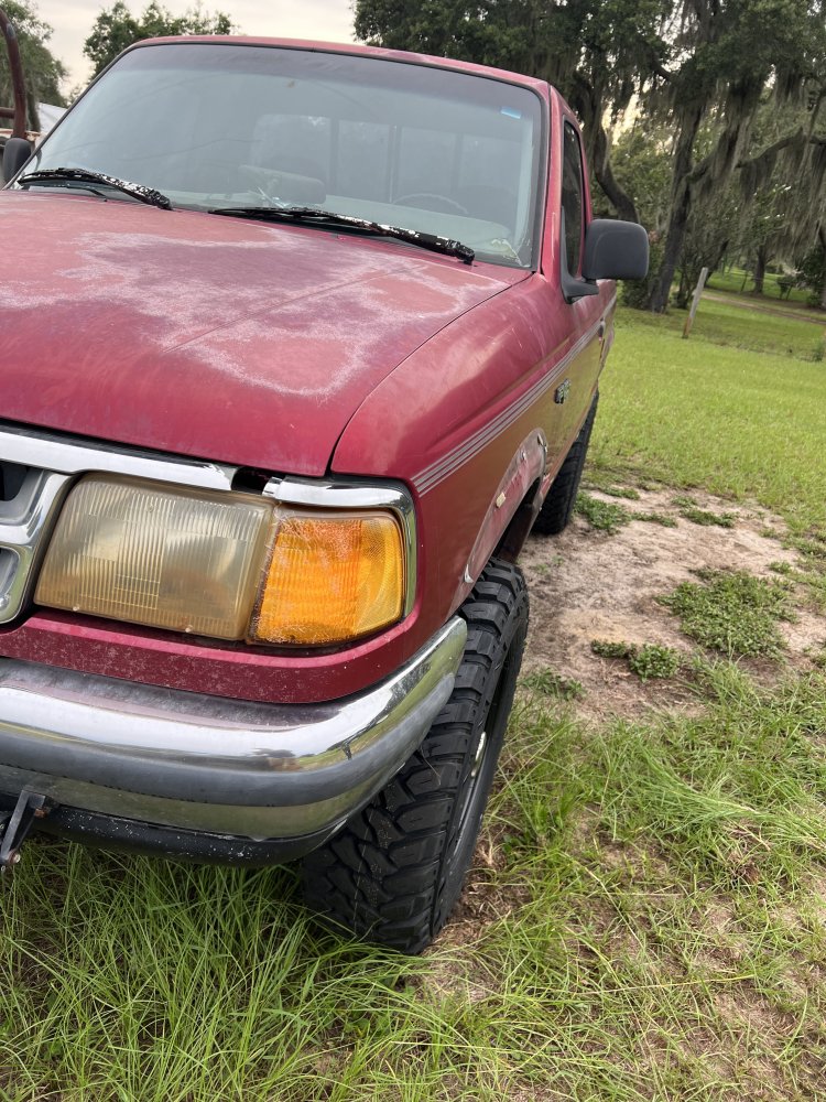

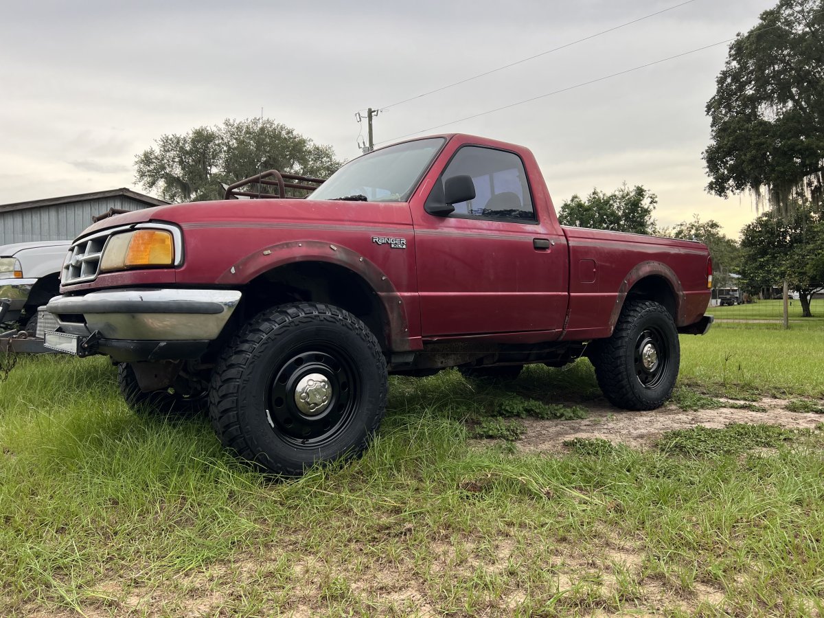

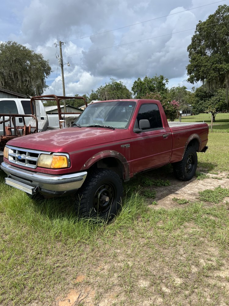

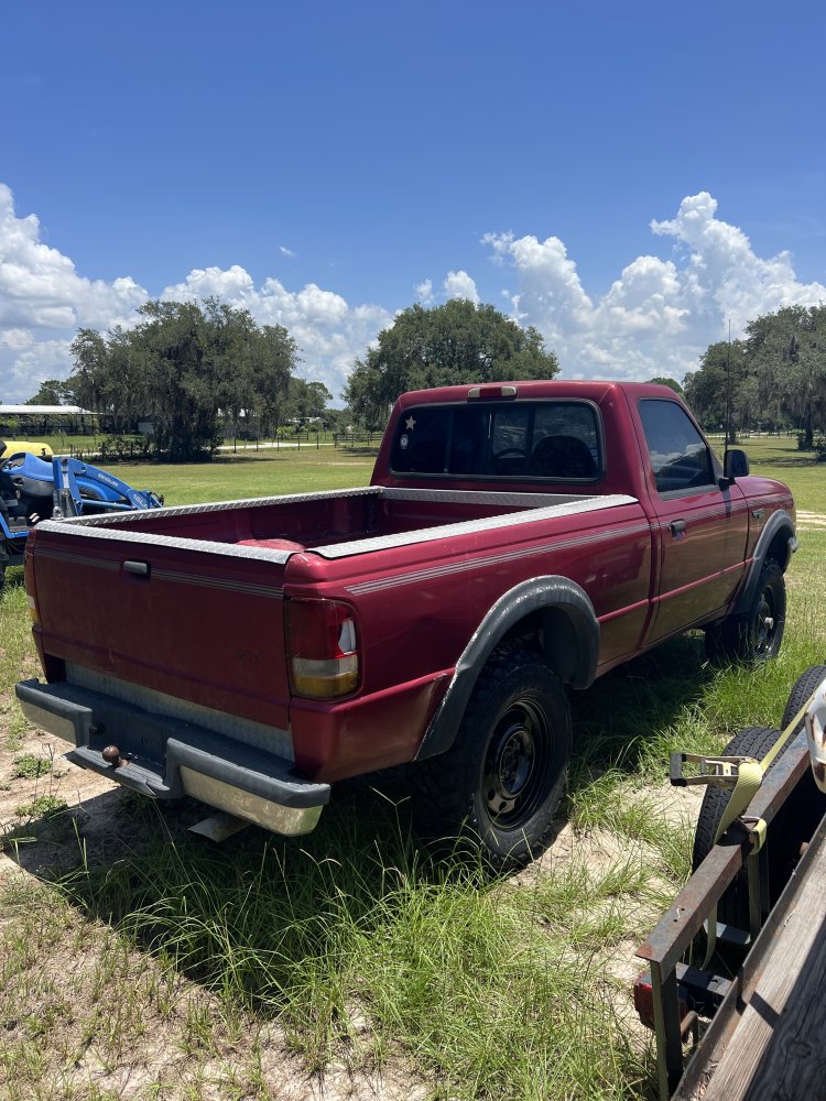

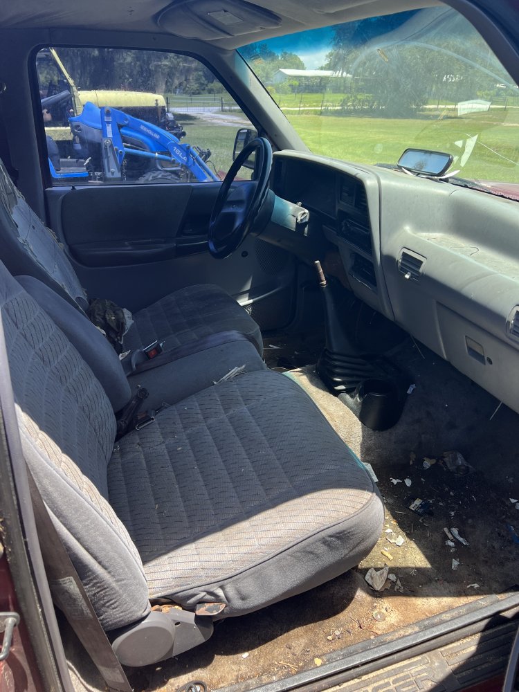

Just picked up my fourth ranger and finally the combo I’ve always wanted. It’s a 1994, regular cab, short bed, 4.0 OHV, 5speed manual, 4x4 in my least favorite color of red. I’ve had two 2.9s and a 3.0 in the past and didn’t care for either motor. I was actually secretly hunting for a 2.3, 5speed to throw decent axles under just because I think the 2.3 is a cool engine and easy to work on. Instead, this thing popped up in my neighbors yards with a blown 4.0 for $500.
I sourced a “low mile” 4.0 out of a 96 explorer for $500 and the shop with the motor is installing it in a week or so for $350.

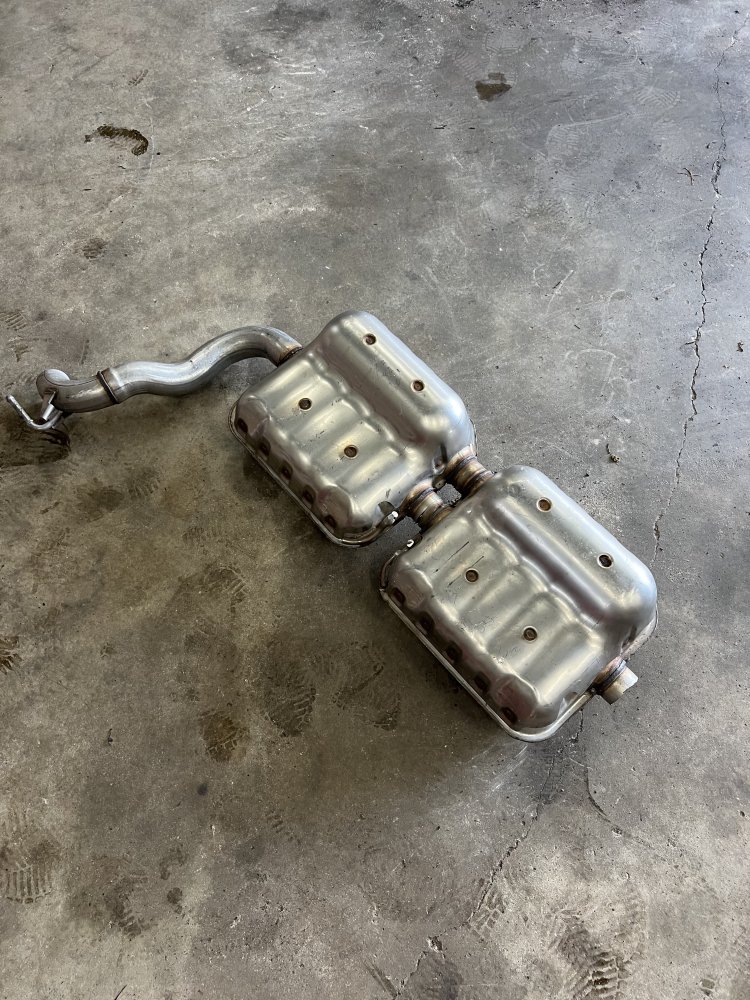

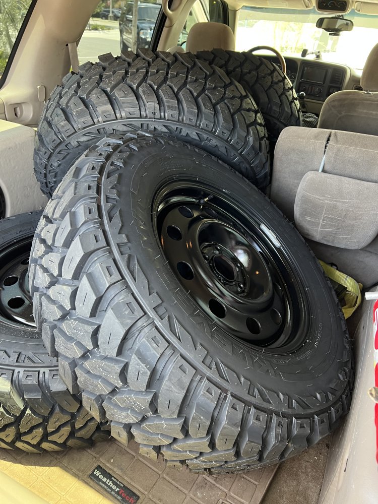

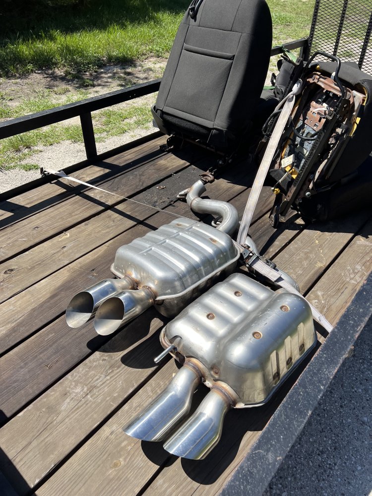

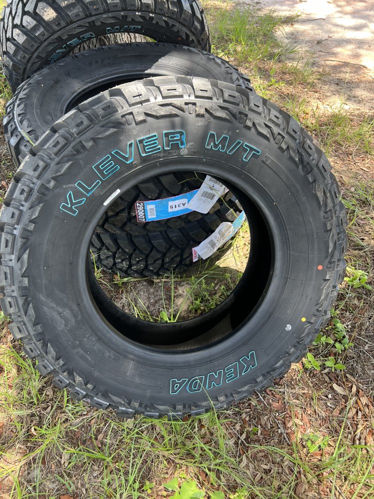

I don’t plan to do a ton to the truck right away besides fixing all the little things that pop up, removing the straight pipped exhaust and fabbing up something using a set of free 2018 GT mustang mufflers I found, and installing some new 255/75/17 Kenda KR29 MTs on crown Vic steelies I just picked up.
After I break an axle or need rear brakes, I’ll get an FX4 level2 8.8 with the factory 4.56, and regear the front to match. With the axle swap it will get 97-03 F150 leafs and a shackle flip, along with better shocks to match on all 4 corners.

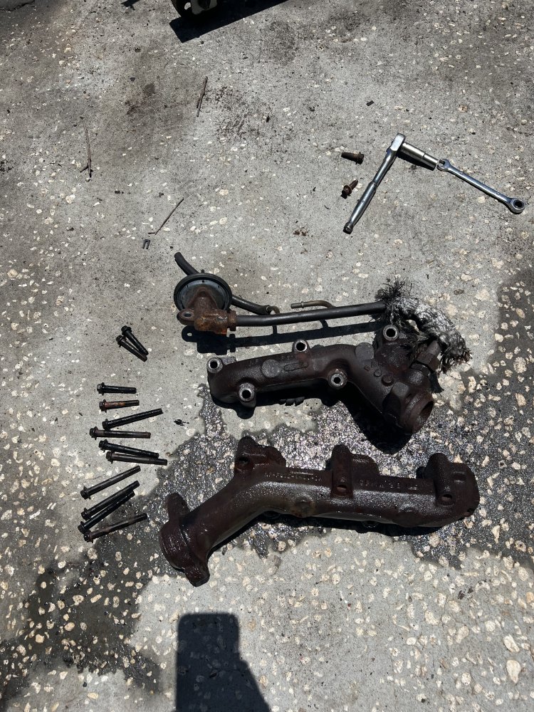

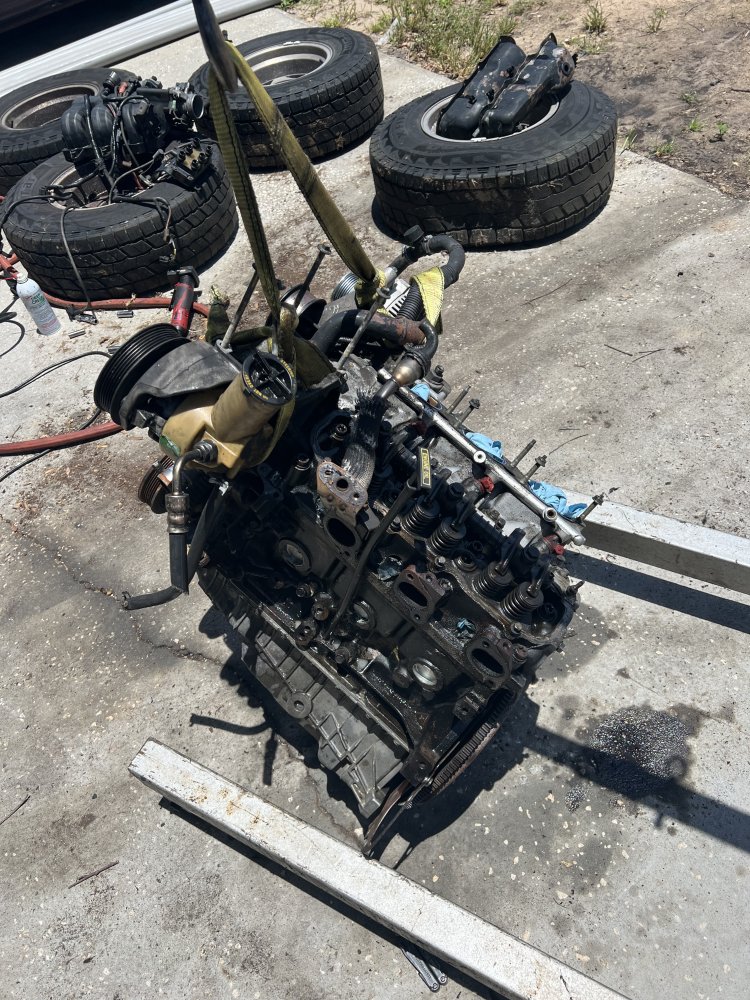

Getting stuff done on this thing today, wheels and tires are on, motor tear down/ cleanup has started. Decided to hell with waiting on headers I don’t want to mess with the EGR at all so I zipped that junk off surprisingly easily after some creep oil and M18 Dugga Duggas. Gonna paint the valve covers tomorrow and reinstall them, need to order intake gaskets, the headers, egr block off plate, and spark plugs.
One of the next things is ditching the body lift.

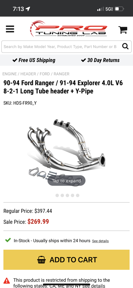

Ordered these headers, painted the valve covers for moar powa, and pulled the dry rotted fender flairs off.

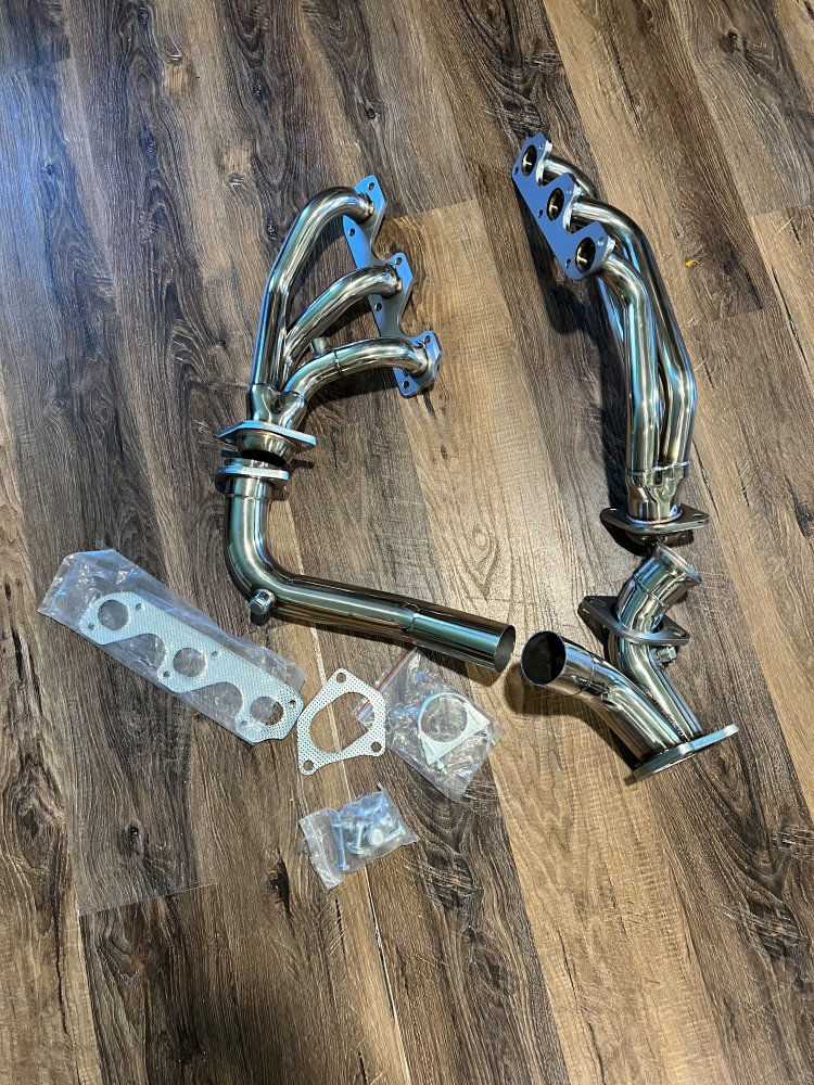

Headers showed up and for being an EBay/china product I’m pretty impressed. Most of the welds look good, some are obviously done by a machine, and only one spot looks like they got too hot and burned some of the stainless properties away. No big deal, down here stuff doesn’t rust bad anyway.
The only weird part will be adapting a single exhaust to the oddly shaped flange on the y pipe merge. I don’t think the factory one exists on the truck anymore so I might have to go junk yard hunting. Gotta find a bolt to block the egr port as well, or I might hack it down more and just weld it in.

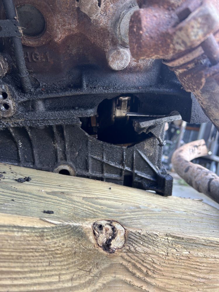

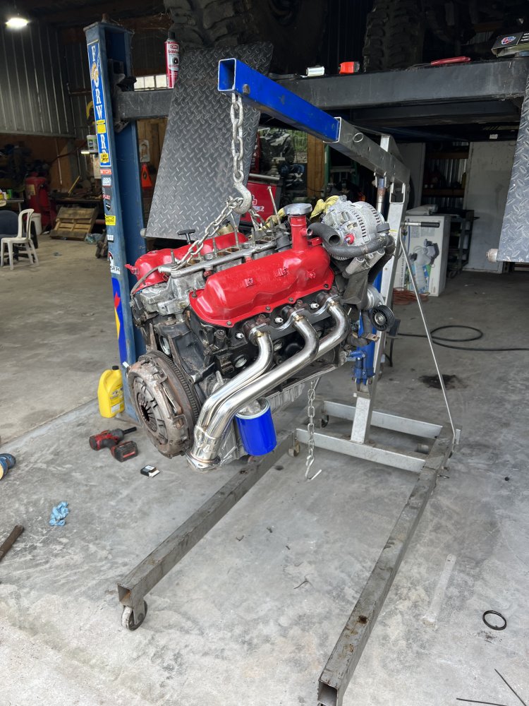

Got started on the motor swap myself today. Actually got the new motor in but due to a rod windowing the block and destroying the starter on the old motor I couldn’t start it up today. Everything has gone well except that I didn’t realize the 2wd explorer oil pans don’t have a spot for an oil level sensor.

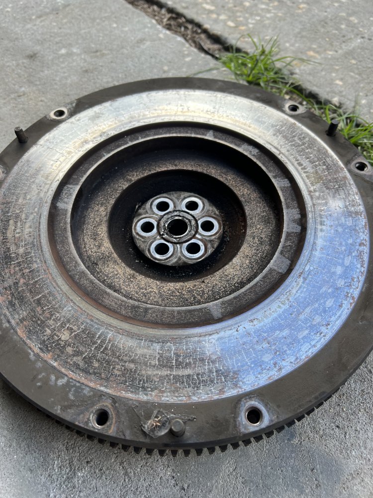

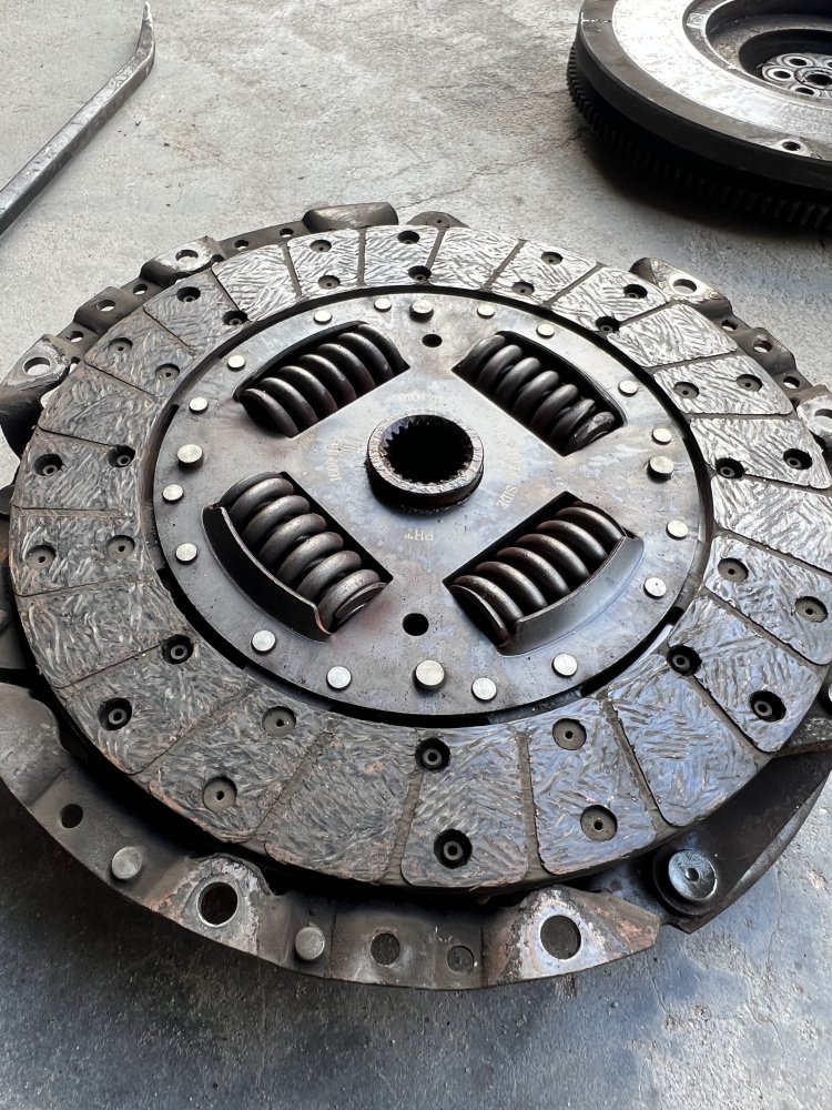

The clutch looked alright enough to reuse and I halfass resurfaced the flywheel.

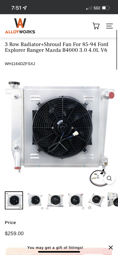

Waiting on the starter to show up tomorrow, along with spark plug wires, and a new belt. Then I need to figure out a radiator/fan setup. Someone did a crap job if installing an electric fan and the wiring shorted which may have caused the engine failure.
I’m looking at a $250 kit that seems to have just about everything and looks pretty good.
