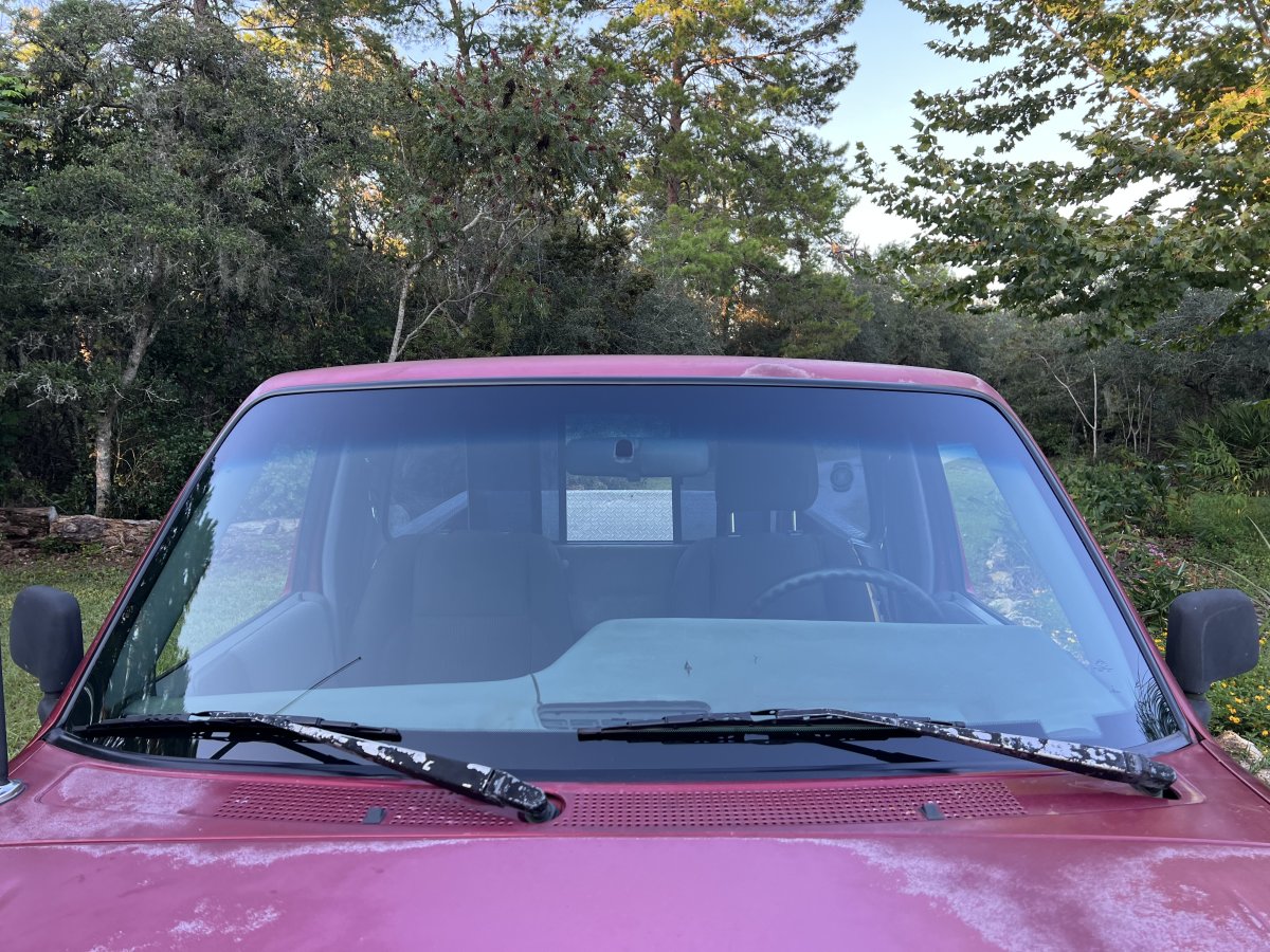

Freaking windshield dude said the glue was harder than a ministers cack and he wasn’t able to do it in my yard like planned. So I had to haul it to their main shop, and they knocked it out right before close today. It looks so much better and now it shouldn’t leak.

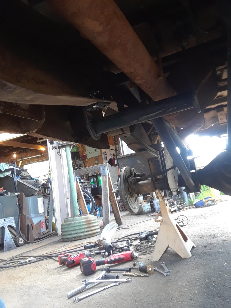

Here are some pictures, engine looks stock outside, inside is a true vulcan 🖖 😀..I removed the whole harness from the donor and ecm, etc to install in mine when the engine was installed. Everything is matched as it was. Have ran a 2 row radiator for 20+ years..using a 130 Amp alternator, some extras I have added thru the years. Some suspension pictures.
Dang that thing is beyond clean! Those radius arms and traction bars look awesome. Having the trac bars come all the way up to the radius arm mounts allows for a ton of travel without binding. Gonna have to keep those pics for when I decide to make some.

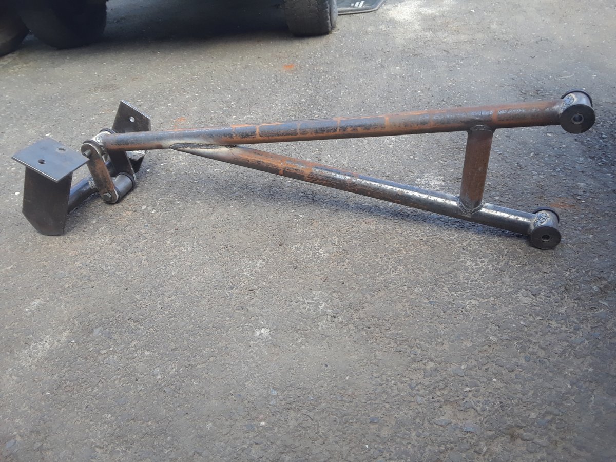

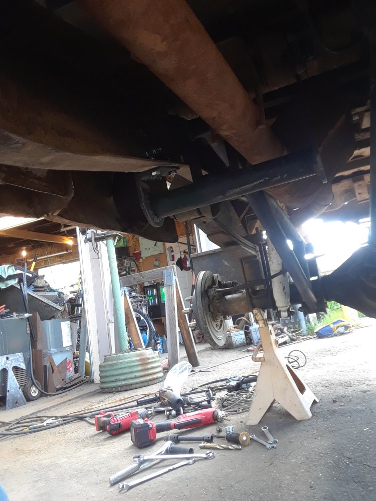

Please refer to this when you build yours, this setup has inspired a few thru the years. Yes the bars are mounted right above the arms on the frame. Using the stock arm brackets, most arms are mounted at the trans crossmember..these are mounted around 6-8 inches past the trans crossmember. Don't let the cleanliness fool you, this truck has gone the mountain trails in mud, dirt, gone to the desert dozens of times, drove on the beaches, etc. Don't do much of that anymore with it as I am older and wanna preserve it now, I still take it a mountain trail here and there as I now live in Northern California.

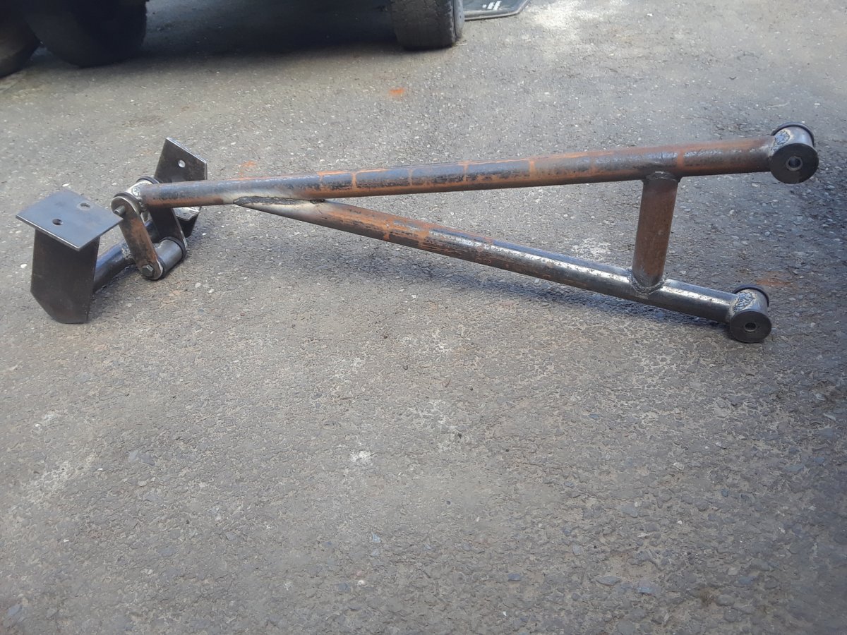

Ladder bar type traction bars are fine, but can limit suspension travel. I thought about building that type but went the other way with no regrets... I have under $100 in parts in it, just Rough Stuff bushings and some tube from the scrap yard.

Longer radius arms are next on the list for the '90 but I was getting tired of changing radiators due to axle wrap so traction bar was far more important...
That single triangular bar with a shackle is exactly what I ended up putting in my Silverado with the supercharged ls. I went through several rearends due to wheel hop and finally picked up a 55” shackle style bar from Off Road Design. Completely cured the wheel hop and has excellent travel with a custom pack of deaver springs.

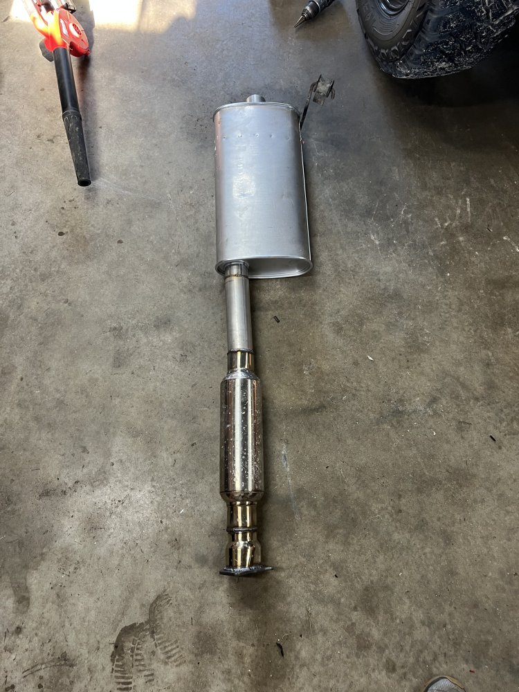

Oh I also finished the exhaust and it’s fairly quiet for what it is.

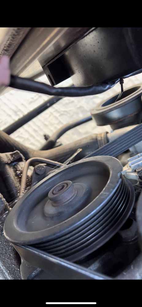

Lastly I’m not sure what this irritating sound is that happens on start up. It sounds like the flywheel is catching/rubbing something thin and metallic. It only makes the noise for a second or two and then is gone and stays gone while driving. I can tell my first gear synchro is kinda crap I’m hoping it’s not the input shaft bearing or something. Maybe I’ll get a video of it tomorrow.

Okay everybody let’s play, guess this sound!
Sounds like the starter is hanging up.
