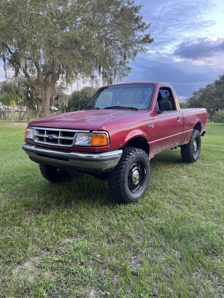

Dans 94, RCSB, 4.0, 4x4, 5spd

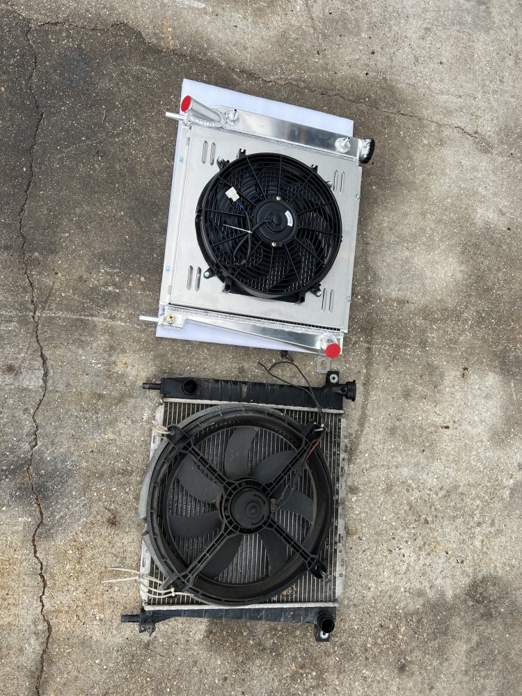

Tried to start it today finally and it would turn over but didn’t want to fire off, even with ether sprayed down it. Also found out the filler neck has a huge hole in it so that needs replacing. Waiting on the radiator to show up still too, but hearing it turn over was a good sign.
I’m a moron and have the firing order wrong, I looked too quickly at the coil pack order when I was working on it because it was starting to rain. I’ll try swapping it and hitting the key again tomorrow!

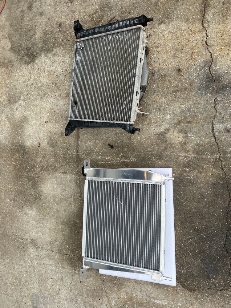

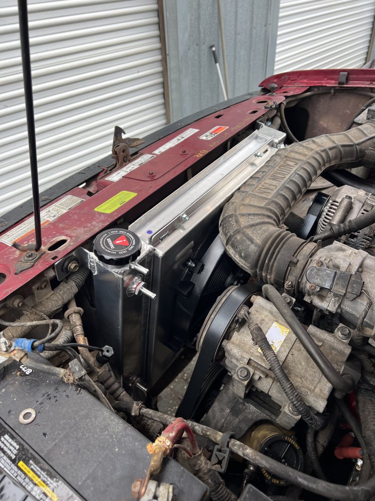

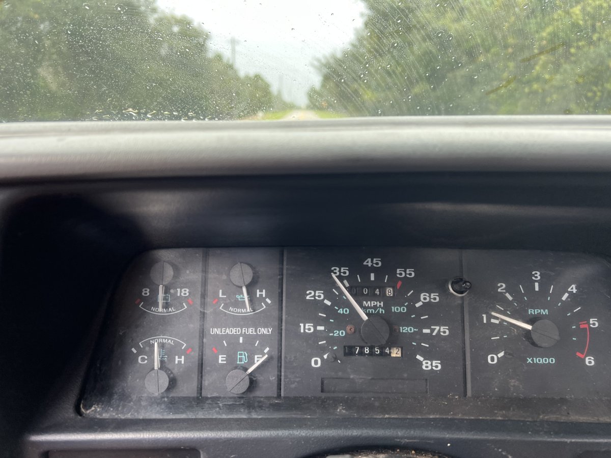

Slapped the radiator in, fixed the firing order, bolted they pipe up (still no real exhaust), and took this thing around my neighborhood! The 4.0 is peppy for what it is, need PS fixed, AC charged, exhaust finished, 4x4 looked at (I think it’s the hubs), windshield replaced, and the interior completely cleaned. So far I’m thrilled tho! Just under $3k in and it already has a lot of upgrades I wanted to do.

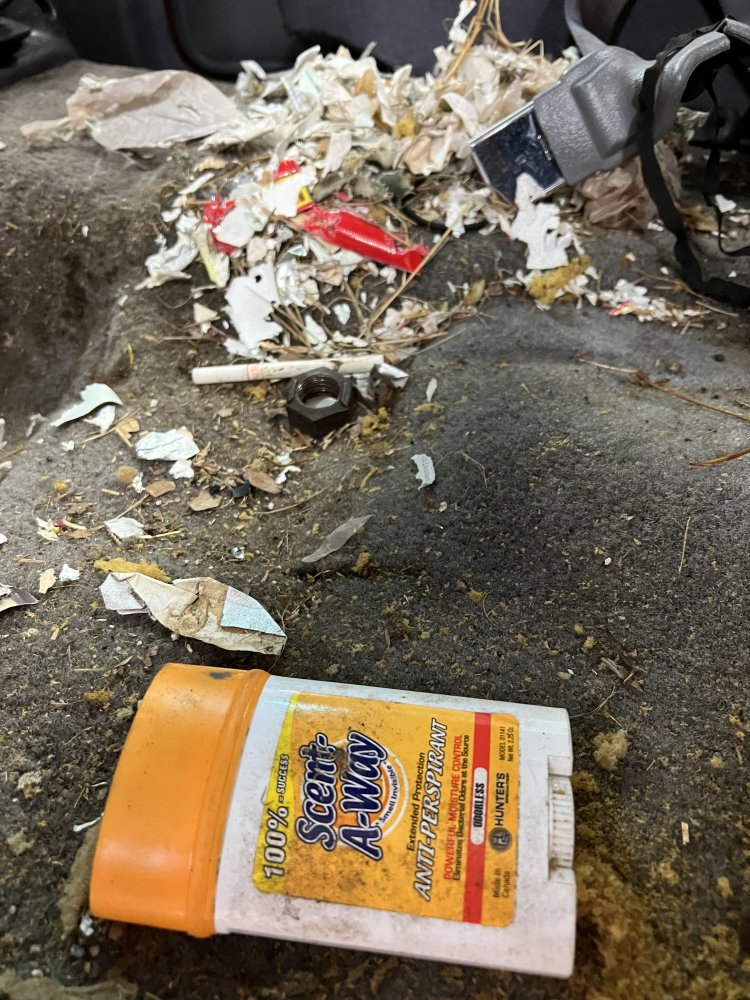

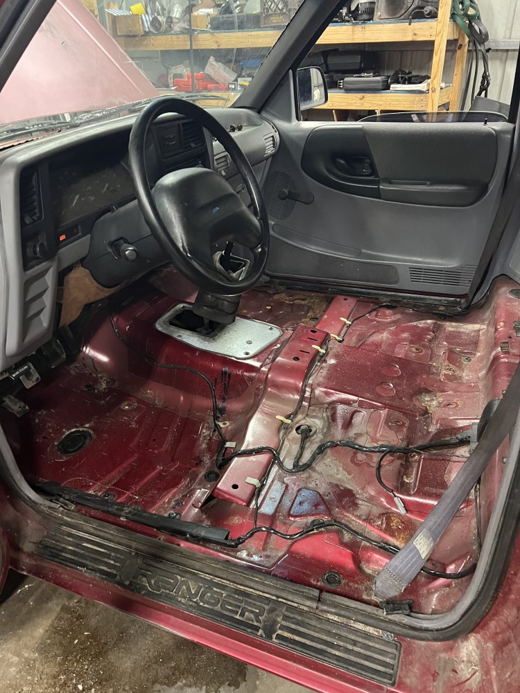

Started by stripping the interior today, then found the tailgate badge under the seat so it got glued back on. Then vacuumed down the AC which sucked down past 30# and held for over an hour. I stuck a can to it and it slurped up 12oz but the compressor is not kicking on. Instead of jumping it, I just left it be for now.

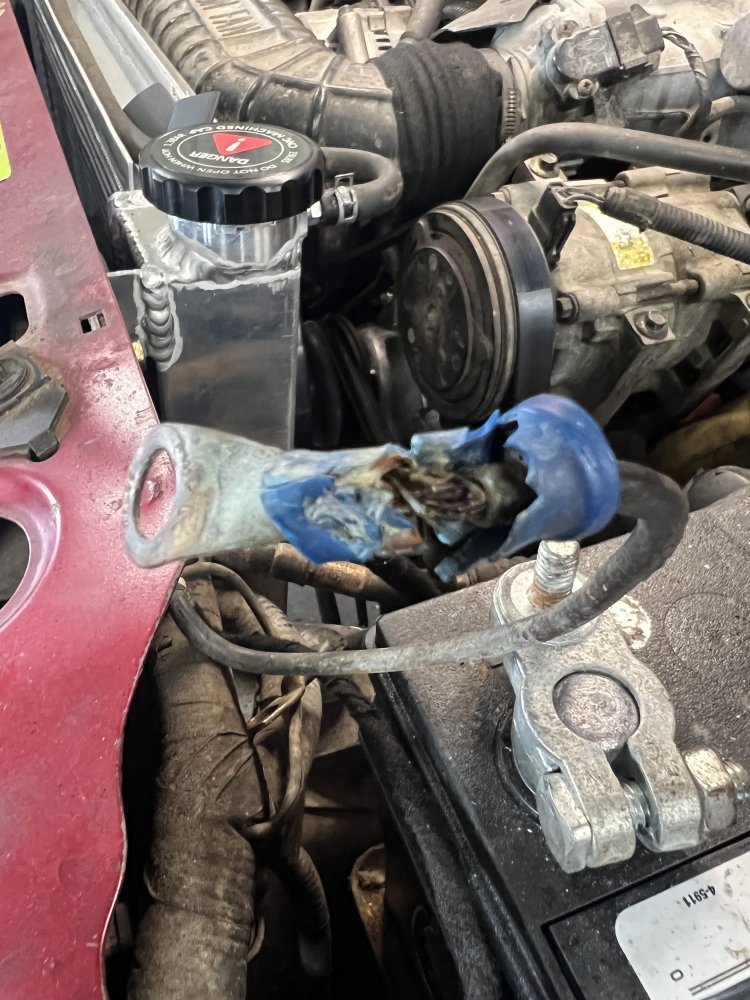

After the AC attempt I realized a bunch of stuff wasn’t hooked up on the motor because it would only run for a minute or two before shutting off. Found the Crank vent line missing so I capped the nipple on the intake tube, and ran the crank hose to a catch can I had lying around. Also replaced the broken ECT sensor that sends to the ECU which was likely one of the reasons it idled terrible.
Then I began to tackle wiring in the electric fan. I got everything wired but for some reason could not get it to turn on using the single wire sensor they sent with it. So I ordered a two wire sensor and bung so I can weld it into the radiator. Really had no way to install the single wire sensor anyway, I was testing it with a small torch heating the sensor. Also installed the new filler neck and dumped 5 gallons of fresh fuel in it!

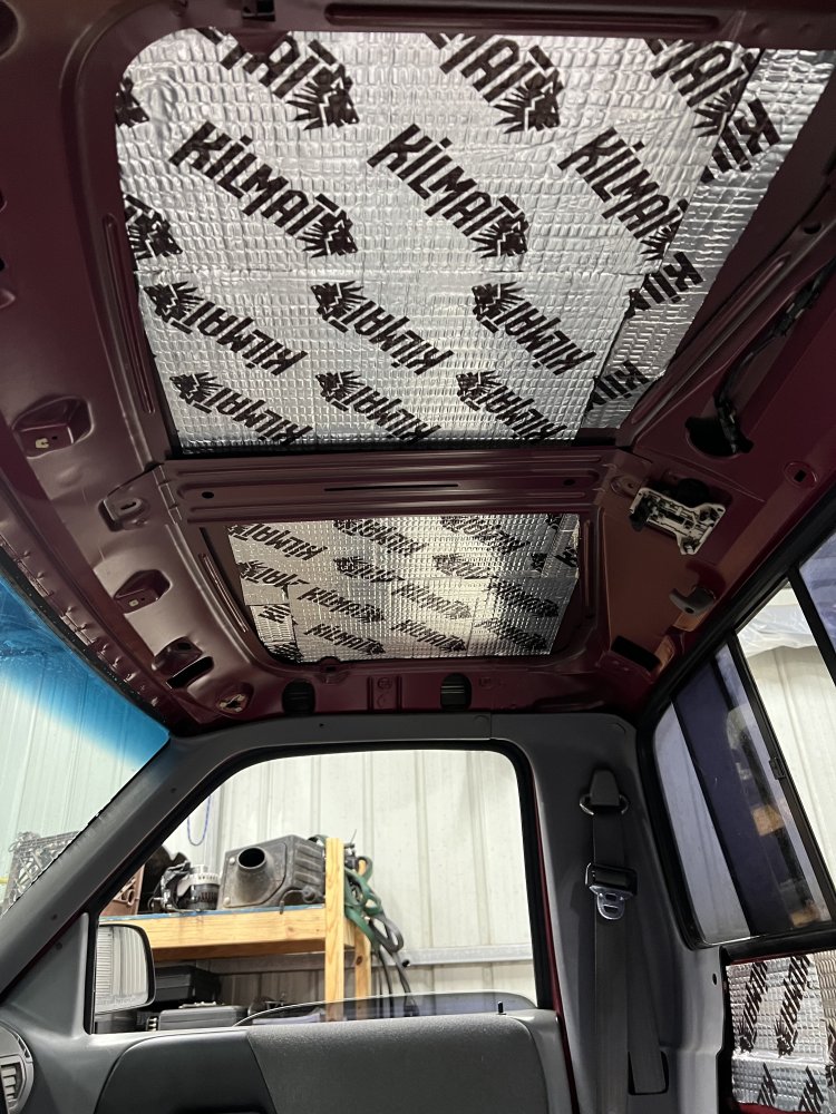

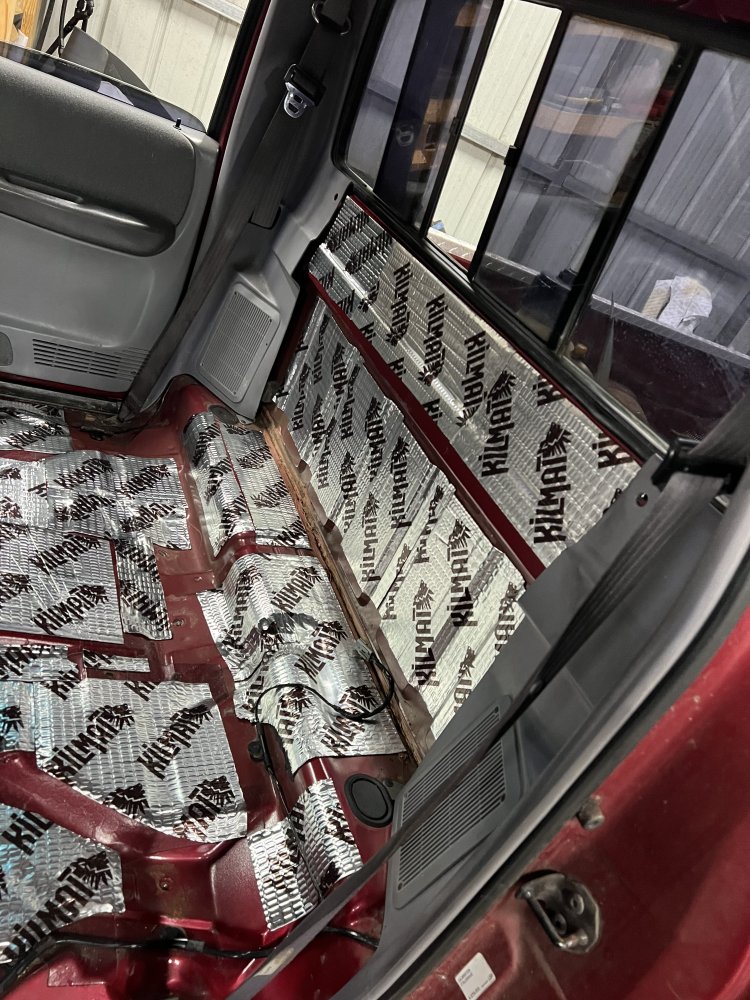

Next on the list is to finish pulling the interior apart, wipe everything down with a rag and vinegar to get out the stink. Then dynamatt (ok I’m a cheap phuck it’s a knock off dynamatt) the entire cab, walls, doors, and roof. Probably gonna trash the disgusting head liner and live without one. Not sure I can stomach the thought of putting those seats back in so I need to start looking for some Edie Bauers.

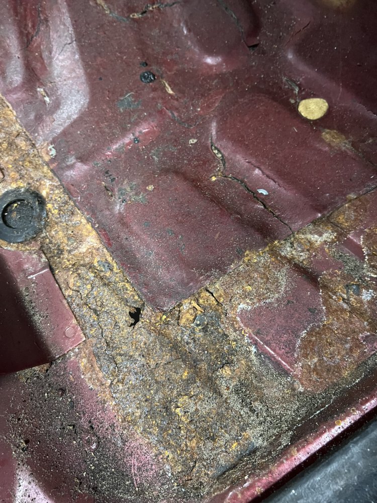

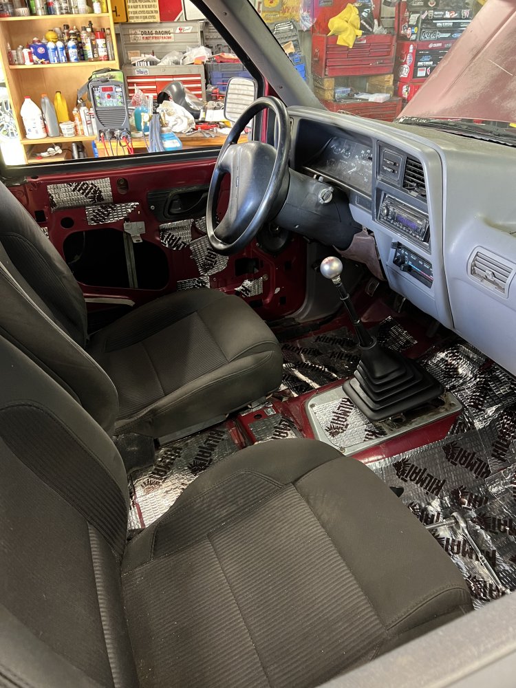

Removed just about everything else and gave it all a good vinegar scrubbing. Laid down the majority of the sound deadened as well. So far I’m pretty pleased with the progress but can’t wait to have a day off to really get stuff done. Also had the new oil pressure sensor and window crank get delayed because the amazon truck got stuck down a dirt road next to my house, that has no reason for them to be on. There’s a perfectly good paved road to use.
I did find a tad bit of floorboard rust in the passenger side so I have a feeling the windshield that’s broken leaks.

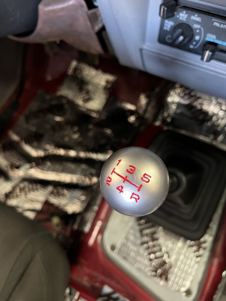

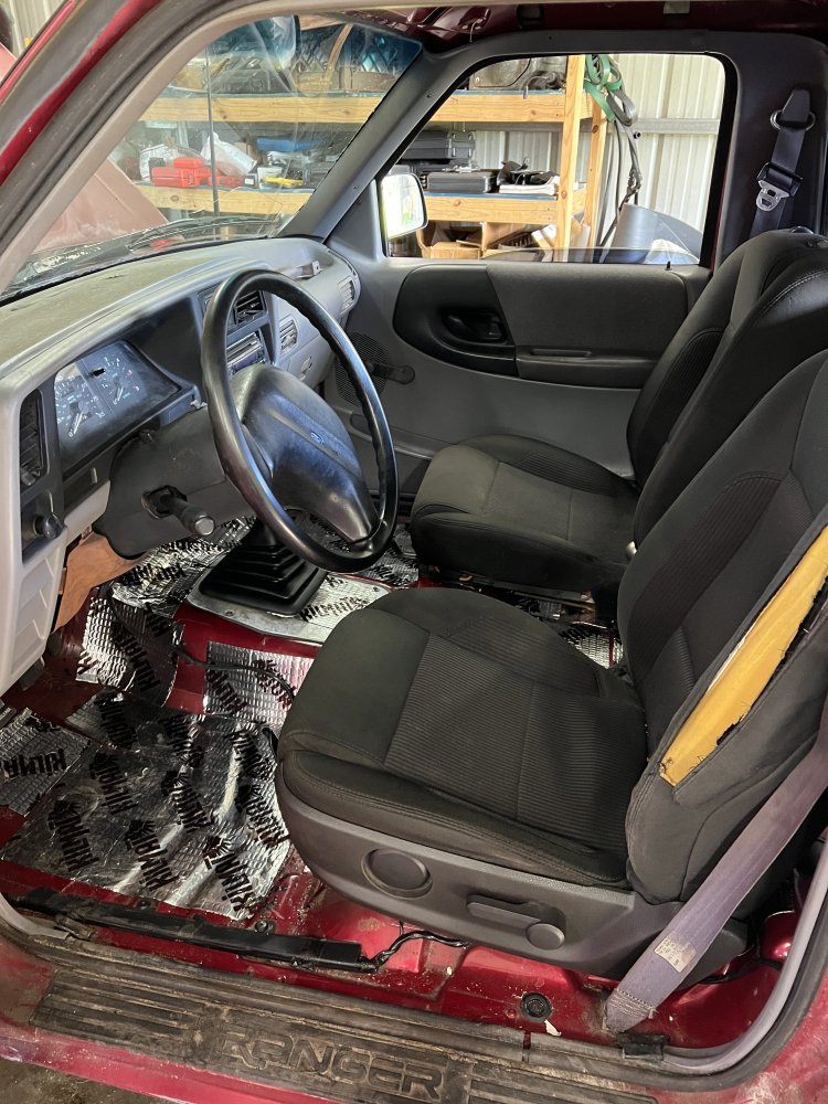

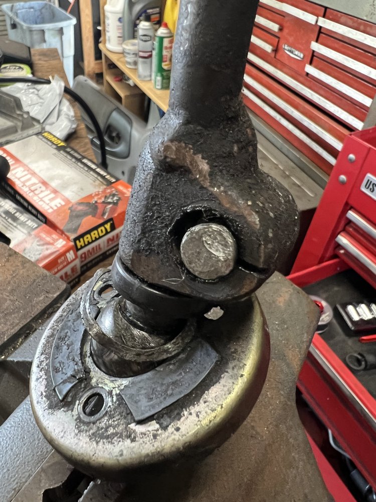

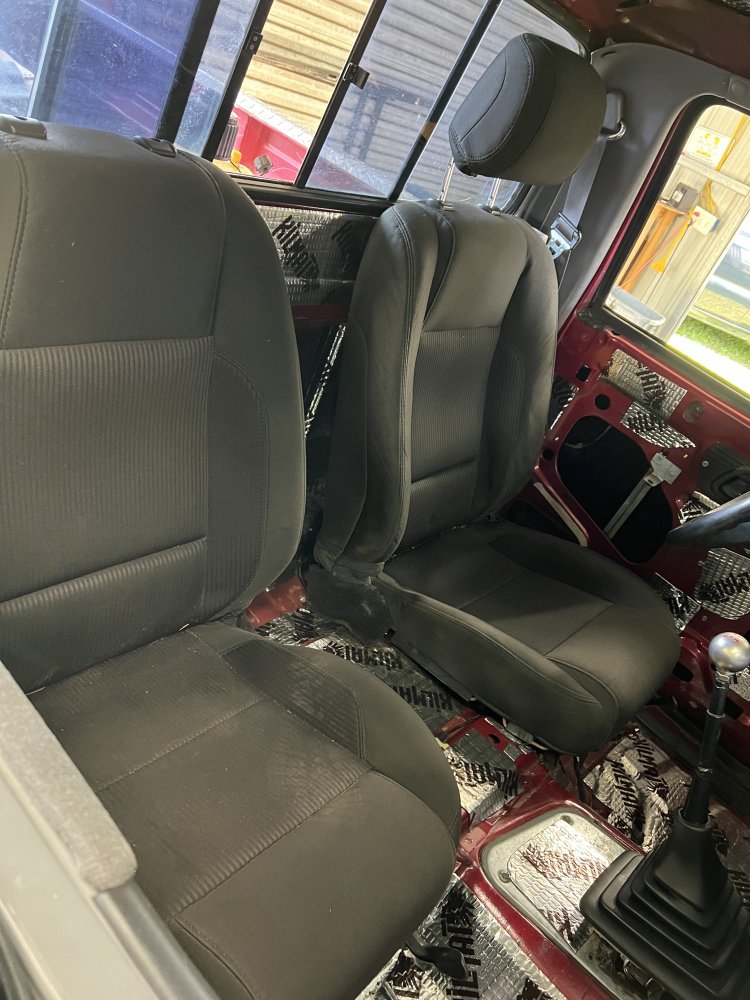

Got the shifter rebuilt, also cut the splines off the top, and welded a bolt to match the $11 aluminum shift ball I bought. Figured it was cheaper than the $25 OEM replacement that has mixed reviews.
Also got a set of 2011 Mustang seats bolted in using the original seat sliders and drilling a few holes to align them correctly. They are manual seats and fairly comfy, buddy wrecked this car a year or so ago which is why the airbag side is blown out. Gonna have a family member stitch that up the best they can this weekend, and I have the other headrest somewhere.
I feel like the 5 hours I spent in the heat box tin can garage I have would have yielded more progress. Tomorrow I’m going to swap fuel filters, look into the PS leak which I’m pretty sure is just a lines not hooked up. Look into the oil pressure sensor not reading, check on the exhaust flange I’m waiting on to be laser cut, and depending on what other parts show up I’ll try to knock those out.
I think the rust spot in the passenger floor has me irritated enough to go cut one out and weld it in whenever I end up at the JY next.

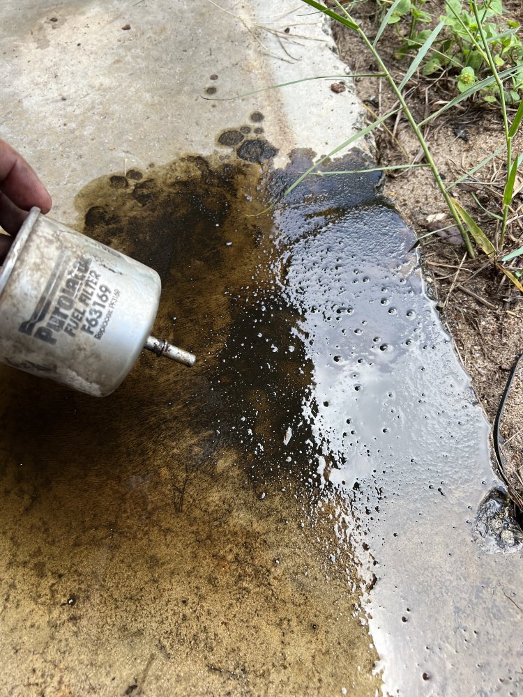

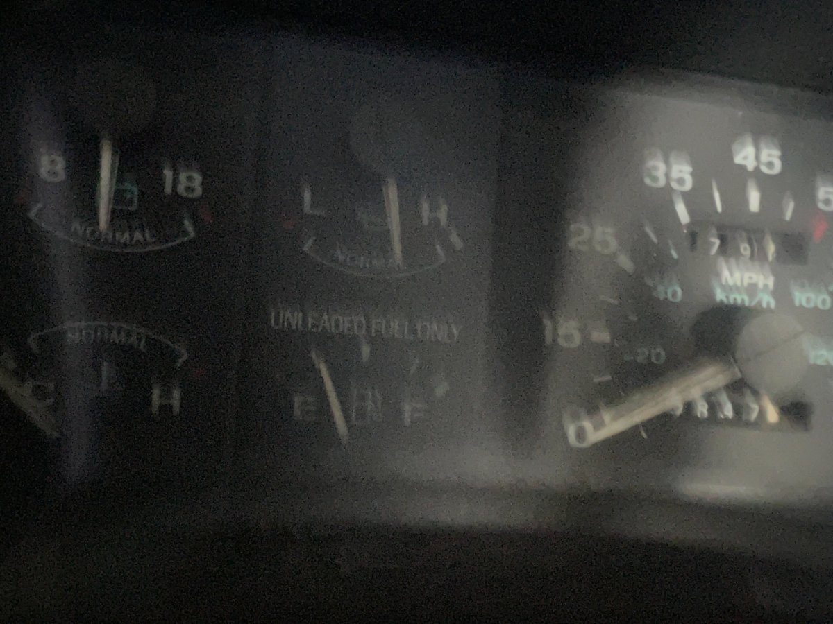

Cleaned up some awful wiring today, fixed the OP sensor by plugging it in, fixed the PS by attaching the line, and changed the fuel filter. Super pumped that it makes good OP, PS works and doesn’t whine, and the tranny is shifting much better.

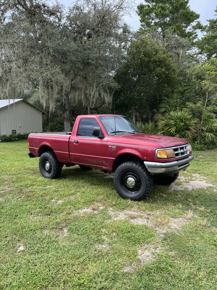

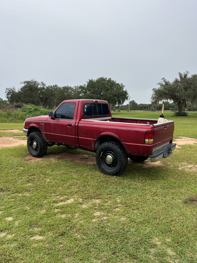

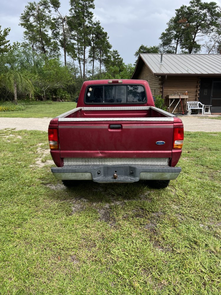

New tail lights, and another trip around the block from shop to house. Also put 12gallons of fresh fuel in it finally. The body lift is actually growing in me in every way except the rear bumper area. I have some pieces of 4x4” square tube that I may be able to fab up a high clearance bumper with hitch built in. That will also eliminate the ugly diamond plate tailgate/bumper gap cover. Need to get under the rear and hack out the spare tire mount and rear bumper to start eying that bumper build process. Same goes for that dumb frame support in the front someone half ripped out on this truck.

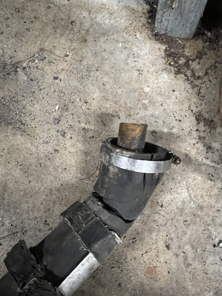

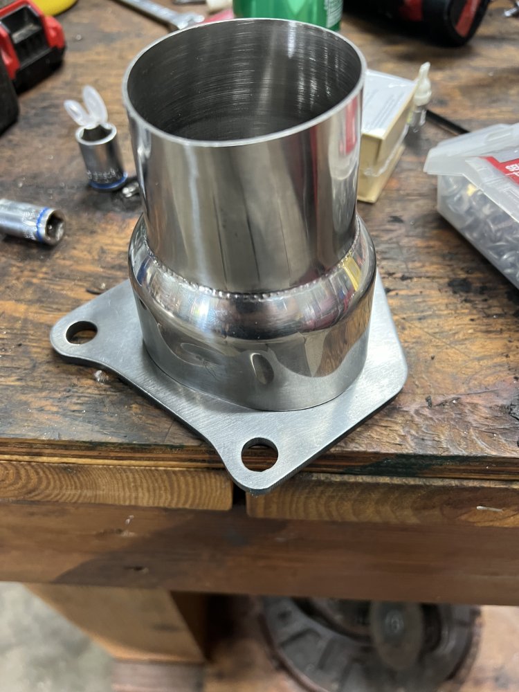

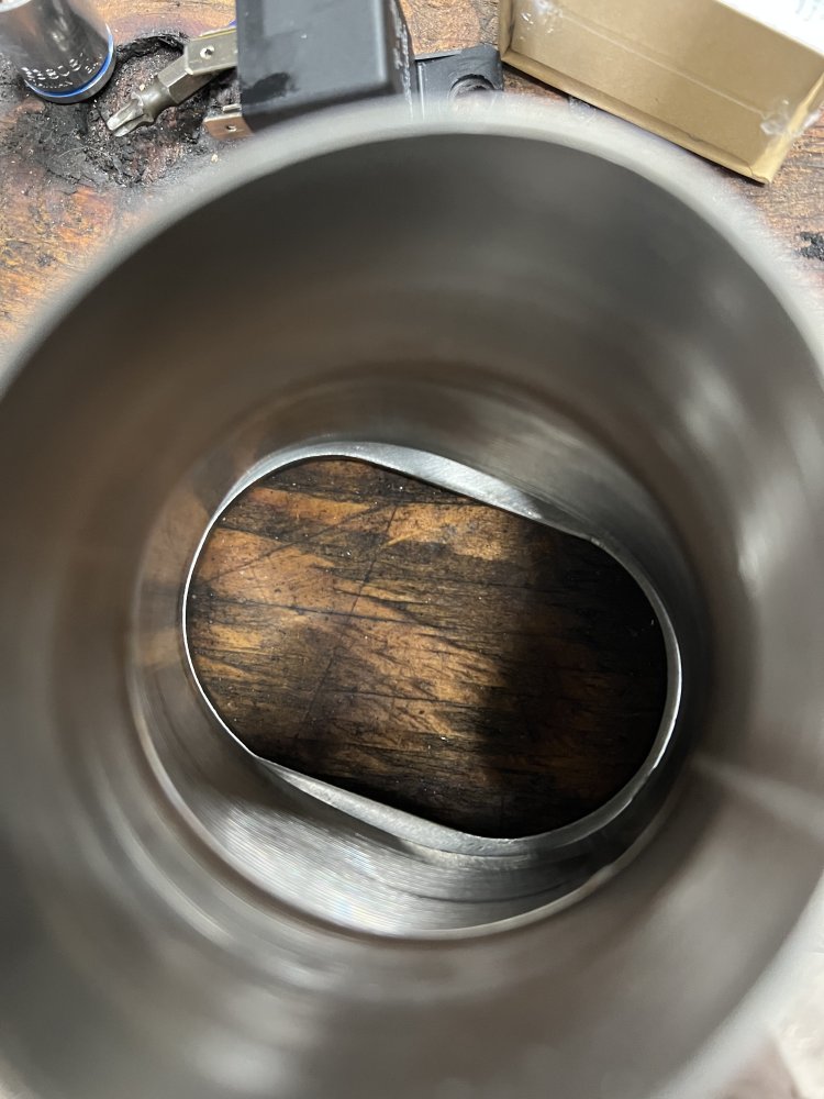

Got the exhaust flange today and welded it up. Tried mocking up the GT Mustang mufflers and there’s no way they will fit. So I ordered some amazon straight through resonator and a walker quiet muffler for $75.

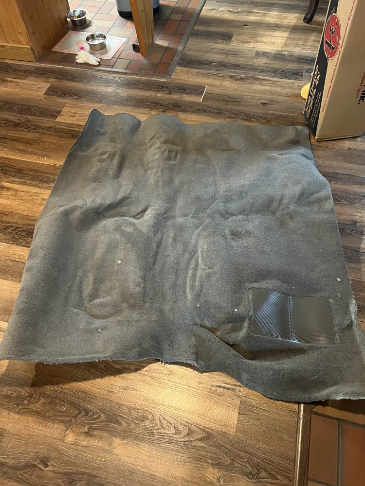

New carpet came in as did the headlights and turn signals. Haven’t put the carpet in yet but the ugly water filled and cracked headlights are finally gone.
Going to TIG a bung into the radiator for the fan coolant temp sensor tomorrow. Then Thursday a windshield guy is coming to replace that, and I’ll likely finish up the interior, reinstall the cooling system, and fab an exhaust with plans to hopefully register it the following week. Waiting on the previous owner (my neighbor) to locate the title.

Got one of the two mufflers on today, as well as wiring the Efan for a function test. The sensor is a 190*on/175*off and it took nearly a half hour to kick on, the big radiator kicks butt. Windshield guy is coming tomorrow, and then I need to look into the door handle not working again. I replaced the handle but realized the door look bar is not attached to anything. Gonna have to pull the other panel off to see how it’s supposed to go.
